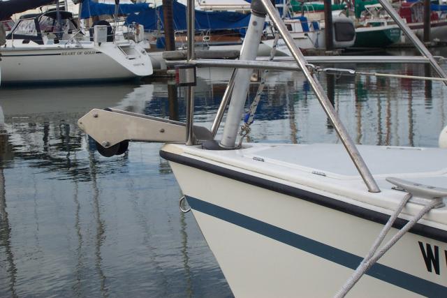

BTW, do you have a windlass and/or a bow roller installed on Codger? I’m just recovering from shoulder surgery and I think a roller/windlass will have to be my next project so I can continue to cruise and anchor out.
