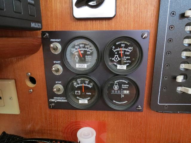

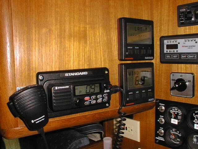

Dan-
My Westerbeke panel fits to the left of the power panel at the nav station. There is a wire run alongside of the stbd rail that is open in the stbd lazarette and runs to the area behind the power panel.
You can follow the existing wires for the route.
Pix below-

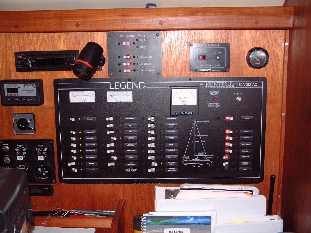

Also, Dan, if you have an air conditioning panel, you will need a 4-pole center off break-before-make ship-shore power switch. This will allow you to switch the two AC input circuits to the single generator output so that you can power everything at once from the generator. I have the wiring circuit if you want it.
I located the ship-shore switch just above the generator panel.
When you price the ship-shore switch, I advise having a couple stiff drinks and being seated when you learn the price.

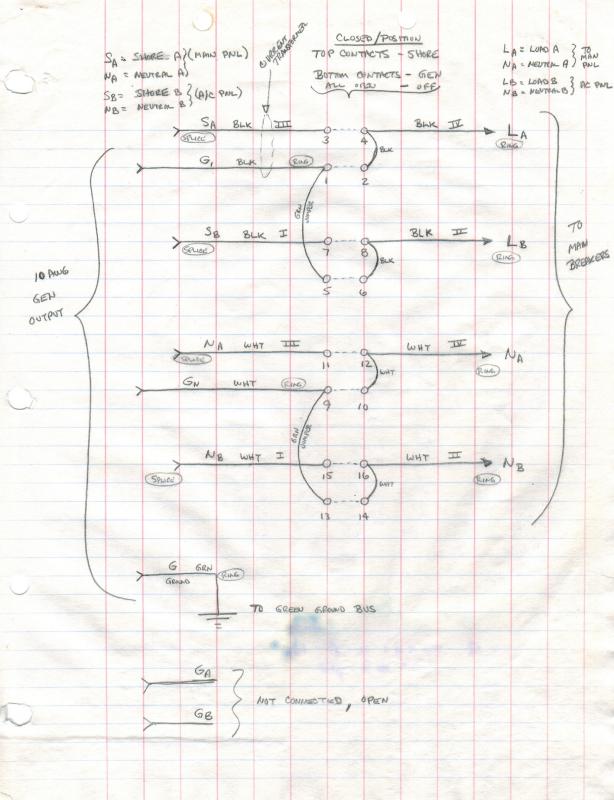

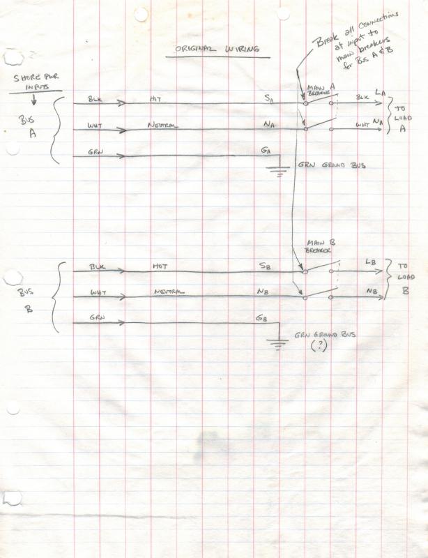

Feb 10, 2004
4,233
Hunter 40.5 Warwick, RI
I would be interested in your wiring diagram and the price of the ship shore switch.
Thanks in advance,
Andrew
Here you go Andrew. It will take a bit of studying, but I think these wiring drawings can be followed. One drawing is of the original wiring from the two shore power connectors to the main AC distribution and to the air conditioning panel. The second shows the Ship-Off-Shore switch and the wiring from the genset to the main and air cond panel. The Shore position switches the incoming connectors to the original loads and the Ship position feeds the generator output to both the main and air cond panels at the same time.
I may have to find the switch information in order to know which contacts close in each position. That information may not be easy to find. Let me know if it you must have it.
My ship-shore switch was about $300 in 1998. I forget who the manufacturer was.
