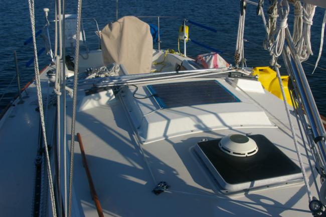

This 20 watter sits nicely
on the companionway hatch cover. Flexible, not supposed to step on but not bad if you do. Has worked very well (so far) 2 seasons. Does a great job maintaining 2 each group 27 Lifeline AGM's. And yes, regulated.

Ed- Here is what I did on my H37c
All of the pannels are flex/thin film. Not real efficent but I do not live aboard and so the House (4 group 27s) and Start banks (1 group 27) are always topped off. Last week spent 3 days with an other couple and we had anchor lights, 3 fans, inverter (350 Watt) and CPAP machine running all night. During the day the pannels caught back up with the draw (we were on the hook and not using the motor). Very happy with set-up and did not cost any deck space.
