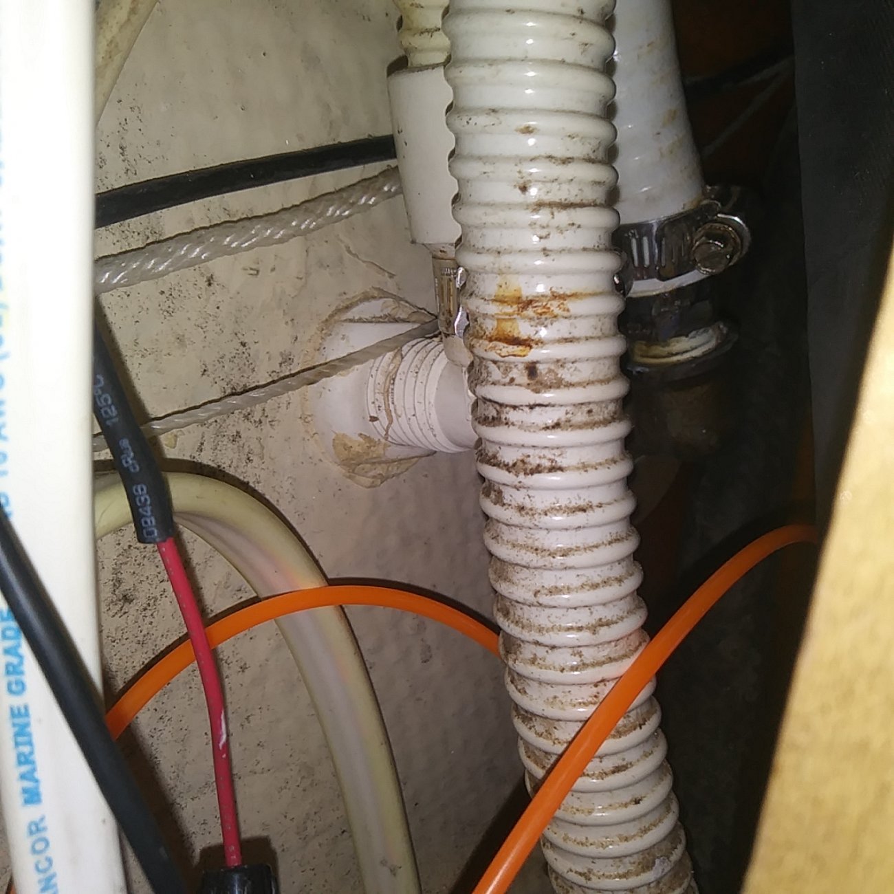

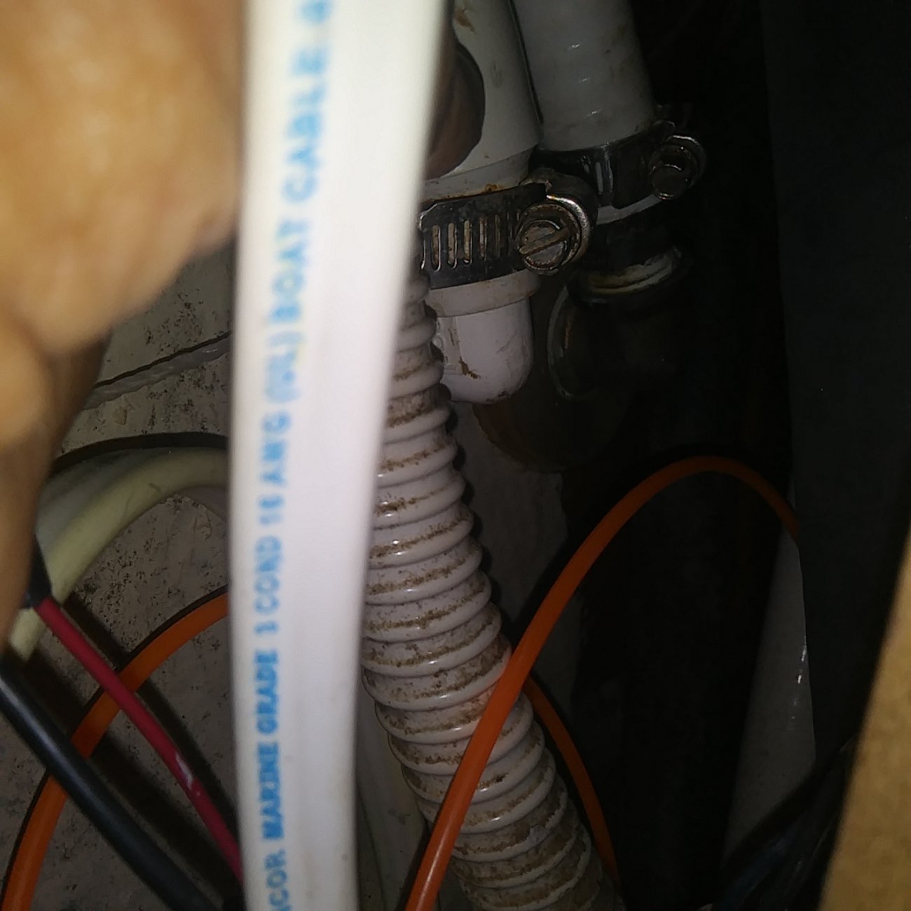

I want to install a new 1" waste tank vent with a mushroom fitting per Peggy's recommendation. The old fitting has a clamshell with a screen and is only 5/8 inch id.
Per the attached picture you can see that the clamshell vent fitting inside the boat (the metal one to the rear) apparently screws onto the thruhull above the waterline. I'm considering just plugging that line and installing a new mushroom fitting in the area between the white thruhull (for the shower drain) and the electrical panel (just forward of the shower drain thruhull. I plan on using 1" Shields White Sanitation VAC Heavy Duty Hose. Anybody see a problem with that?

Its very tight and very hard to get to the area behind the clamshell vent to get it off and consequently very hard to get into there to tighten the mushroom thruhull, screw on a 90 degree low profile adapter to a barb fitting, get a hose on it and thetefor hard to make sure there are no leaks. The proposed location has good access to make sure everything is tight and to inspect for leaks. All the holes in the hull are way above the waterline. I'd still have to enlarge the existing hole if I used the same location.

The problem is access to the existing fitting to get it out, enlarge the hole then reattach the new hose.
Peggy, the existing hoses were replaced about 5 years ago with Trident Sanitation hoses when I put in a new poly tank. The vent hose was only 5/8 inch with a Clamshell fitting with a screen. I just want to go to a 1" VENT hose.
The corrugated hose is the pump out line for the aft shower sump.
