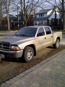

I tow and launch my 26D with a 03 Dodge Caravan and a 04 Dodge Dakota 2wd V8 5 speed manual. No problems. Not to sure I would go over 200 km with the van but I'm confident the truck will do it no problem.
