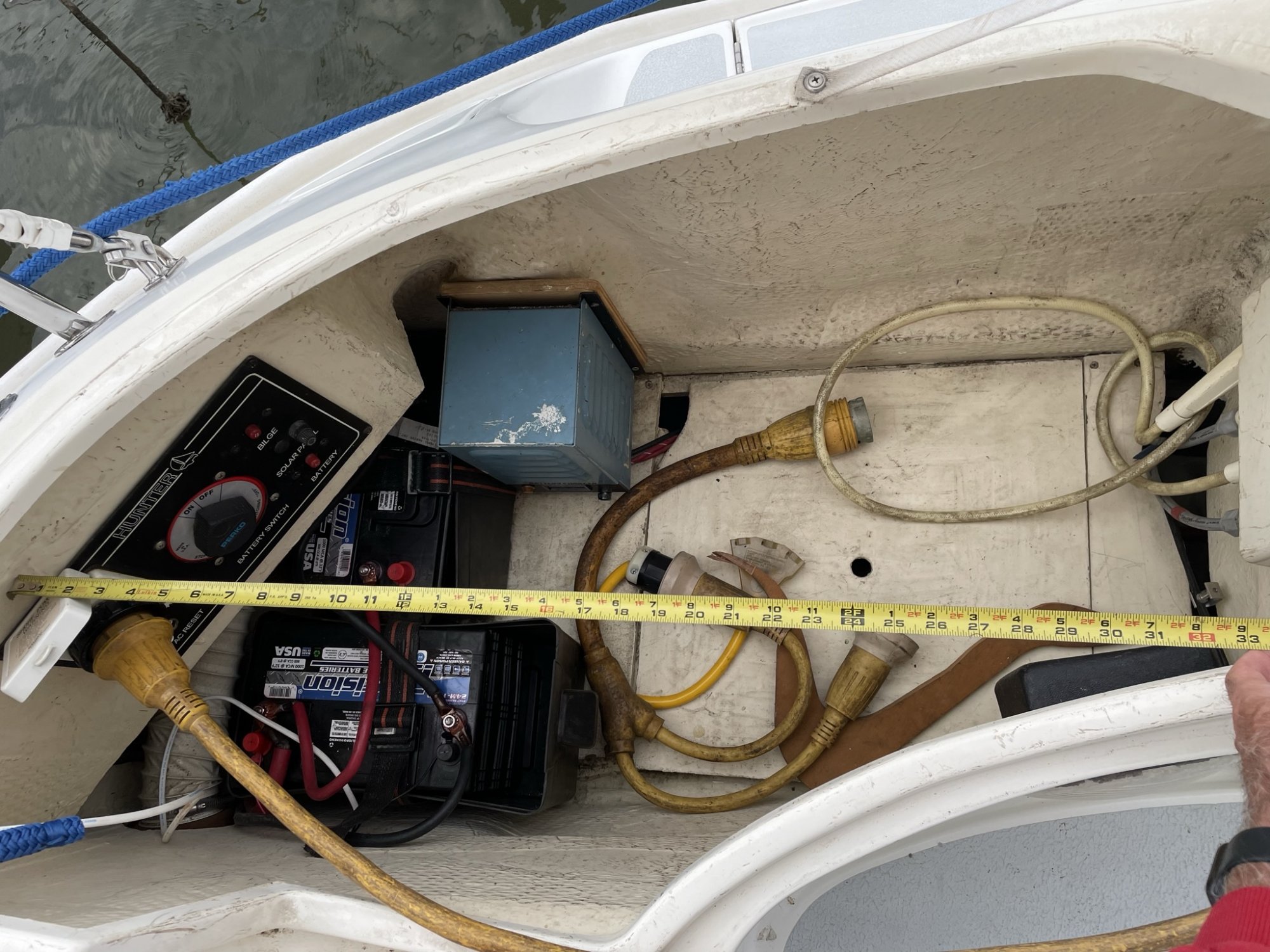

Since our successful upgrade of MFD instruments, auto pilot, LPG stove, LED lights, water heater, heads, faucets, windlass, anchor and chain we are now trying to focus on next seasons upgrades. Our boat is presently equipped with a two lead acid house bank (with original charger) and a starter battery. It is really inadequate even for a long weekend of sailing. I have gotten quotes from two different companies for components, but still a lot of questions to answer before we start. On the 40.5 or other Legend series boats, where have people placed most of the components? The starboard lazarette houses the charger and batteries now and would possibly be a good place for a new inverter/charger and PV charge controller(s). Ideas? Planning on four 100Ah batteries...

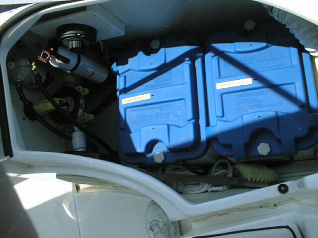

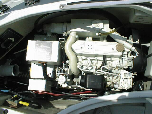

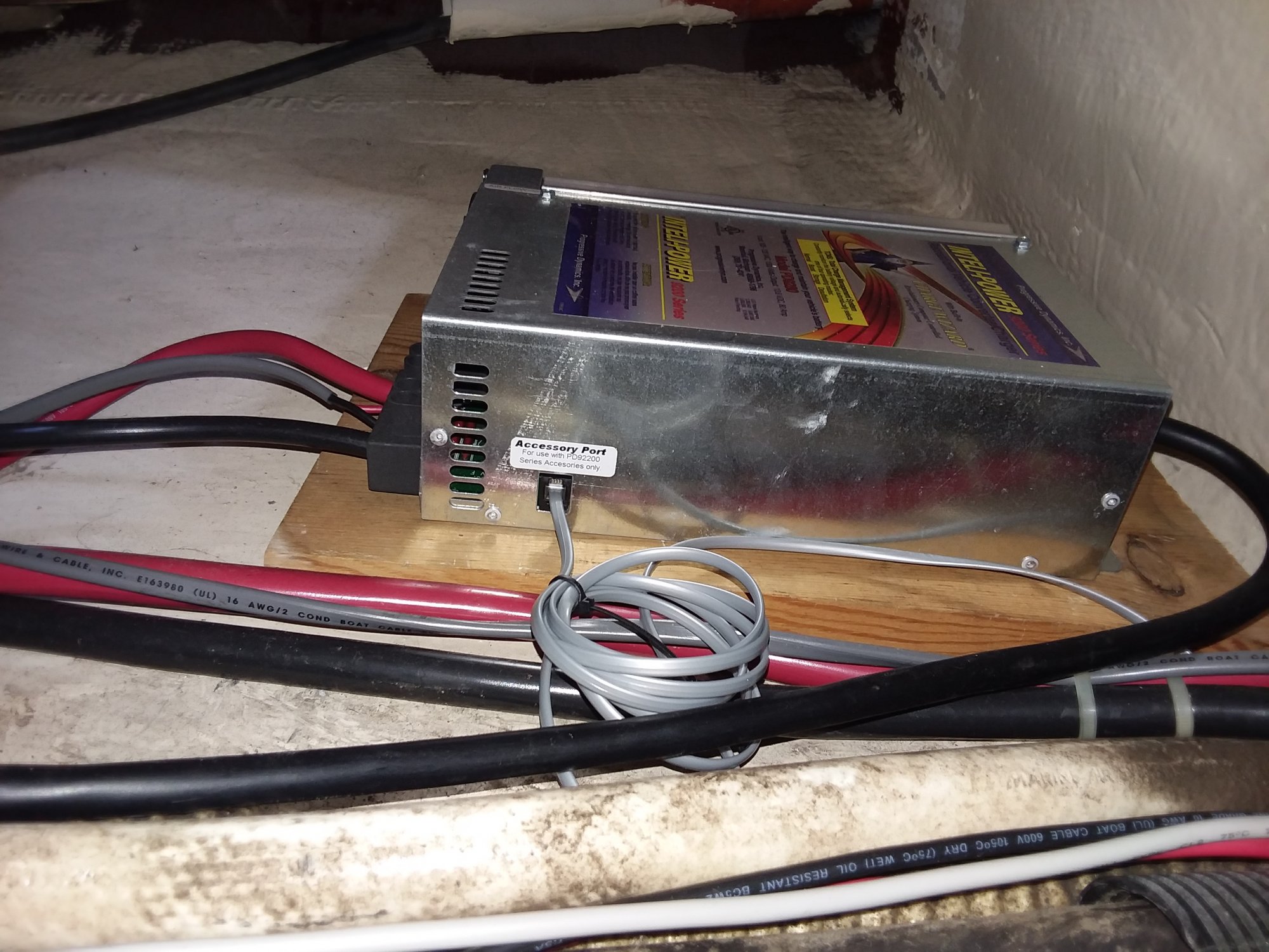

I have four 6-volt FLA batteries in the port lazarette and a 5KW Westerbeke generator in the starboard lazarette. Never had any water in either lazarette. I moved the OEM charger to the wall next to the rudder shaft behind the removable panel. That was a poor choice because the caulking of the wires leading from the console under the cockpit floor aft of the steering console failed and let water into that area. The charger did not appreciate the shower. I now have a new charger mounted to a board underneath the aft cabin berth.

Thanks for the input from everyone. Rich and Baycloud are always helpful, thanks again. On the hard for now. Time to plan. Thinking of keeping the appropriately housed batteries in the lazarette and the electronics inside the boat. My boat does not have the built in shelves (by the foot of the berth) so I could add a cabinet and storage area in the unused space. Would also like to add a headboard.

Tkx. I installed the genset before the boat ever got splashed by the dealer. The floor was reinforced by a Hunter rep prior to installation. My dealer didn't think it would fit but was fine with my trying. I was pretty sure it would fit, but I was prepared to remove the exhaust manifold if required. It wasn't, and a straight in with a slight tip was all that was needed. I told the dealer that I didn't need that 5# bucket of lard to grease the passage after all!

btw, my charger inverter was in the aft cabin under the berth above the strut bolts., I fastened it onto the lateral wood panel. Very strong. I think that an airco unit would normally have been there.
