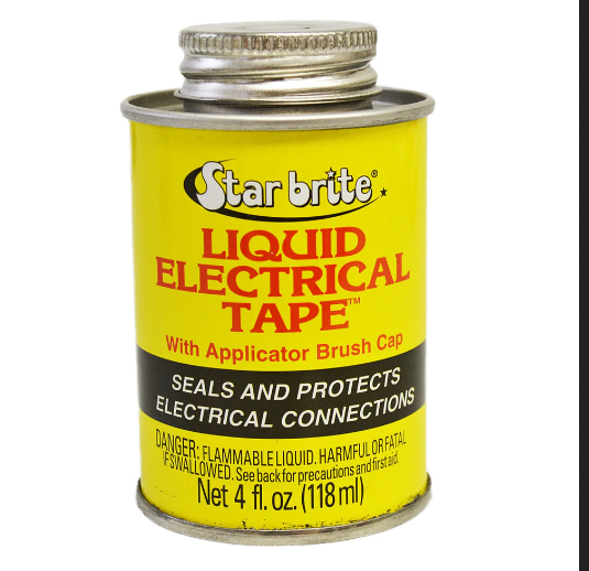

The liquid electrical tape is probably what it was. Not sure I like that idea but the Boesield T-9 sounds like a good idea. I have some of that at home but hadn't thought about that. I do have a light coating of dielectric grease on it.

Liquid electric tape would be a nightmare. You couldn't see anything under it and it wouldn't facilitate electrical connections. We use Corrosion Block on all connections. It does a fine job.
Mar 26, 2011
3,840
Corsair F-24 MK I Deale, MD
This^^
And when the rubber coating fails, it will make corrosion under it worse.

I was asking about the Liquid Electrical Tape because that is what I found on one busbar and I was surprised to see it. I guess the PO must have used it.
