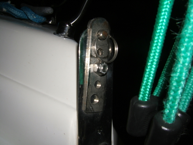

My 1995 Hunter 26 has a OEM installed CDI Flexible Furler FF2.
The Link Tang Plate at the bow to which the FF2 attaches extends up above the deck in order to provide proper clearance for the furler drum. The upper connection hole is worn and I need to obtain a replacement Link Tang Plate.
See picture attached. Does anyone know where I can buy a new one?

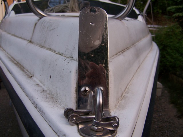

I got two pieces of stainless and drilled two holes, the top hole for the furler and the bottom hole to attach the two pieces to the tang. These pieces already had holes in them but not in the right places.
