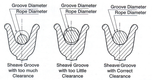

The wire/rope halyards are a way of dealing with old rope technology. The wire stopped the rope from stretching when you hauled the sail up by rope only and the stretch let it fall down a bit. The wire line is heavy. The new lines are light weight and they do not stretch like the old lines did. I switched to all line and dumped the wire/ ropes. Love the results. Such a switch has its issues. Specifically the sheave at the top of the mast. Your wire/rope sheave my have a groove in the center of the sheave for the wire (or may have worn a groove). You need to consider the size of the line. If you find the sheaves need replacement, then you want to get a sheave that is not grooved for wire. Here is a graphic that helps identify the selection of sheave/rope size.

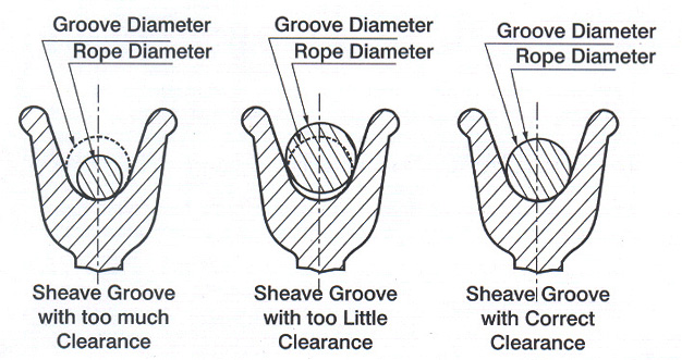

You have two options. If you have a line that fits the sheaves and the sheaves look to be in good shape (not cracked, spin smoothly etc.) then you can purchase line of the proper size. Some sheaves come with a narrow groove (for the wire) and a wide groove (for the rope). You can use the correct size rope on this sheave with no problem as long as the rope fits the width of the larger groove and the small groove is less than 20% of the line diameter. Sometimes the wire grove gets worn and the rope starts to fit inside of it. This is a menu for a fouled line. Then you must change the sheave if your want a smooth running halyard line.
