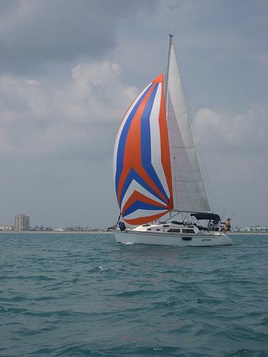

a sailboat never looks better than when she's flying a colorful kite. Makes the stinkpots jealous that a boat doing 6 knots can garner so much more attention than their twin outboards! For me, it just harkens back to the days of brave sailors as men among men! Saltygator, looking good... cup

Thanks for all the responses...
Yes it is traditional 3/4 oz and I doubt I would ever consider it in over 15 true. In the pic above it was about 5 true and the boat took off like a shot when the sail filled (check the bow wake). And I haven't even begun to understand trimming it. Patrick, putting this together went just like advertised. Really quite simple and they really do send you everthing you need to do it except the sewing machine and needles. Order the video first and see how easy it is!
