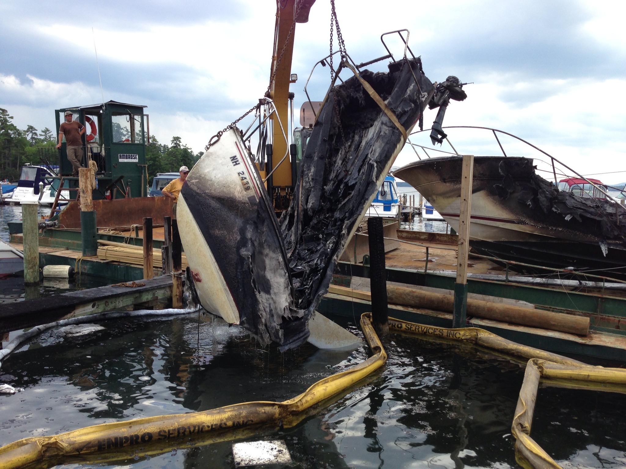

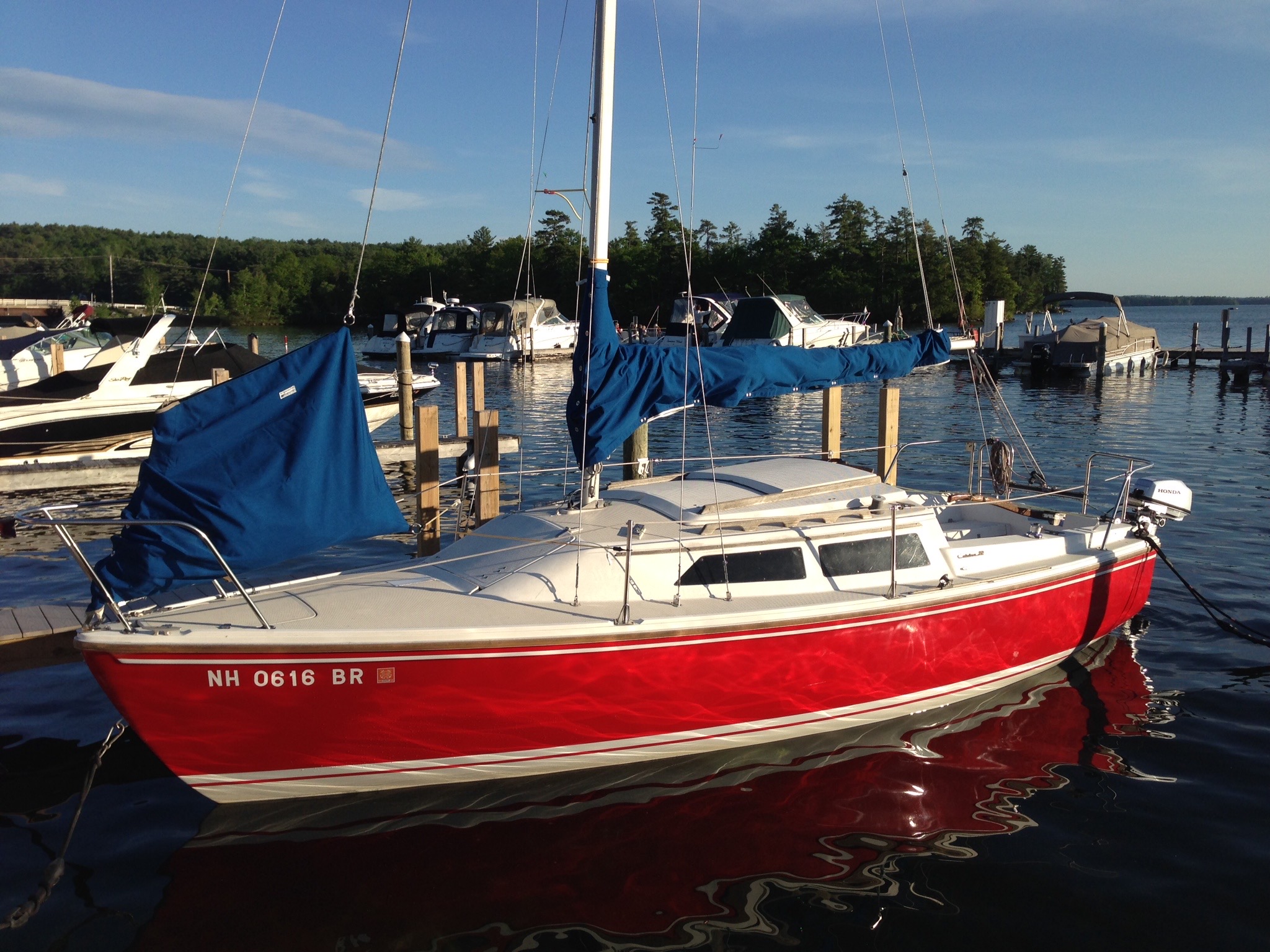

I too had my '22 struck by lightning, at 2 AM in the morning, but I lost much more than electronics. See the included picture. The boat burned to the waterline and sank. The powerboat in the next slip was also destroyed. Luckily those were the only two boats destroyed. But my wife and I rebounded quickly and had another Catalina 22 within 3 weeks, that picture is also included.

Yes - Insurance covered everything. Also learned how important it was to have coverage for the environmental clean up aspects which ran into a lot of money since they had to bring in a barge, divers etc... even the EPA was onsite to ensure any contamination was contained.

Man. Nothing left but the pulpits and the keel. My wife would have been cryiiiing ... I probably would have been crying! That's a "new design" boat, too, kinda hits closer to home!
On an unrelated note, @Eagle22, does that jib bag allow breeze to get past it and into the forward hatch?? I might have to get one of those. We are always amazed at how completely our jib blocks the breeze when tied to the lifeline at night.

I pull the bag to one side when sleeping on board so the airflow isn't blocked. I also use screen in the entry way so that keeps a nice airflow as well.

The clean up cost around $10,000 - all covered by my insurance. It was a wake up call for the marina which then required proof of insurance from all boat owners including environmental cleanup coverage.

Well on the good note it looks like your outboard survived except for immersion damage eh?

Simply amazing photo-- but all the horrific fire damage aside, that bloody keel is still attached!
