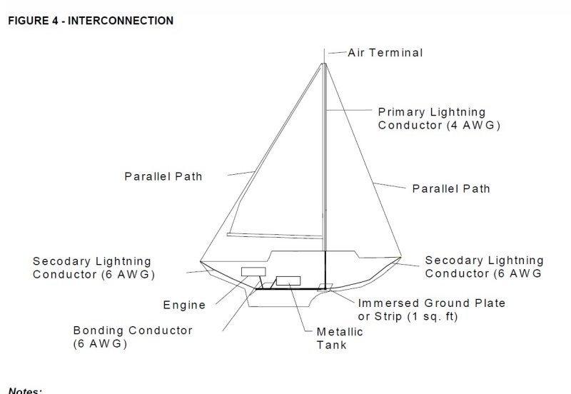

However, figuring it the other way
dV/dt = L * dI/dt ---> dI/dt = (1/L) dV/dt
Given a lightning strike current (dI/dt) if you increase the inductance you would have to also increase dV/dt. So you get a high voltage change at the point where the inductance increased. That is what I'm looking for, a high change in voltage through the inductor keeping the high voltages out of the salon and up on the mast and rigging where my low impedance path to the surface takes care of it.
So the high dV/dt at the mast base keeps the bottom of the mast at "lightning potential" while the mast support in the salon has a much lower potential. Basically the coil's magnetic field chokes off the current causing a charge pile up at the mast base and a high voltage there.
Thoughts?

In my thinking of lightning I'm making the following simplifications to the situation:
a) The lightning current in air is acting like a long straight wire with no insulation. In/on the boat all bets are off
Ok.
b) My boat is attached to what amounts to an infinite capacitor
Not grounded, right? Why infinite C? The capacitance depends on the width and material of the dielectric.
c) The induced static electrical charge is a very thin (<<1 ft) sheet at the water surface.
Ok, there is a concentration of charge that does not run deep.
The E field for a lightning bolt looks like horizontal lines of equal potential.
It would be equipotential planes, but not for the bolt, for the clouds that spawned the bolt. The field for the bolt/wire has not been defined by any poster yet.
The H field looks like sets of concentric circles centered on the lightning bolt. Which would be in this case horizontal circles since the lightning bolt is vertical.
Ok.
Since my boat is in the initial E-field it has a masthead that is at some "more positive" potential, the waterline is at the "most negative" potential and the keel is at some "more positive than the water surface but less than the masthead" potential. No current flows though because the whole boat and water surrounding it are in the same back to back E field.
When the current begins to flow it is primarily in the vertical direction. I want to encourage that and try and discourage horizontal currents (side flashes).
Anybody disagree with me yet?
Yes, I'm going to disagree. You are using the water surface as a field generating charge surface, but then you talk about the potential within this 'black box' charge source. That's not correct. The field near the boat (top and bottom) is more complicated than you are describing, I believe.
By the way - you are using the wrong inductor equation.
