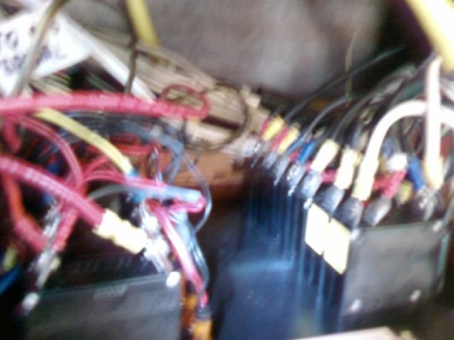

My boat got hit in its slip and cost the insurance company over 4k. This is what it did to my battery charger located in the engine compartment of my old Irwin. All ohter electronics were toast and allthrough hulls had to be replaced.
