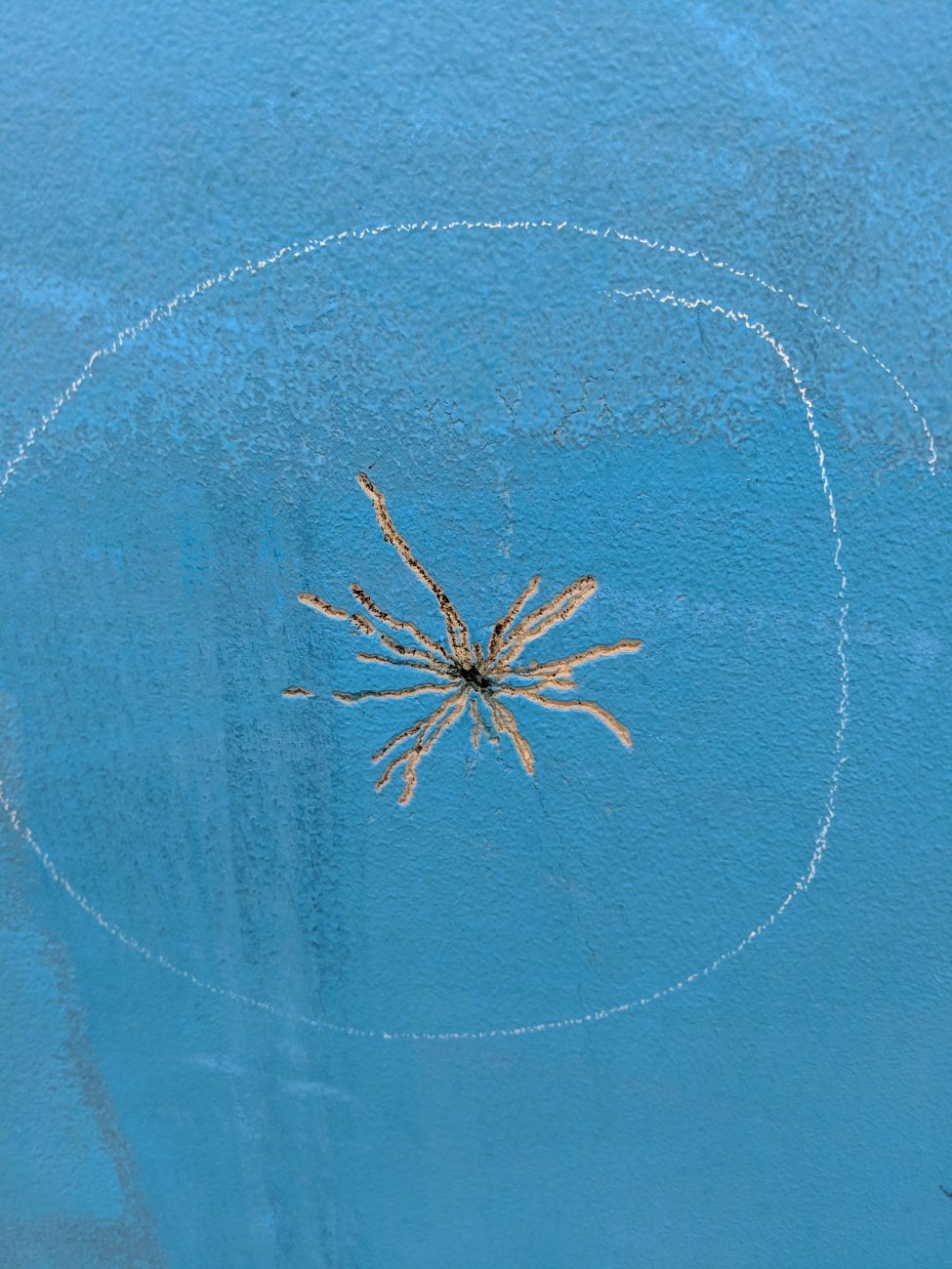

Lightning struck a boat about 100 feet from ours last summer. Witnesses said there were sparks from their masthead. That boat ended up with about 75 starburst style burn marks on the hull -
It fried the networking circuitry in our chartplotter and VHF. They would still turn on but wouldn't work over NMEA. Also fried out stereo. Other boats around also lost things like radars and bow thrusters. After our three affected devices were replaced we haven't had any other random residual failures, knock on wood.
24,511

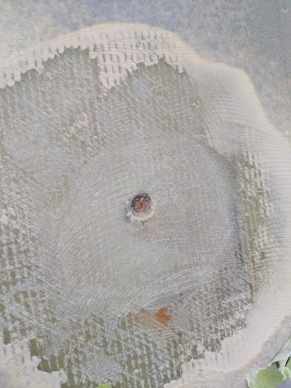

The Starbursts were on the direct hit boat, not ours, so I'm not sure about the integrity of the hull before the event. It was an older model (70's or early 80's) so it's possible there was extra moisture in some spots. I didn't notice any blisters after it was hauled, but I was mostly looking at the burns and not the rest of the area. They were scattered pretty much everywhere - hull, keel, rudder, and all thru hulls.
How did the marks get repaired? Any fiberglass damage?
Sure was. They took all the bottom paint off to start, then ground the burn marks down -

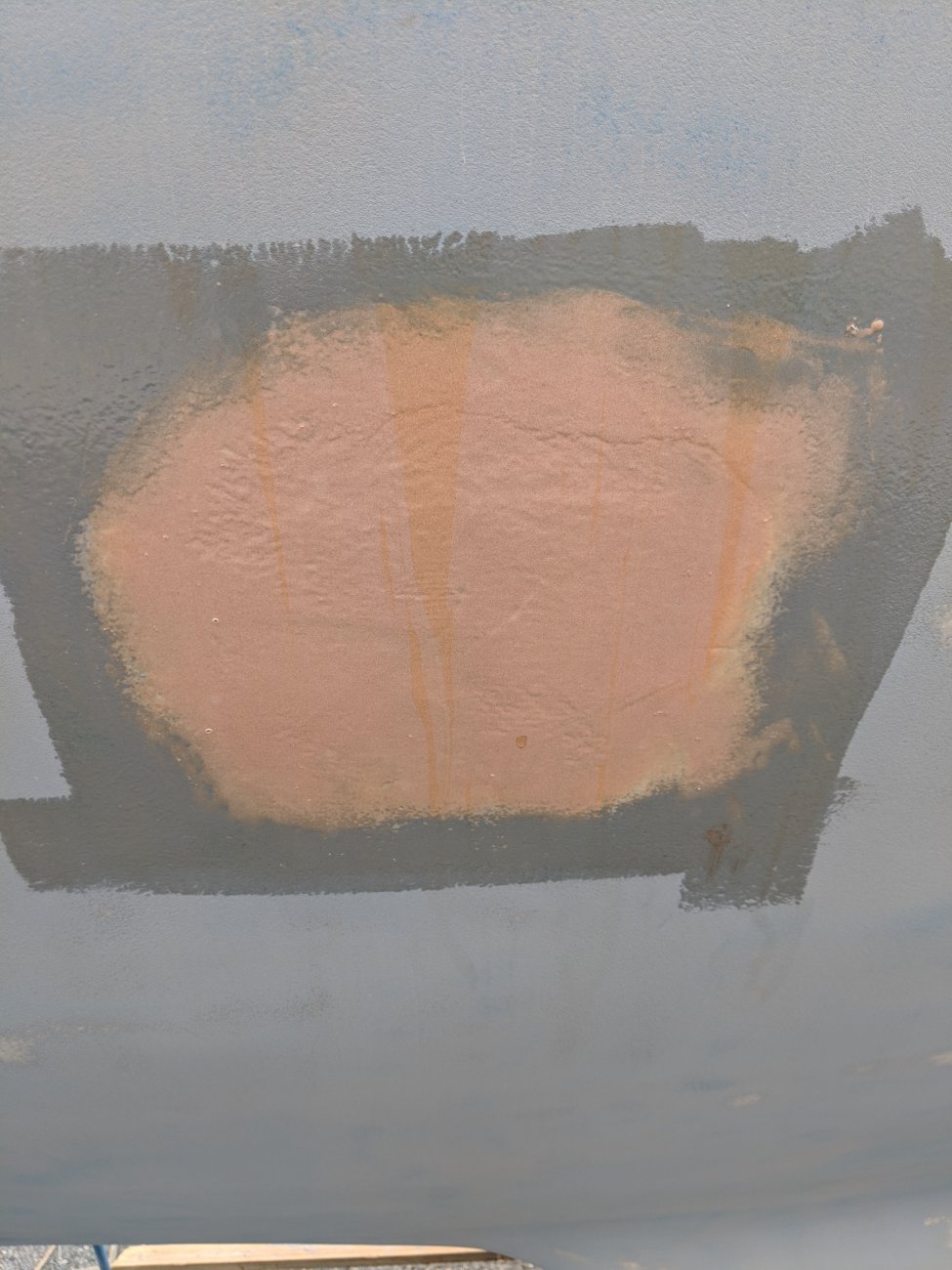

Then built it back up with what looks like fairing compound. Not sure if they added more glass underneath -

I would hope they used epoxy and fiberglass in the hole to provide strength. Fairing compound filled holes would bother me.
+ 10000 (or more)....
