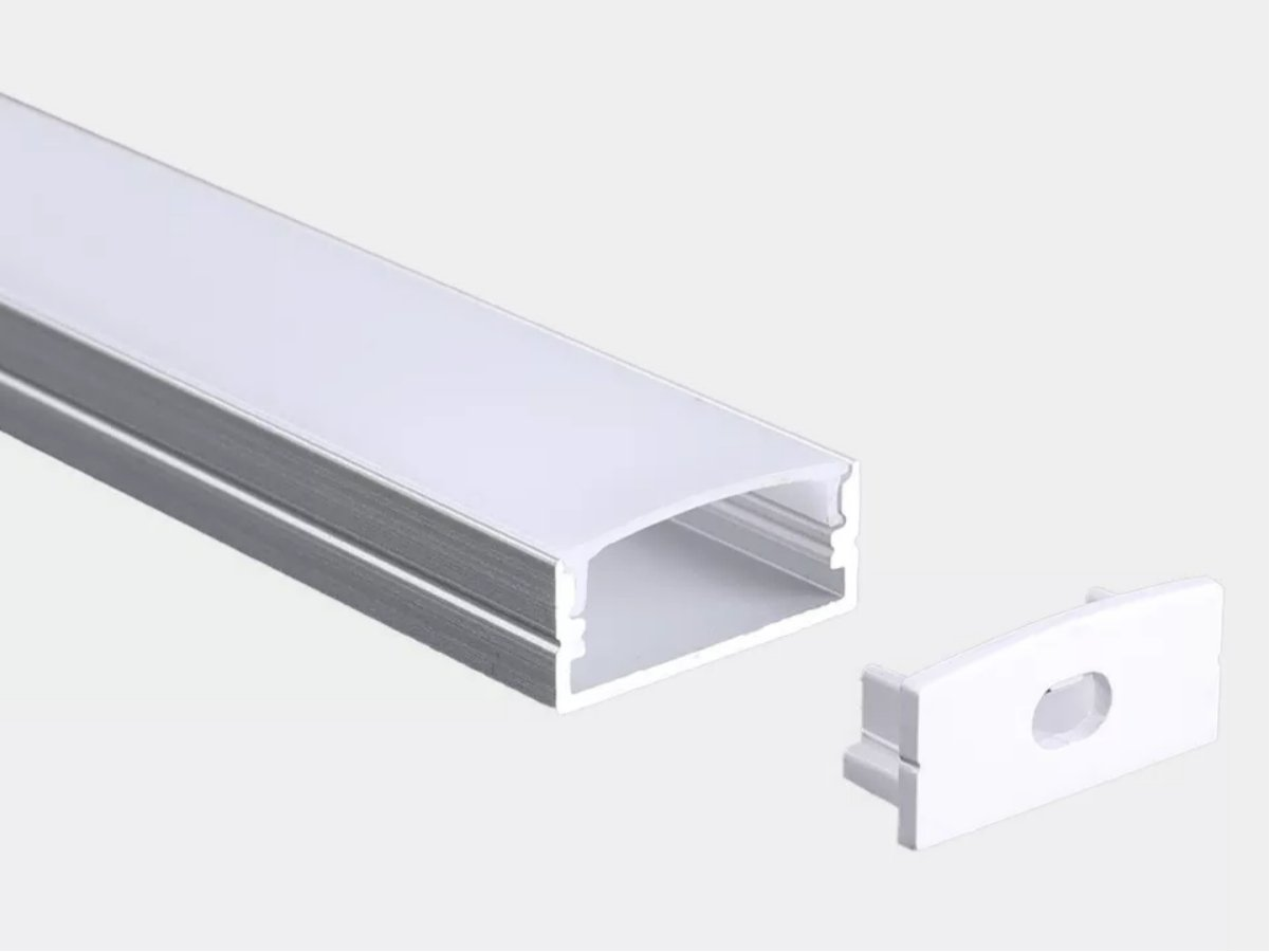

I have the one below but in black. I designed and 3D printed some brackets for them. One or two of them I made a wedge to angle them so they don't blind people. I just finished half of the installation in my cabin and am fairly happy with it. I went with some very bright 24v LED strips because I wanted to light up the whole cabin with what is essentially accent lighting. Not a very efficient method but it looks good. I used one screw to hold the longest 6' LED channel to the textured ceiling. The tape is holding up the rest of them just fine. I did not use any brackets for the head. I just taped it directly to the fiberglass.
I used some LED tape that I pulled off of an old project. The adhesive seems to be holding up but if it happens to fall off inside the channel, I won't think twice.
You can do a switch of some sort and a dimmer. I bought a wireless relay that I liked a lot but it didn't have the current capacity that I wanted for the cabin lights. I can look that up for you if you'd like.
Do note that I soldered all of the LED tape. It took 1-1.5 hours to do the strips for the whole boat. I made a few spares for the engine compartment.
