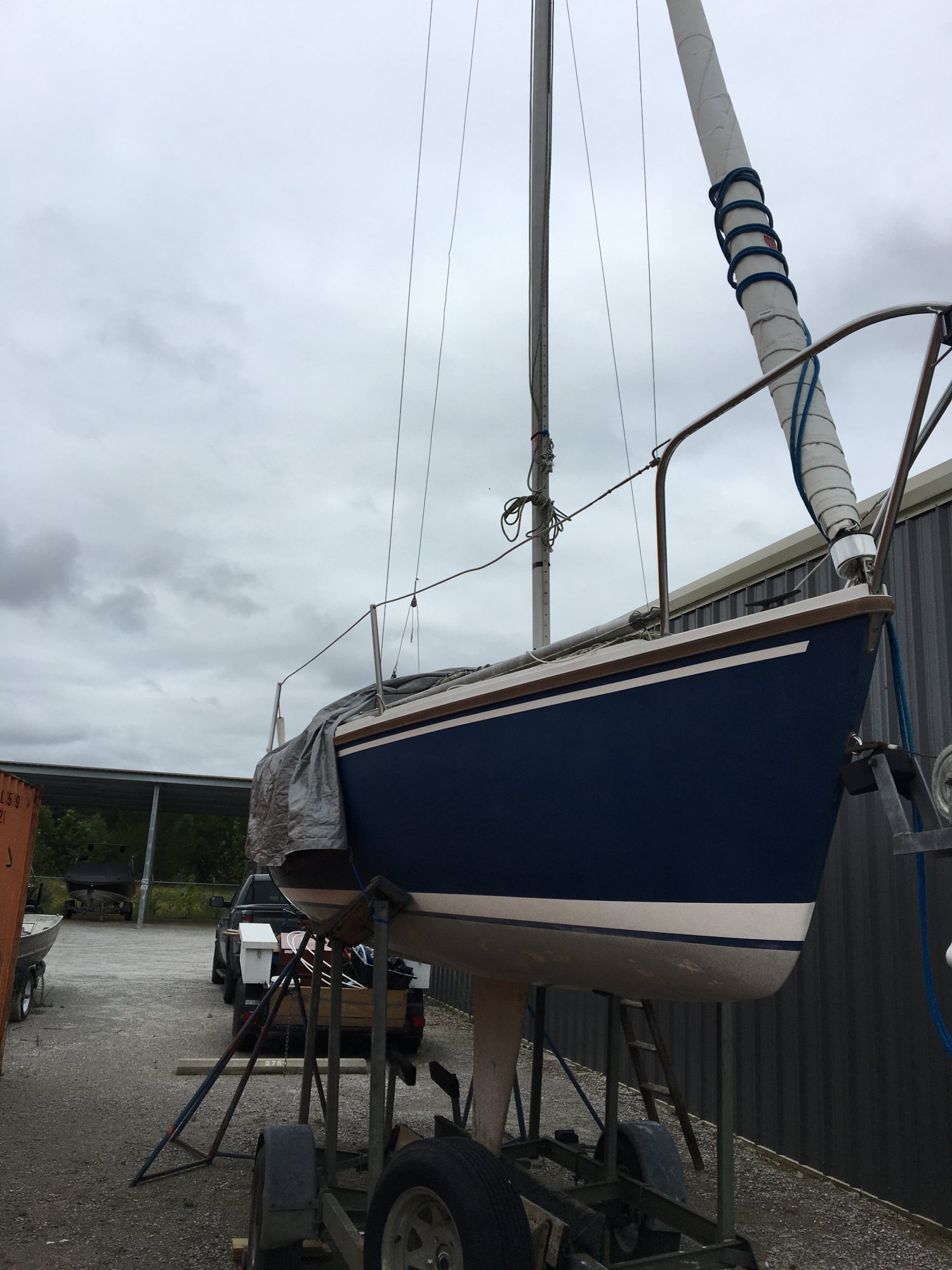

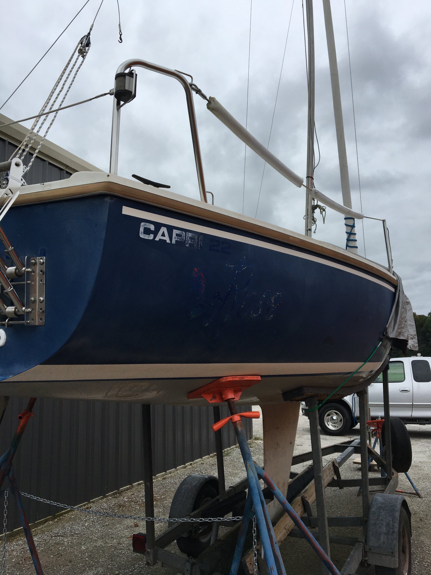

I have capri #279 and have lifted the boat off of the trailer multiple times to do bottom barrier coat and paint. The trailer is a six pad trailer. I have two tall boat stands that are positioned under the stern of the boat to take pressure off of the rear and middle trailer pads. I lower the trailer tongue, position stands at stern, then raise tongue. Then the boat stands have screw jacks which I will turn until the pressure is off of the back and middle pads. Lower the trailer pads and paint. Once the pad areas are painted then I lower the boat back on the trailer. For the bow I have a tri-pod lumber structure for support. I raise the trailer tongue has high as I can and position the tri-pod structure with pads under bow. Then lower the trailer tongue which takes the pressure off of the front pads. This will allow front pads to be lowered and area to be painted. When lifting the boat at different points make sure you use a fairly good size pads, mine are 12 X 6 inches. Also position lift points where the boat has stiffeners (stern). Make sure boat is sitting level and always keep trailer pads in place (not touching hull while paint is drying) when not working on the boat (for safety). I never lift the boat 100% off of the trailer--rear pads first then front pads second.
