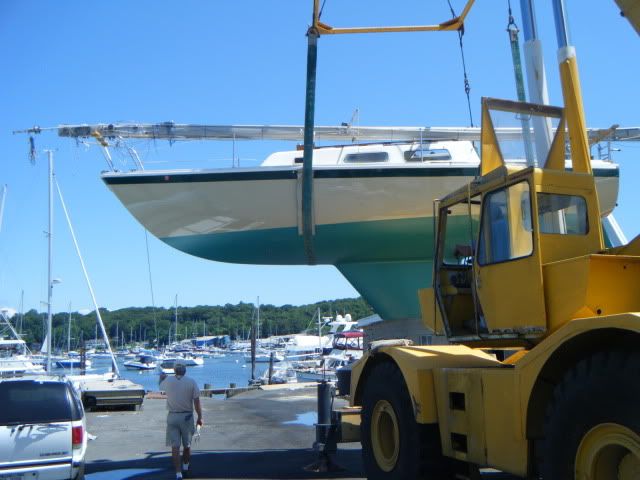

Looking at the photo, next time I would suggest that you tie the straps together on each side. One line for the port side and the other for the starboard side. I have seen a lot of accidents involving a rectangular spreader for the straps and even boats with a slight tilt like yourson the transom end. One other thing, I hope that was not you standing near the boat holding the line. If it slipped and fell, I only pray for your safety.
Prior to being a dealer now retired, I was an investigator and over 30 plus years in the marine incustry have experienced more than you know. I just err on the side of safety for everyone including yourself and there are times that the laborers at marine yards do not look at safety but getting the job done quickly without regard to their own safety either.
