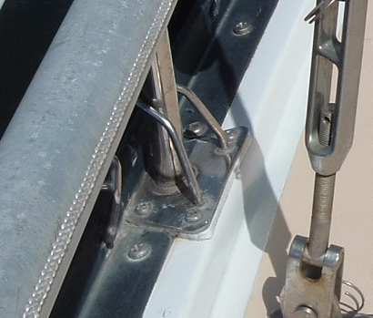

The H37C came with two styles of stanchion. Earlier boats like mine have a flat base plate with a starboard-like spacer under the deck part(pictured). Later models had a base plate shaped to fit over the toerail and down onto the deck. I don't see those on the White Water site: http://www.whitewatermarineinc.com/stanchion-base.html .

I saved all of my stanchions when I removed my toerails. They are kind that are stepped to compensate for the toerail. I was planning on doing the reverse of what Ed has pictured with the outboard side having the spacer, However I was considering starting over. I still havnt had the chance to go to the yard and bring the toerails home, but if they are the same dimensions as yours I would be willing to trade the stanchions for raw tubing (I am not looking forward to modifying every base plate).
