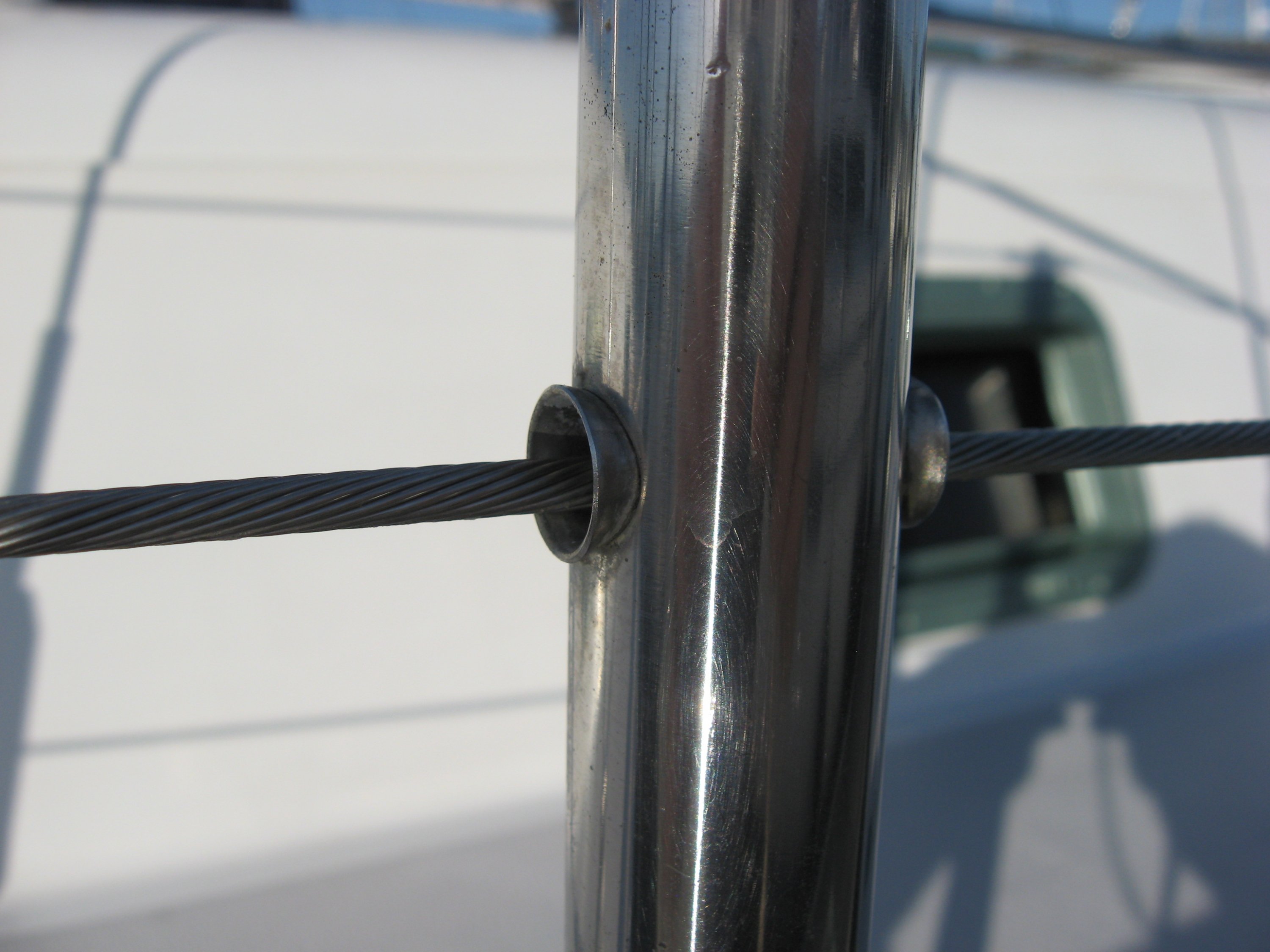

I was faced with a similar situation on my 180 Cherubini Hunter 36 when I bought it in 2007. The original plastic grommets which the lifeline wires were routed through the stanchions were mostly cracked or missing. The local hardware store had some plastic grommets .... but not enough. (Like these :http://www.ebay.com/itm/50-Plastic-...786199?hash=item3ce2e65f17:g:v4MAAOSwhh5TmkeS). Also, I wasn't sure that the plastic grommets would survive the constant sun exposure over the years.
So I went for the alternative you are considering. I used small 1/4" sockets as the flaring tool. (Like the smaller ones in the picture in this link >> http://www.harborfreight.com/40-pie...-1-4-quarter-inch-drive-socket-set-47902.html) The smaller flared end of the socket fit nicely into the SS tube. Then using a C-clamp, I compressed/flared one side of the cut-to-size-for-the-stanchion-hole tube. The unflared end the tube was inserted into the stanchion hole. Then repeated the flaring step for that end. This solution didn't completely roll the flare to the full angle a professional tool would. But it did flare enough to provide a chafe-free pass through for my lifeline wires (or dyneema in your case). And the flare was enough to secure the tube in the stanchion hole. Before "flaring", I ran a Dremmel tool grinding stone fitting around the inside and outside edges of the cut SS tubing to remove the sharp edges.
So happens I had a picture the outcome on my boat ...
