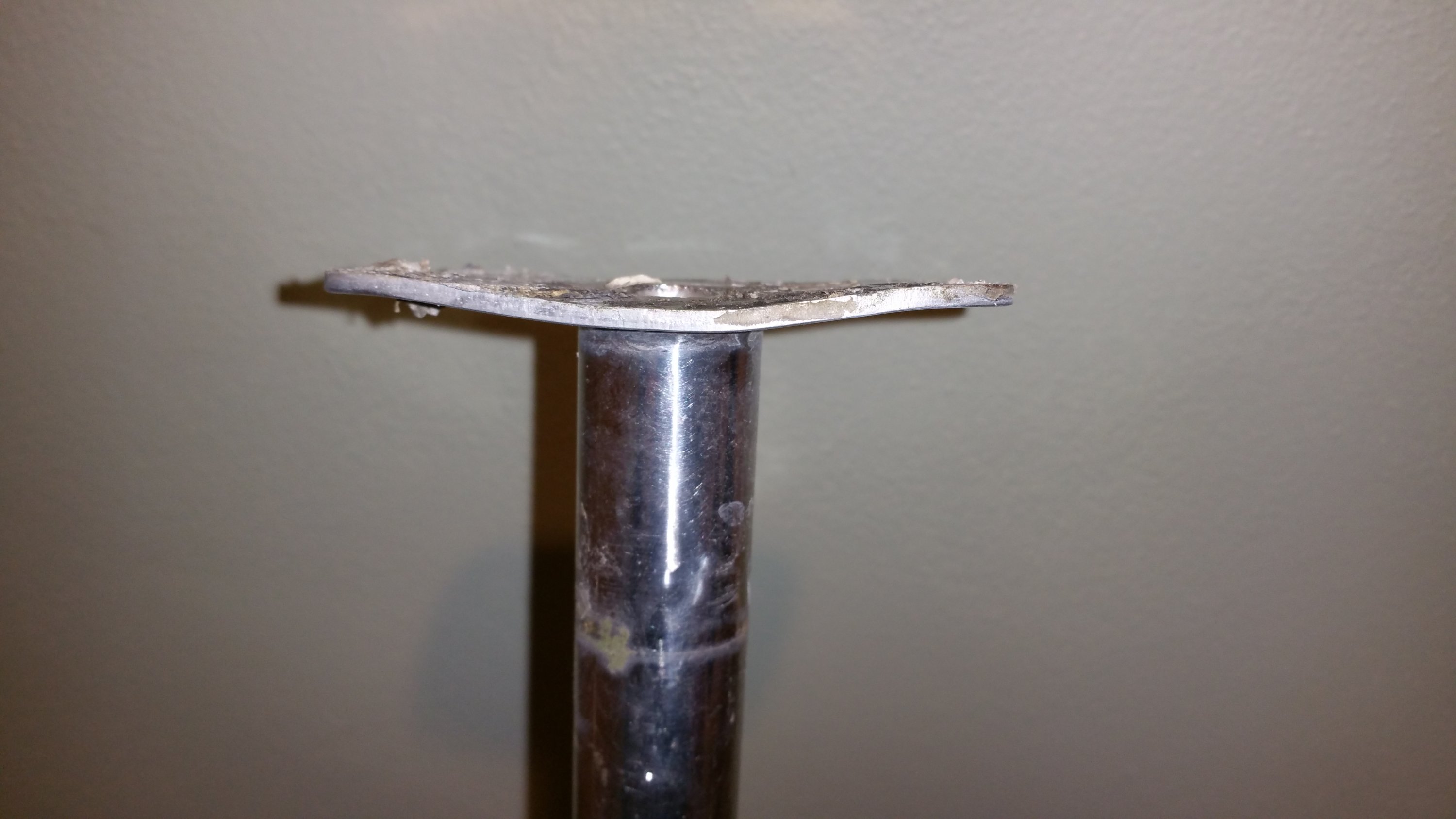

I have all the stanchions off our O'day 34 as I am re-coring large sections of the side decks during this layup. I am planning to use G10 in place of balsa core under the stanchions. My original stanchions are one piece, and the bases are rather thin and distorted in places. I am wondering if I ordered new, more substantial bases if I could cut the tubes off of my existing bases and use them in the new bases?

You "could" easily do it but I have one question about your picture. Is that a weld line, or sweated joint, about 2" above the base mount? You may be able to order larger bases with short fitting that the old ones will fit inside and you can bolt them together if you don't want to weld them. Google "Marine Stanchion Base" and get once that fits.

Distortion allows for drainage underneath. Water entering the tubes need somewhere to exit.

The line on the stanchion in the image is where the roller furler lead was clamped on. The distortion in the image is on the inboard side - not for drainage - and the distortion varies from base to base.
Sadly that is not how it is properly done. A drain/weep hole is drilled in the stanchion bottom and the base should be flat with no hole. Lightly constructed bases result in the distortion pictured, as well as deck leaks. Those bases were flat when they left the factory and should be flat today...

The distortion is from pushing on the stanchion itself and or the lifeline. The OEM products on mid range boats are made of 18Gauge stainless which is considered thin wall. The welded base (flange) looks to be 3/16".
If you want a sturdier set make sure the base is 1/4", and the upright tube should be 16Gauge. A bale around the tube and welded to the base would be nice. If you really want to go all out make sure the material is type 304.

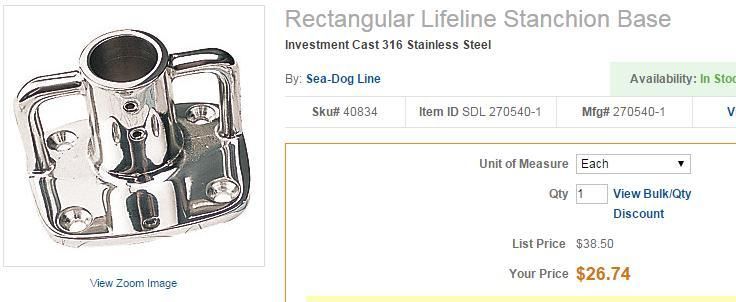

Hi Larry. Schaefer made a wider base that requires a quarter inch screw to fasten it in http://www.jamestowndistributors.com/userportal/show_product.do?pid=54305 . They were original on a lot of Oday models. Here is a link to how I attached mine after the recore: http://forums.sailboatowners.com/index.php?threads/and-so-it-begins.123244/page-8 post 157. I have had people yank on the lifelines and stations and they don't budge. Easier than backing plates or chasing around lost nuts in the cabin liner.

This is a good base at a reasonable price. 316 stainless - why would you want 304?
It came from Fisheries Supply but they are available at any marine store.

On the 35 the stanchions are two piece construction with a base similar to post number 10 or Joe's post. Rudy at D&R Marine sells them. They have a 4 screw pattern to bolt them down. Also with all the boats getting parted out you might be able to find some used parts from a derelict or wrecked boat.
