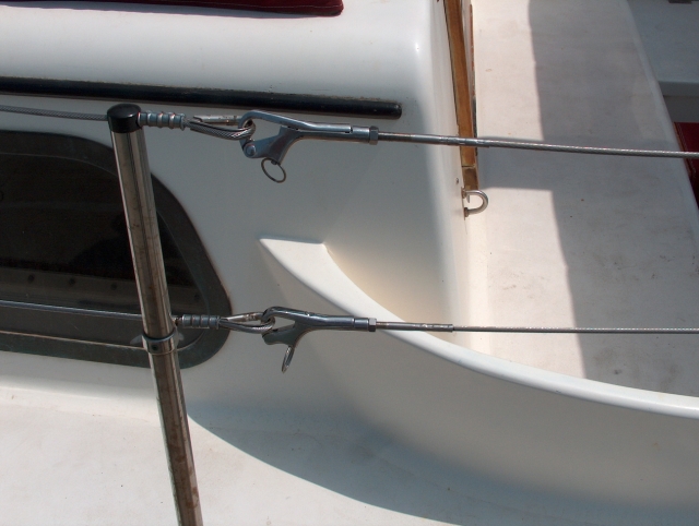

Here's mine Chris. 1x19 and Johnson Marine fittings. Bought one of their crimpers . Already owned the nicropress crimper

I did mine that way with the Nico fittings too. It worked and was cheap, but I find the eyes stick out too far into the gate way and I'm continually running into them, catching clothing on them, etc.
