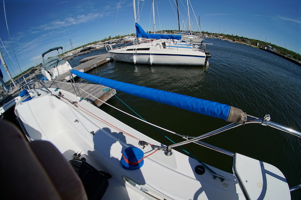

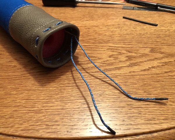

I installed the stanchions on my J24 yesterday, with some old vinyl coated lifelines that are serving sort of as placeholders. Thinking I will probably replace with Dyneema or something similar.
Question is regarding cushions. I’ll do the top lifeline in the cockpit and in the mid portion of the boat. But should I also do the bottom line in the cockpit. Would like to make it as comfortable as possible, but it’s unclear to me how much comfort the bottom will really add.
Thanks in advance for sharing your knowledge.

They turned out so nice i dont wanna lean on them.
