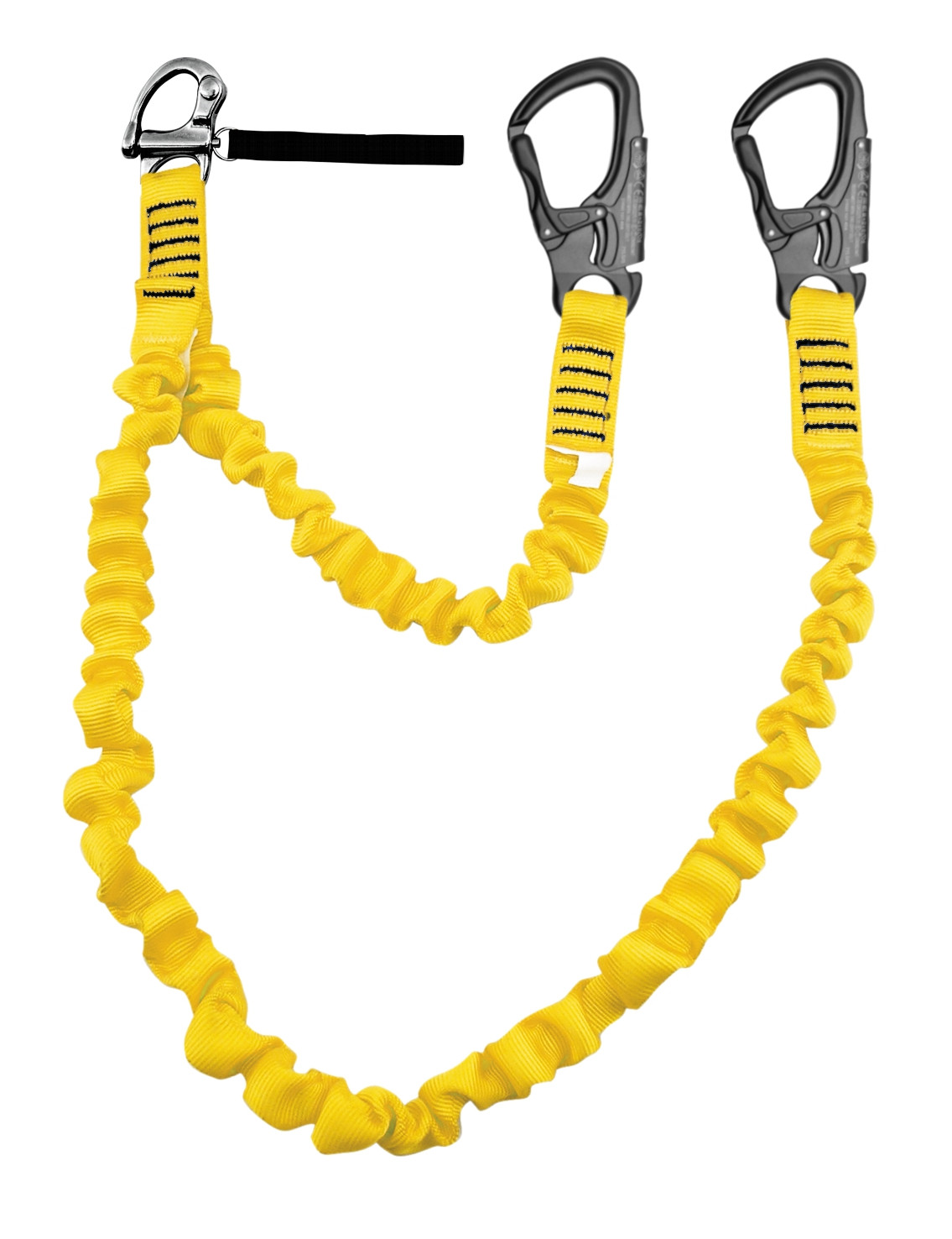

Typically called "jacklines" sometimes lifelines-- webbing that you run from forward cleat to midships or aft cleat both starboard and port. With the jacklines laid in you have a tether usually comprised of a long (3+') and short (less than 2') length-- one end with a one handed locking carabiner on your harness the other two leads in sequence to tie off either the jackline with the long lead walking forward.. then re clip on the short for close work at the mast or wherever your work puts you. So long when moving-- short once static.
There are a million versions out there to consider-- but a sample of the tether and poly jacklines here:
