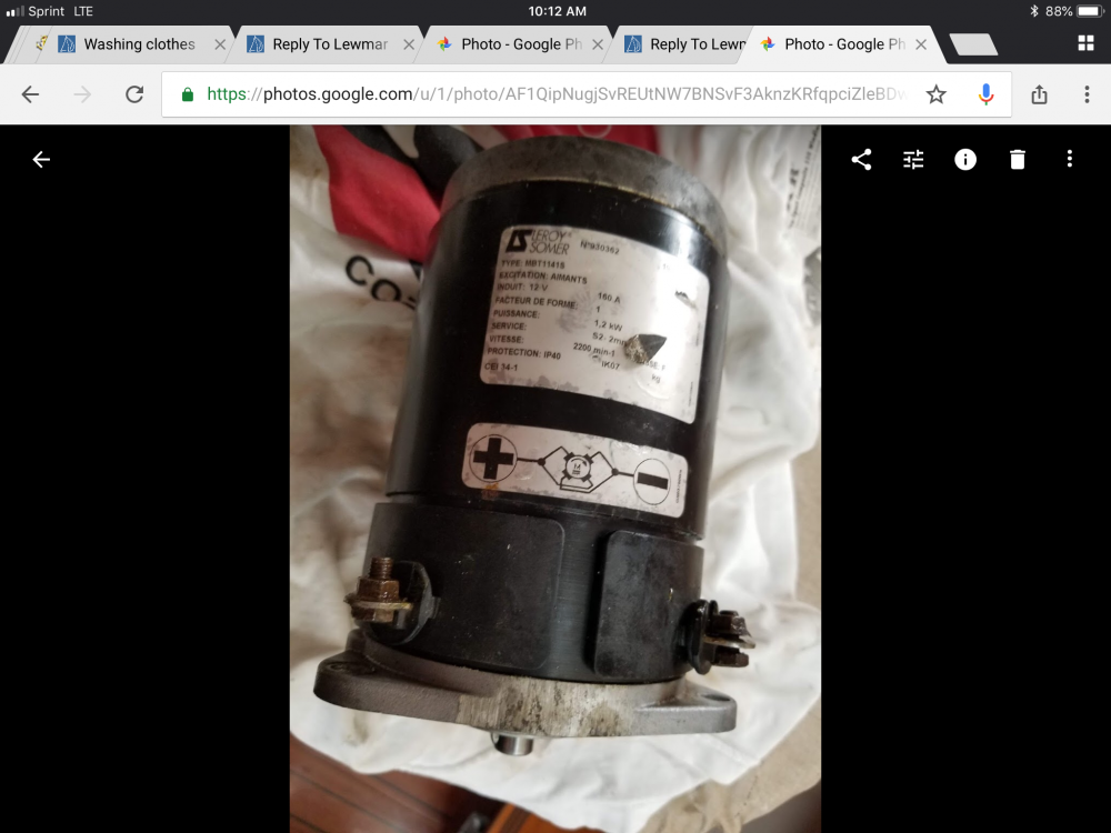

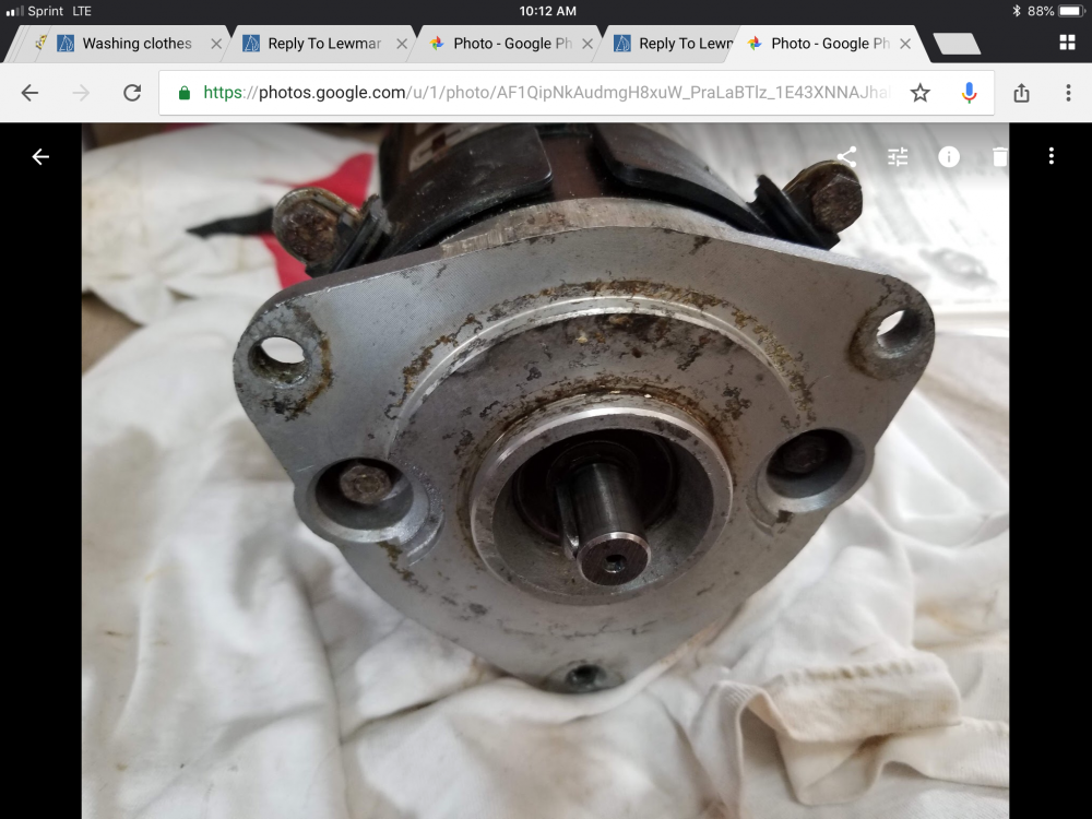

Well Rich, we meet yet again lol. You always seem to have great information and a wealth of knowledge. Our Leroy Somer windlass has been intermittently working. After digging deep, we realized that it is a motor problem. Either the wire connectors inside are in need of tightening, or something more dramatic like the brushes failing. We won't know until we actually open the motor up. Do you suggest we look into rebuilding this same 18 year old motor? Or should we save the money with a mechanic and put it toward replacing the whole motor? And then there's the problem of whether a new motor will fit into the current casing and align with the other "stuff".
Thanks,
Cara

Well Rich, we meet yet again lol. You always seem to have great information and a wealth of knowledge. Our Leroy Somer windlass has been intermittently working. <snip> Cara
If your Simpson Lawrence windlass has a Leroy-Somer motor, I would not spend a minute or a dollar on it. I have been that route having a local shop rebuild with brushes and it continued to give grief. I finally purchased a replacement motor from SL Spares in the UK. The link is in my post above. They have motors and adapter plates if required to fit your windlass. From the other posts in this thread it appears that there are other supplies that have replacement parts as well. Just make sure you don't get another L-S motor! I will say that I have had to replace the brushed in my replacement motor, but that was after 10-13 years. It seems that windlass service is extremely hard on motors.
One consideration you need to verify is whether you have enough room for a new motor. The replacement that I received from SL Spares in the UK was about 1/2" longer than the original. That required me to grind out a bit of fiberglass under the anchor locker to be able to move the motor into position.
Also as a heads-up, I have learned that these windlass's need service. S-L recommends yearly, but that is probably over-kill unless you are using it all year long. I just had my S-L fail by slipping and failing to pull in the chain and anchor. After removal and disassembly I found two broken Circlips, a slightly worn bearing, and thick dried-out grease. Now repaired and ready to re-install.

Hi Rick, I appreciate your responses so very very much. We are still going back and forth about purchasing a new windlass or replacing the motor. But I need to pick your brain a bit more if that’s okay.
How long ago did you replace your motor. Did the new one have 2 leads?

Yes, the motor from the UK was made by Lemac and it has two leads. So it requires a reversing solenoid to run in and out. I replaced my OEM Leroy-Somer motor in 2006 after multiple brush failures in 8 years of operation. Ten years later in 2016 the brushes failed in this replacement motor and I had a local shop replace them for me.
This is an interesting turn of events. Two weeks ago my S-L windlass motor ran fine but the gypsy didn't move. A tear-down showed a couple broken Circlips. I replaced them and the base bearing and seal also while I had it apart. Windlass re-installed and working fine.
Now 3 days into my 7 week Maine cruise, the windlass motor slows and then fails to run at all. T/S showed that the brushes were not making contact with the commutator, and it looks like the brushes that I had installed by a local shop less than 2 years ago was a very poor job.
So with limited options, this morning I ordered from John McMaster in the UK a new motor, and also spare set of brushes to be expressed to me. I am stuck in Plymouth, MA. Outstanding service from John at SL Spares, he is shipping today (he is 7 hours ahead of me) via FedEx Express and I a supposed to have the parts by 10:30 am tomorrow! So I will have a set of brushes that I will put in my existing motor. If that fixes the old motor like I think it will, I will install the new motor and keep the old motor as a spare.
So I took a hit of $500 ($100+ was just express shipping), but is much less than a new windlass. And a new windlass would have meant figuring out a new installation and I would have needed tools that I don't have with me.
