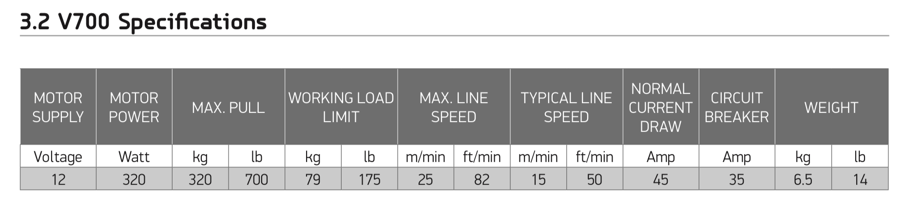

I had not found the specs on the V700 and silly me, I thought the 700 was watts. 320w is pretty puny. my current windlass is a maxwell 500 which i believe is a 600w motor with a max pull of 500lbs. It still works fine after 36-years of service but only has a rope capstan so it cannot pull chain. There is a reason that the V3 costs 3x the V700.

I was just reading the west marine guide for "choosing a windlass". In there, they indicated that the max lift capacity should be 4x the weight of the gear. If I have 150' of 1/4" chain at 0.75lb/ft (113lb) + 35lv anchor, that would be a full gear dead lift of 149lb. The V700 has a working limit of 175lb so according to them, it should work. I do not use the windlass to pull the anchor out of the bottom and with a chain gypsy, that would continue. I can motor up onto the anchor as I am using the remote button to retrieve the chain. Once I am over my pin, I stop pulling with the windlass and let the momentum of the boat overriding the vertical chain pull the hook out of the bottom. That is how I do it now, but I need to hand pull the chain as my wife motors up and then when I get over the hook, I take a turn on a big cleat on deck.

I agree, I am just not sure if it needs 3x the power of the V700. Given that my gear would weigh 150lb, the V700 has a 4.7x overstrength. Not sure why I would need to have 15x overstrength.
