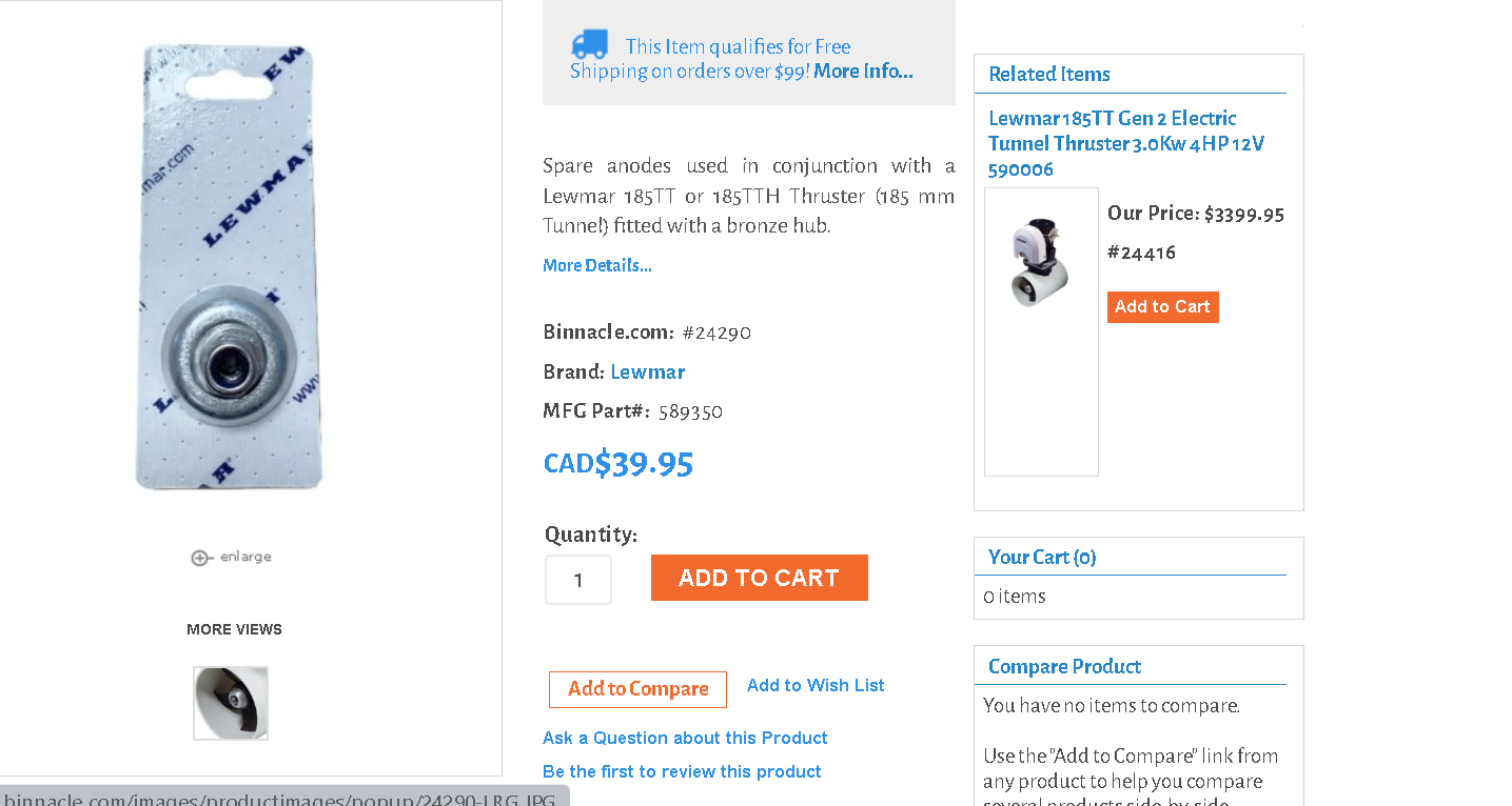

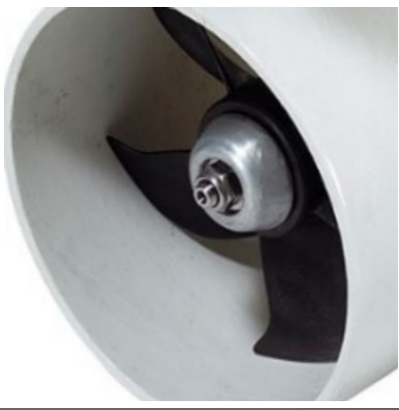

I agree with Ralph - it seems like the only Lewmar anode would be for a thruster and not a windlass. One point of clarification though - an anode isn’t just about stray current corrosion. An anode is meant to be the least noble metal in any galvanic circuit, so that it corrodes before any metal you care about. A galvanic circuit exists any time dissimilar metals are connected electrically and in the same electrolyte. That’s separate from any stray current issues. But still in the case of a windlass there wouldn’t really be a way to put an anode in the same electrolyte as metal it’s protecting, so having one probably wouldn’t do any good.
