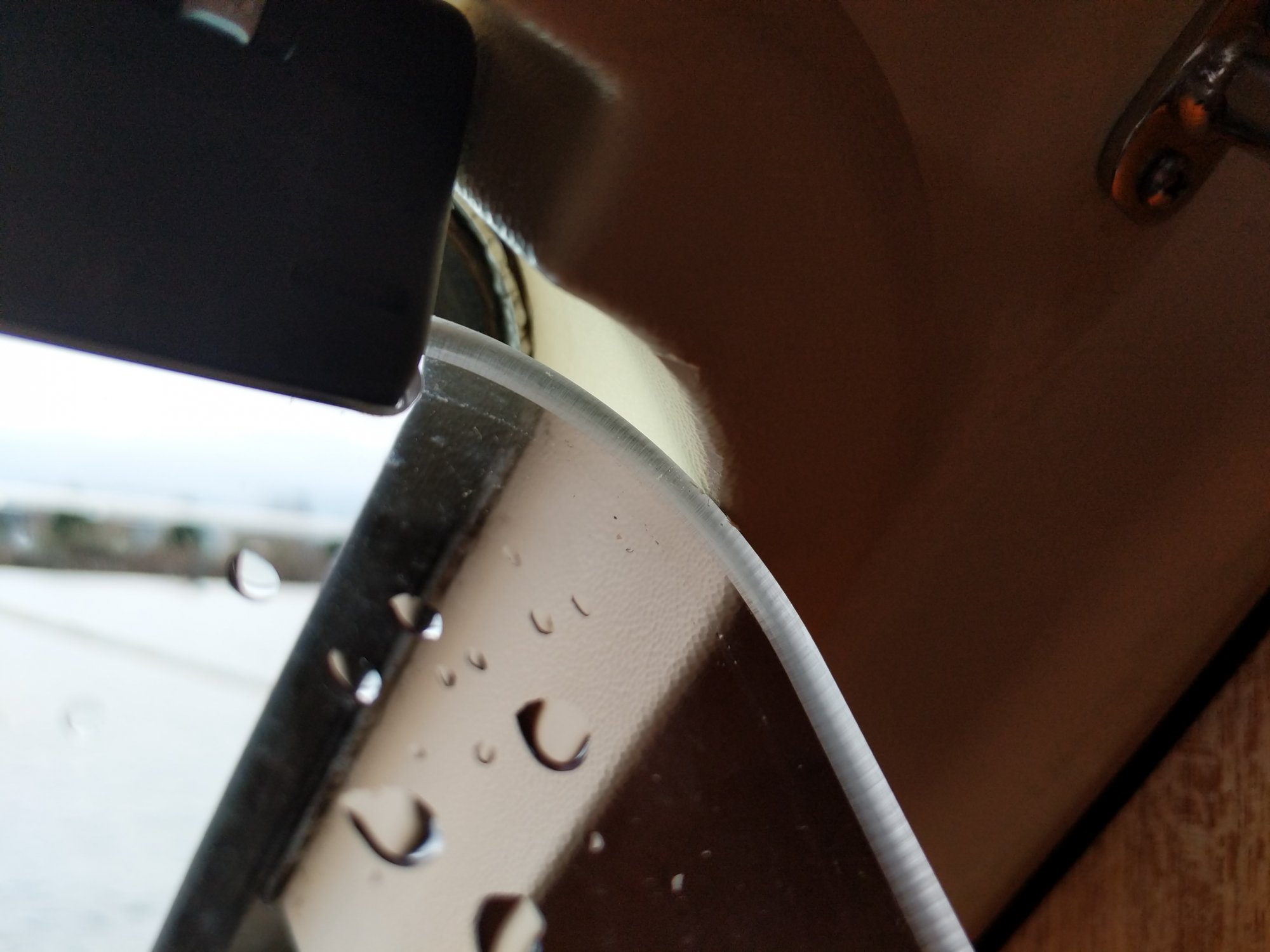

On my 02' Hunter 466 the portlights are heavily crazed and you can barely see through them. I ordered new lenses and have run into a problem. The new ones are slightly thicker... Hopefully this means sturdier and longer life. It means swapping out the hinge assembly and catches for the dogs. No problem. When I reinstalled the trim, I found that the bevel on the old windows allowed them to clear the trim. The new lenses have no bevel. Does this mean I am going to need to sand/router the bevel in by hand on all 8 of my portlights? Do I need to get new trim pieces? Has anyone else dealt with this issue?
