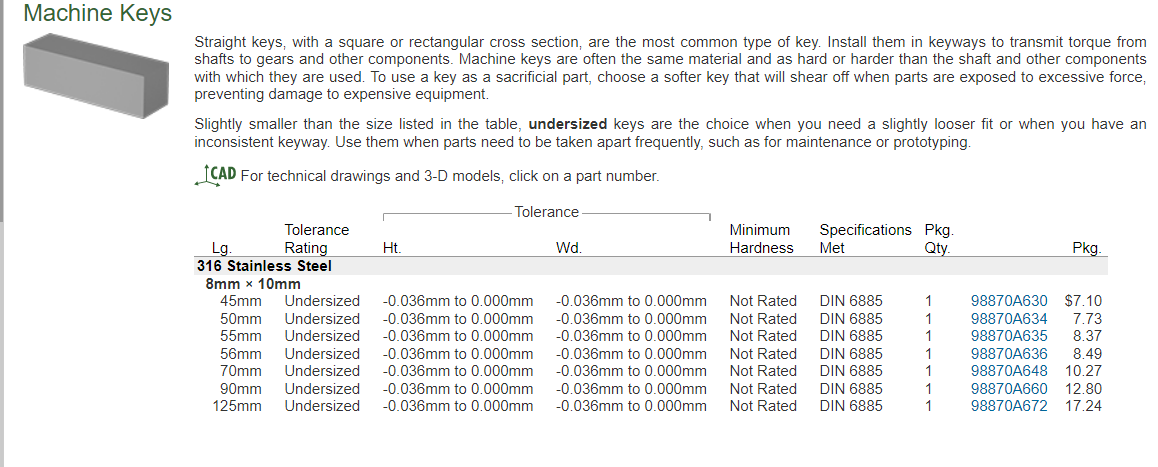

I was going to get these machined, but was looking at $250 for 2 of them. Before you jump out of your seats, this makes sense. You can only get 8 mm stainless square stock in 1m length ($150 plus tax), and thus has to be done on a Bridgeport. This isn’t a hacksaw job.
I looked at buying ready made keys, but up at 8mm, you can’t get square; only rectangular. This makes sense, as keyways in the machinists handbook (holy bible of all things metal), specs keyways 8mm and larger to be rectangular. I assume that the shear force calculations dictate this.
So, got back to Lewmar, who back ordered keys for me.
