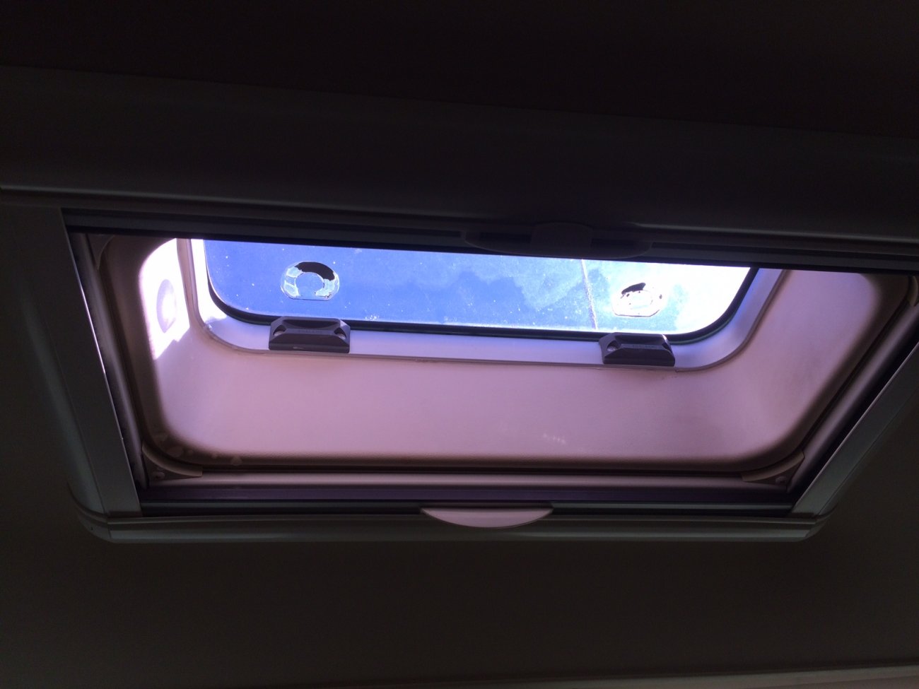

On our 2005 Hunter 45 CC both of the handles on one of the Lewmar Hatches in the Main Salon broke off. The original handles were attached to the hatch lens with some type of epoxy, and not through bolted. After contacting this site I ordered two replacement Hatch Handles, (right and left). These replacement handles do not use epoxy, but rather will be through bolted to the lens. I am interested if anyone else has had this happen, and did you replace them with the same ones that I will be using.

I had one that debonded over one year ago. Reattached using Plexus MA310 adhesive (same as devcon). It is comparable to the adhesive that Lewmar used. Still working well one year later.
