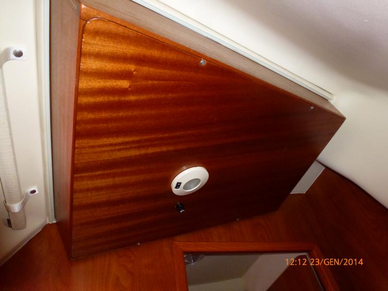

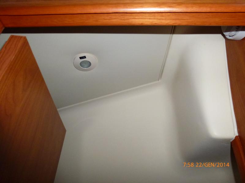

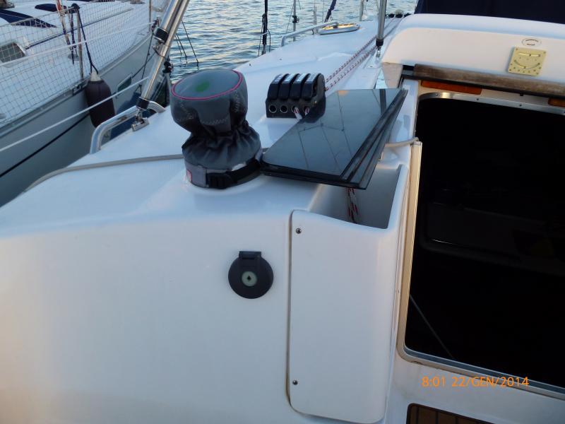

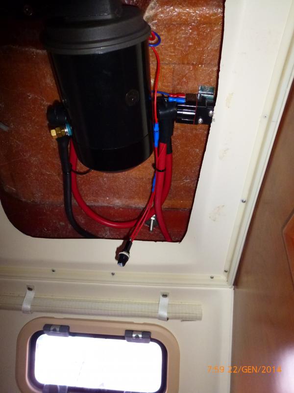

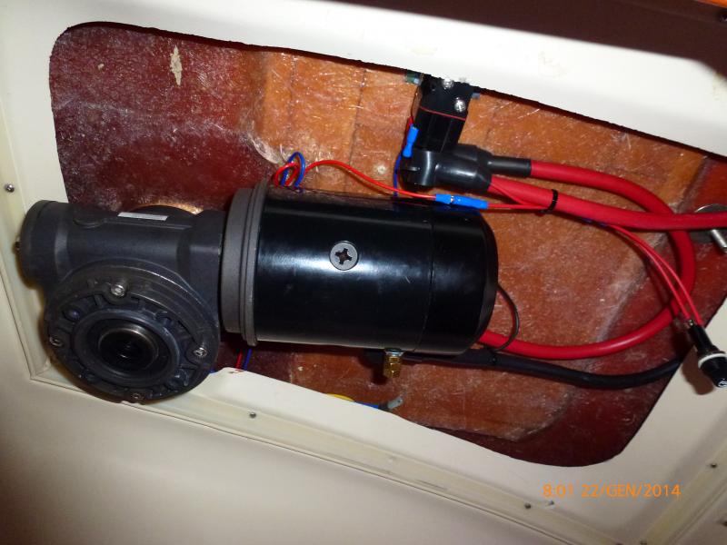

Hunter Marine Hunter 38 Alghero
Hello, I made this change about a month ago.
Costs (in Italy) € 1500 for the motor and € 500 for the rest, assembly and carpenter. I enclose some files with photos of all the work.
In my experience .... I can recommend it

Most excellent-- I see you are on a newer Hunter 38, but looks about the same. The Lewmar 44 is on the starboard side of the companionway on the 380, but probably about the same amount of effort. Looks like the carpentry was the most difficult part.
