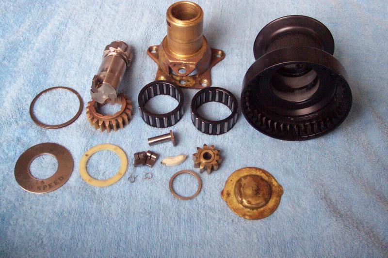

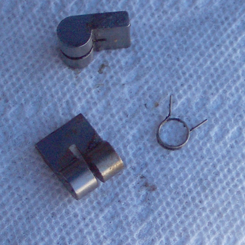

The pictures show a completely dis assembled ST 16 and the pawls and springs for the same.
Rebuild kits, part number 19700100 are readily available from multiple sources for about $45 and in the bay area I can get individual pawls and springs from at least two different chandleries. The individual parts would save money, you probably won't need pawls but I would replace the springs just because.
