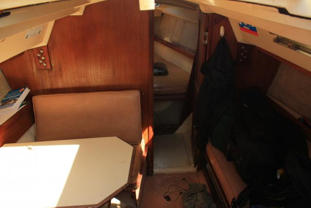

Ah so i finally got some pics. rather than up load them and be really photo heavy they are on my shutterfly site. http://ghostwriter247.shutterfly.com
as you can see she was a little in need of tlc. and someboady had painted the floor a god awful peach tan.
When i took up the floors the under parts were not painted and they were pretty much rotted. some of the pictures show the mildew and the dirt.
a few later pictures show everything as shiny and clean as only clorox and water can do

I cut new floorboards and sanded the bench pieces as they were still good.
On to a coat of nice nautical gray. I then went back out to the boat and hand sanded the piece i couldnt get out as well as the hull liner that had been painted. Man did that suck!
Tomorrow ill get pictures of the post paint. The bilges got a nice coat of nautical gray as well.
As you can see the bulkhead has rotted below so that will get replaced in the near future. I love it when a plan comes together. Stay tuned.
