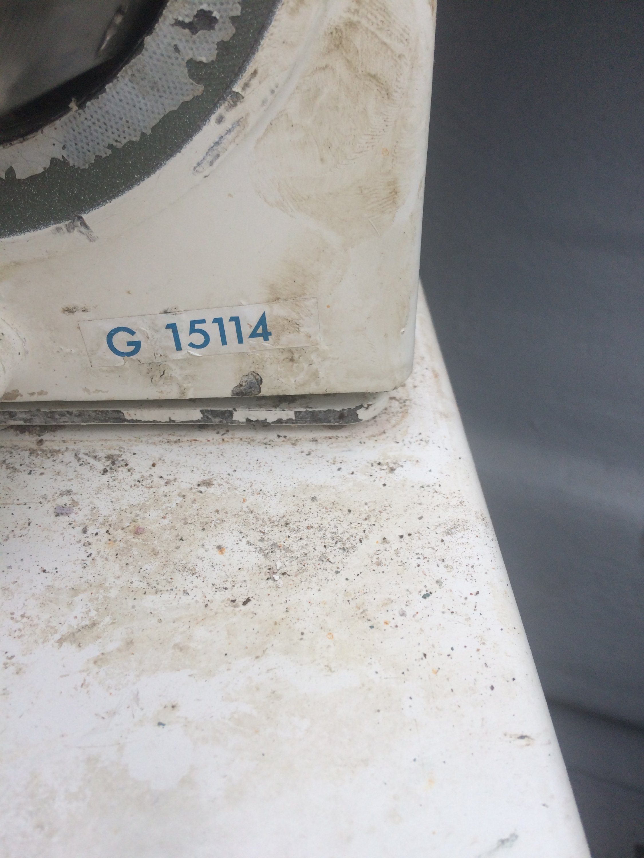

Here's an update on the Leroy Somer windlas, I've taken a couple of photos for info and have a bit more information from the ID
Plate on the motor;
Angouleme 16015
Reducteur No 2R7775
Type MB2101 M00C
Reduction 60
If anyone has any information on how to remove this motor from its casing, I would really appreciate it,

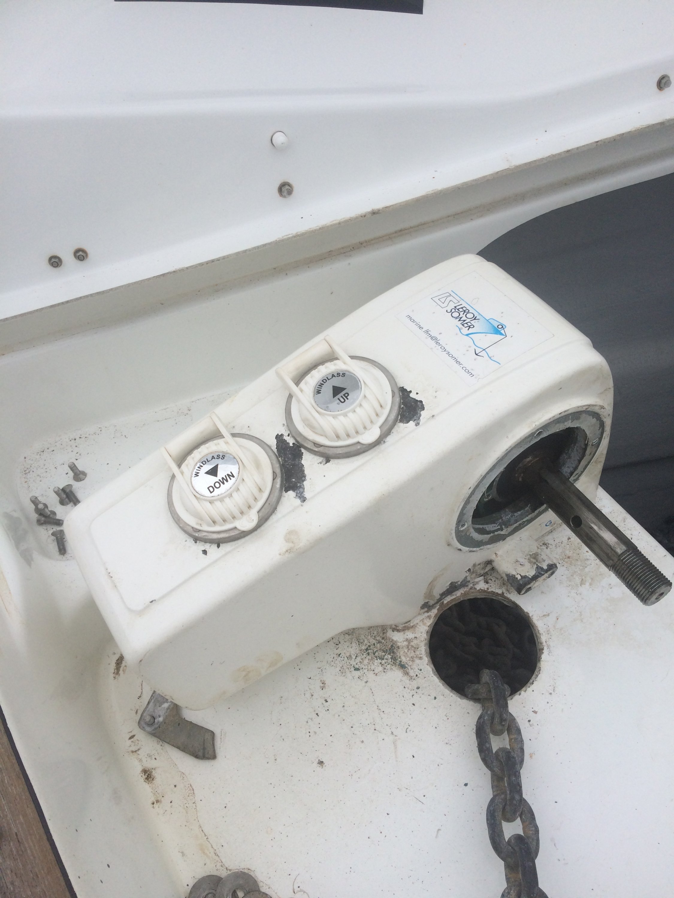

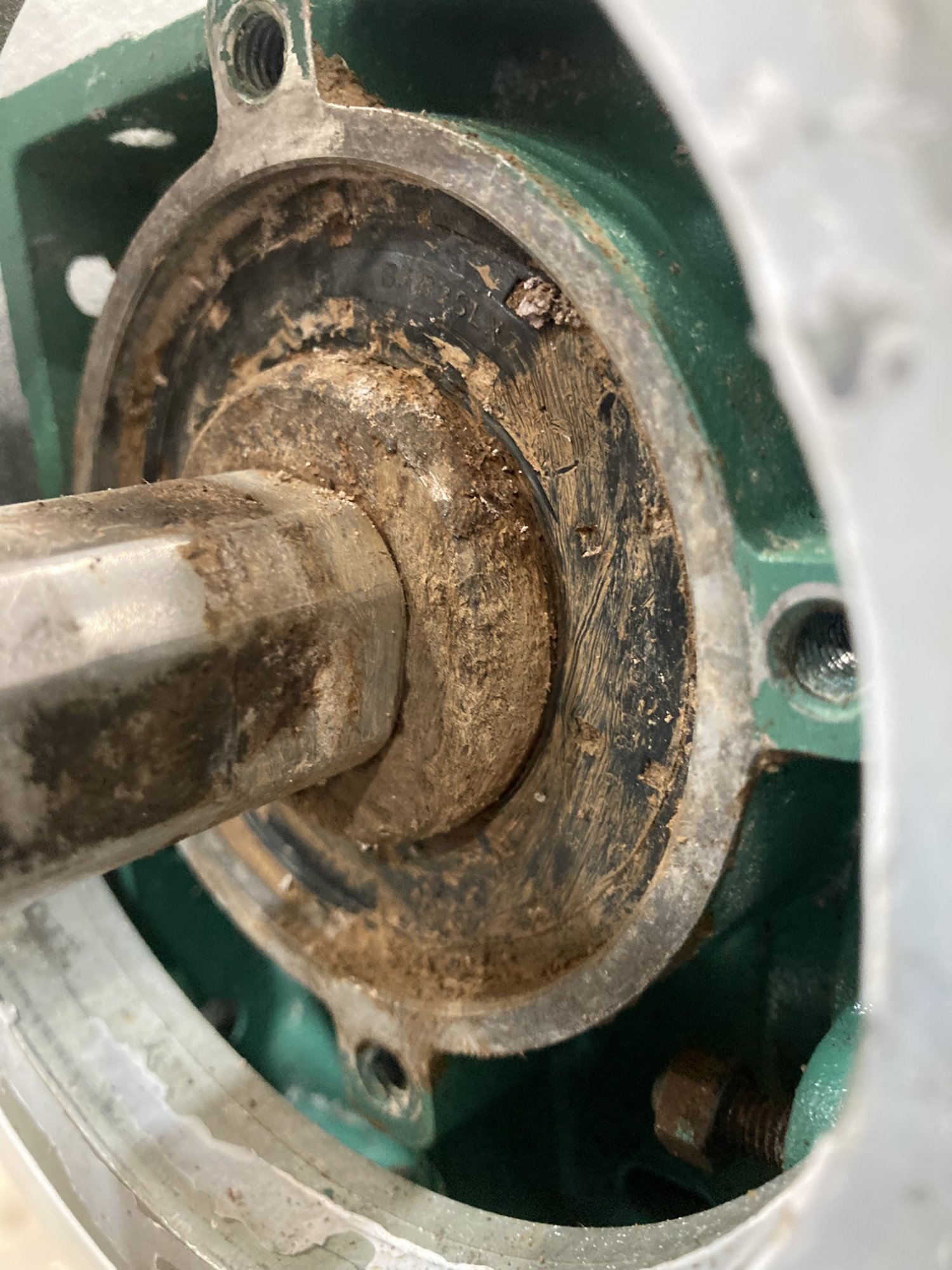

I'm trying to get access to the motor on a Leroy Somer S801 windlass. After much work I've removed the chain gypsy and cones but it now appears that I need to remove the shaft in order to get the gearbox and motor out of the housing.
I do not see any clip or pin that holds the saft in place so I'm thinking it just gets driven out.
See the attached photos.
24,509
When you clean up the collar on the shaft, is there a set screw under the dirt or grease?

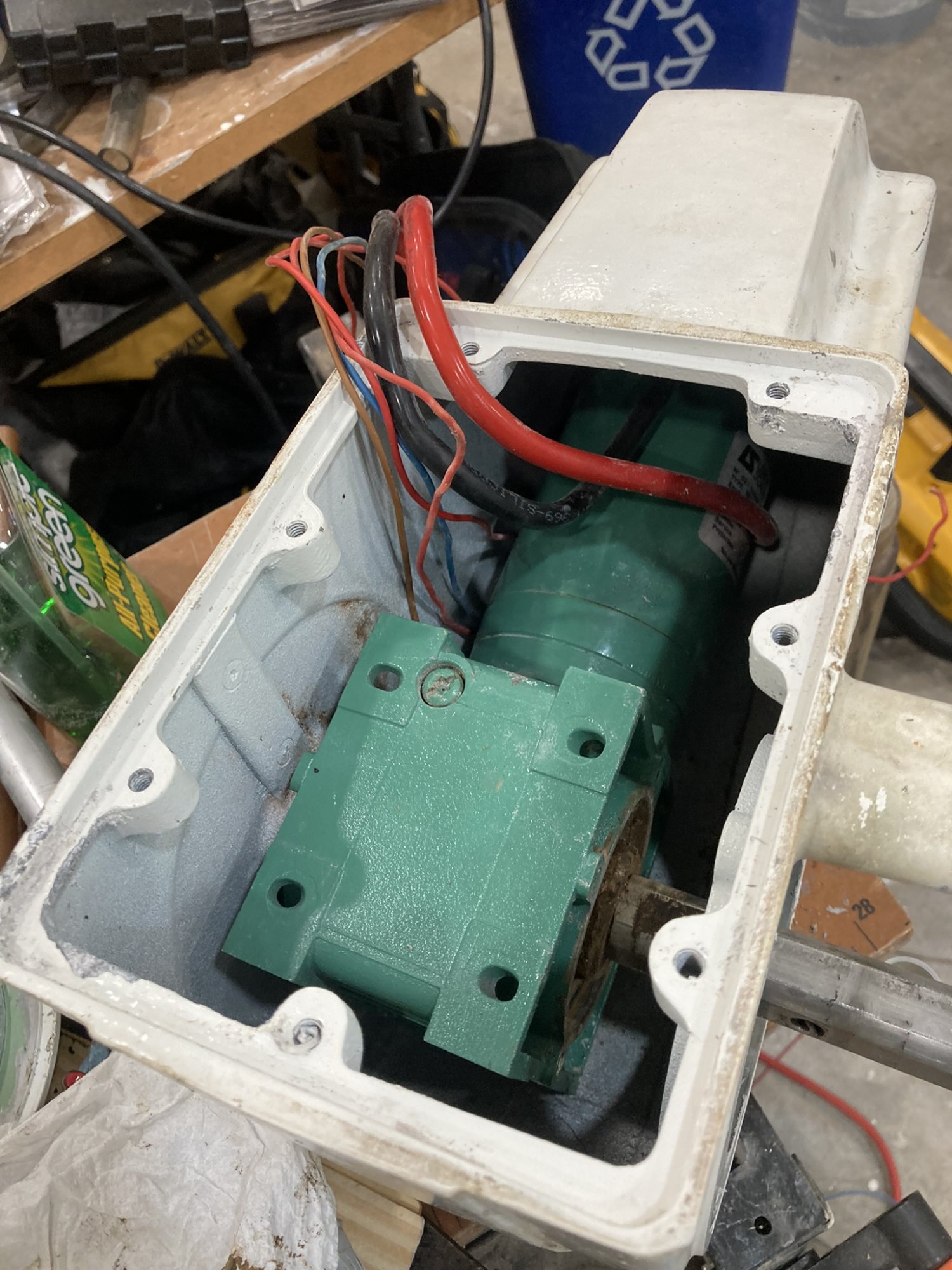

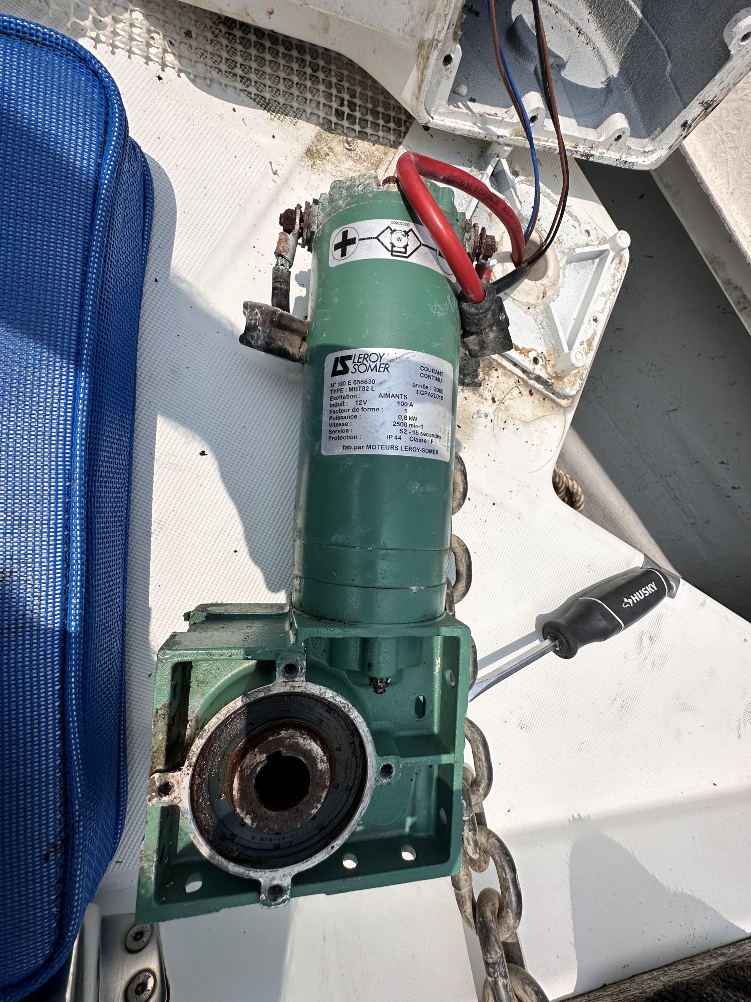

Mar 6, 2023
2
Lagoon 410 Hampton, VA

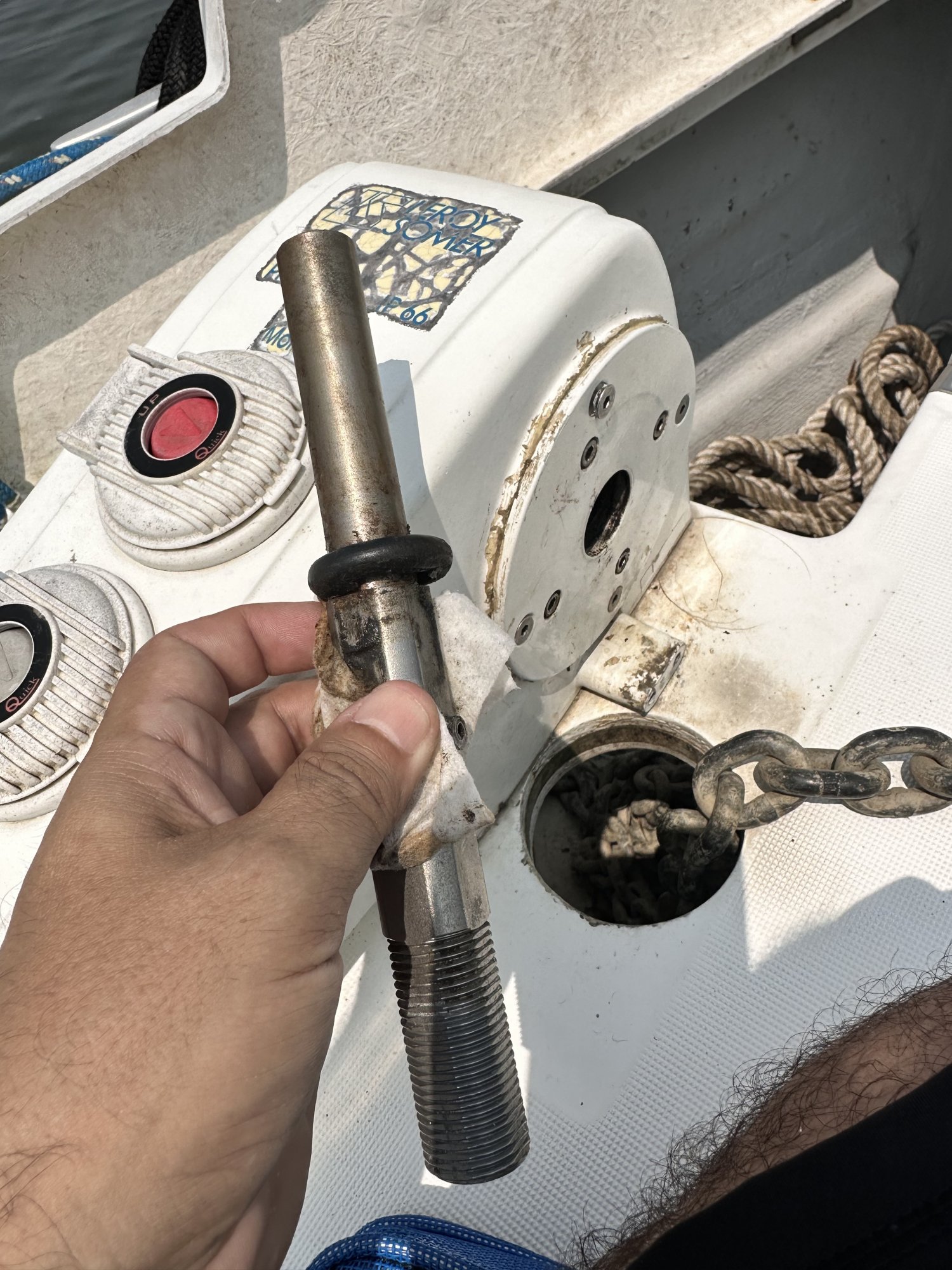

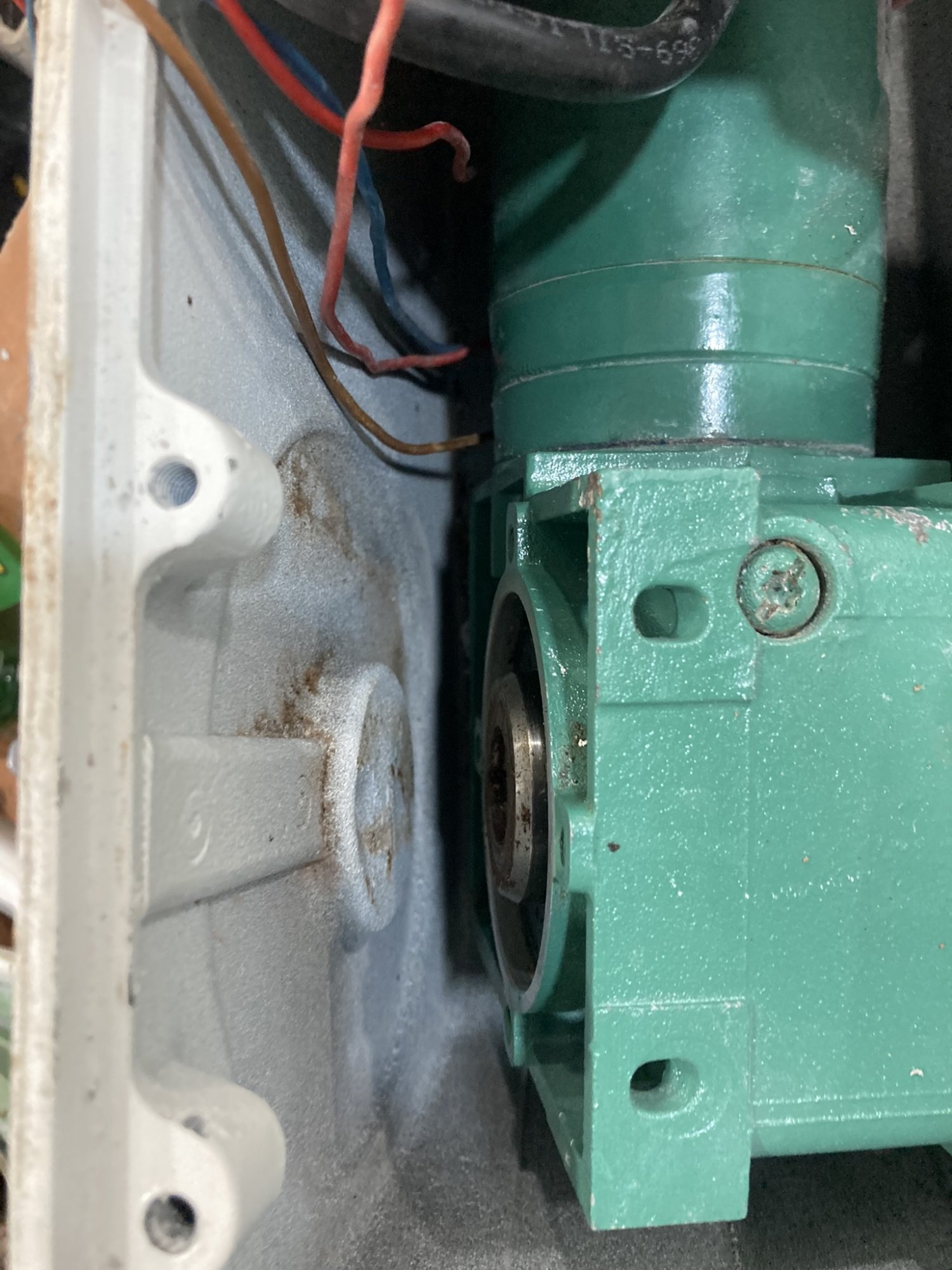

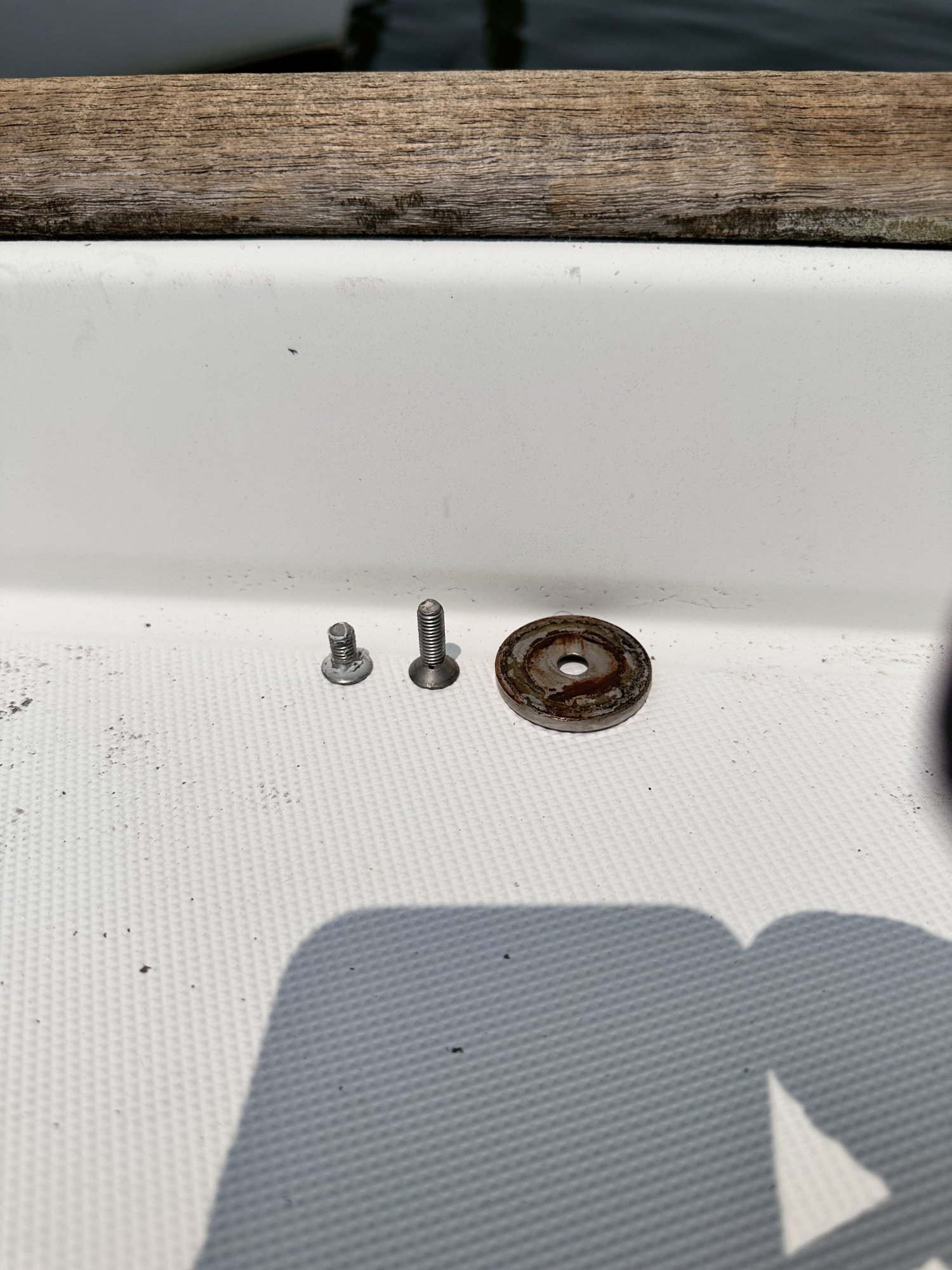

There is a alan bolt opposite the shaft that needs to come out, that lets you unscrew the internal alan bolt holding on the shaft and it just pulls out. Now, what I need to figure out is how to get the motor off the gear. Let me know if you come up with anything.
May 29, 2023
2
Beneteau 36Cc Annapolis
I was able to pull the shaft just recently. While dismantle, do not remove the motor from the housing. Opposite side of the shaft has a machine screw, take that out. It is outside of the housing, across gypsy. It is aligned with the washer and screw in the center of the shaft. I first didn’t understand the purpose of the screw since it did not hold anything.Use long alien key and take shaft screw out. It is the shiny washer at the end of the opposite side of the shaft if you look at it from below however you can’t reach or see the center screw. Keep the pin on the shaft which stops gypsy since you will be using that to pull or push the shaft.

I'd previously made it as far as that but couldn't get the motor separated from the gearbox. I put it back together (and forgot a piece)and now I can't get the *$&$% gypsy off again. Did you get those two separated? I bought a new motor for mine, I can send you the link if you're interested. I just gotta get the stupid thing out again.
May 29, 2023
2
I replaced with Lewmar H3. I am not going to deal with that motor again. I took the whole motor to a machine shop. After two weeks we declared it dead.
