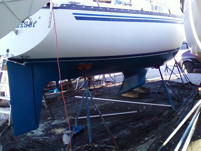

Just wanted to say thanks to everyone that responded to my post, I am still restoring the boat and it is getting very close to completed. Just need to complete the rebuild on my transmission and install the motor in the boat. Attached is a current photo with the new prop shaft installed, and bottom painted and ready.
