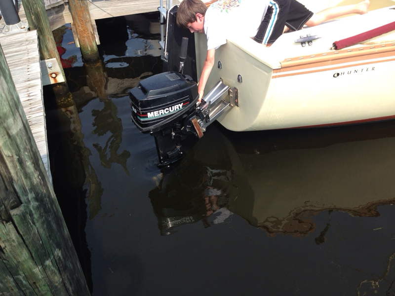

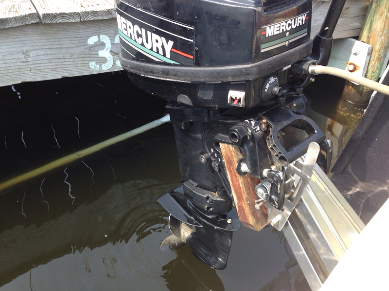

Ok here's a couple of pics from our boat on the water, I did hit some 3+ foot waves in the channel going out into the gulf this weekend, where my prop did come out of the water but it was only a couple of times and wasn't the biggest issue... My first mate (wifey for Lifey) was way concerned about other issues than the prop coming out of the water. :)

You are fine. I can only guess what other concerns there are in choppy seas but at least you are alive to let us know vs. in the coffin.
