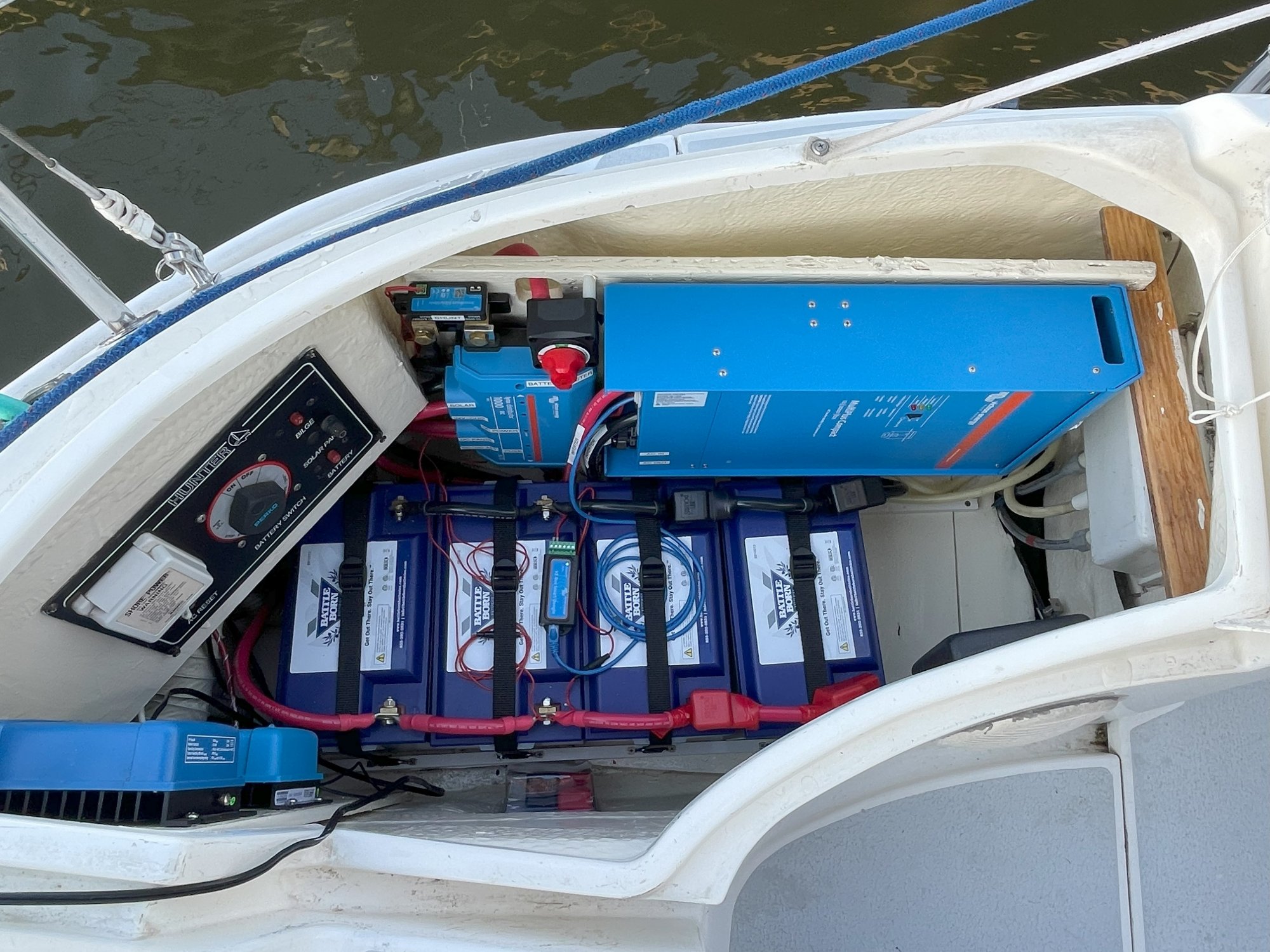

Do you have any pics of your solar setup? I just added 720w. Looks only ok, but works great

Planning on another 300-400W flex cells on bimini and separate MPPT controller for a total of 800W for 400ah. Not really an issue of battery capacity, but how to get enough solar to charge it back up or break even after a few days. Only use about 15% of battery capacity per 24 hours depending upon solar input. With a 85A alternator and DC-DC charger (to protect the alternator) only charge at 15A at best. 400W under boom is an easy but not so efficient place to mount cells. The biggest power saver was reinsulating the refrigerator and freezer areas and designing a digital spill over freezer-refrigerator system.

Thanks for the pics @SV Maverick. Interesting setup - different than mine. Gives me design decisions to ponder. I was planning on putting the lithium batteries below the aft berth where they are now. Also, I built a solar arch. Unlike many other boats, we have a pretty high freeboard and cockpit, and resultant seeming low boom. So my solar arch is at about the same level as the boom instead of what you often see - often the solar is above the boom.
Also, my dinghy stays where your solar lives - I'm planning on adding another 100w flexible on top of the dinghy. Maybe another 100 on the dodger.
