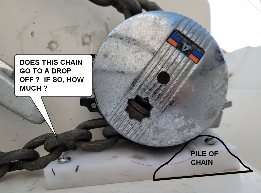

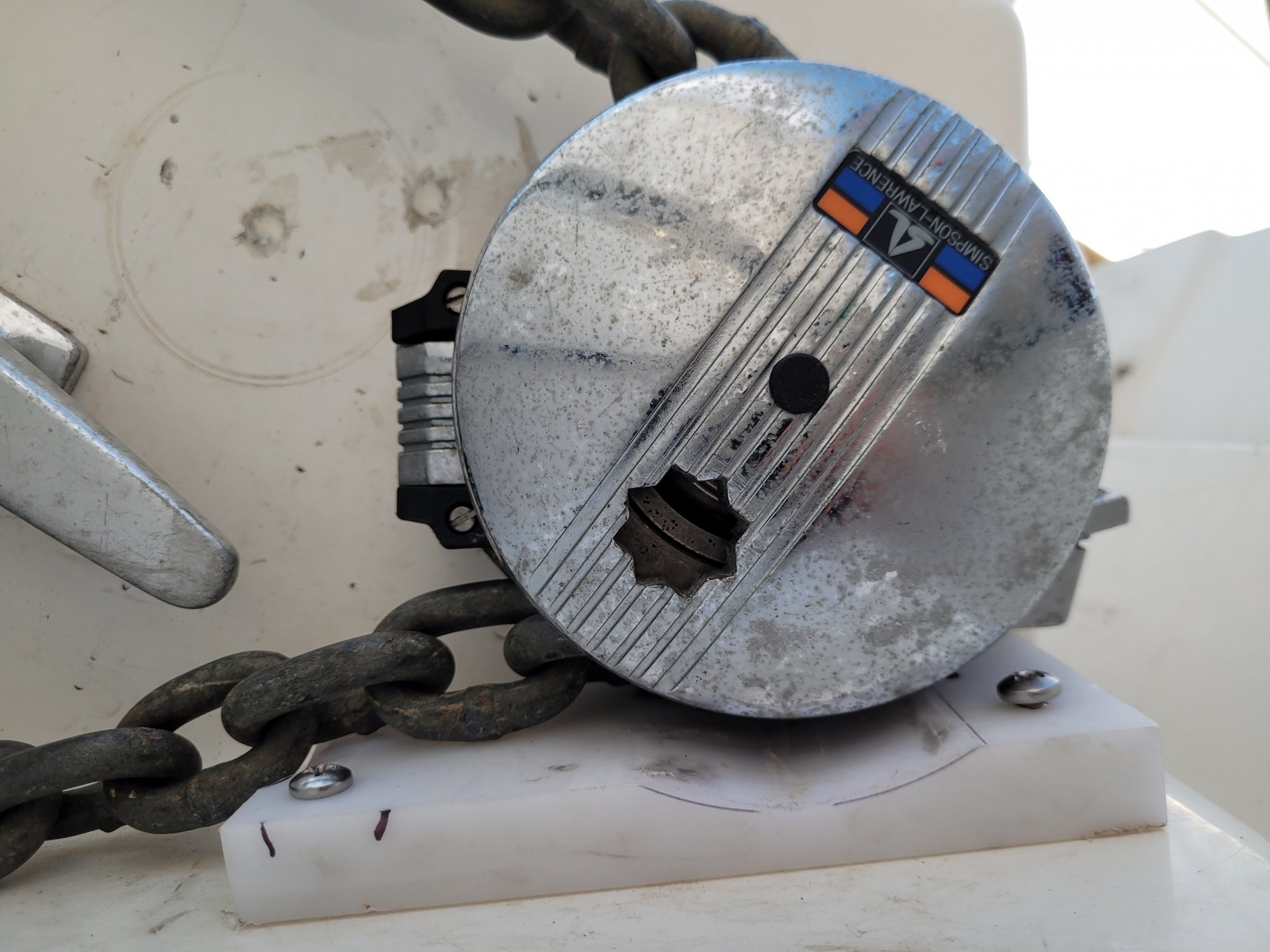

Hey all, has anyone else with a 40.5 had the chain jumping on the windlass? I have the correct size chain, however the lack of any amount of chain drop from the gypsy to the anchor locker when pulling up the anchor meant that there wasn't enough bite on the gypsy to keep the chain in. Letting out the anchor was always fine with no jumping.
Anyway looks like the previous owner tried to add some kind of extra gypsy or something - however my fix is simply a HDPE skid plate below to push the chain up onto the gypsy to give it more bite. I'd like to redo it in marelon in the future.
So far works at the dock. Remains to be seen out at anchor.
See pix
See pix
