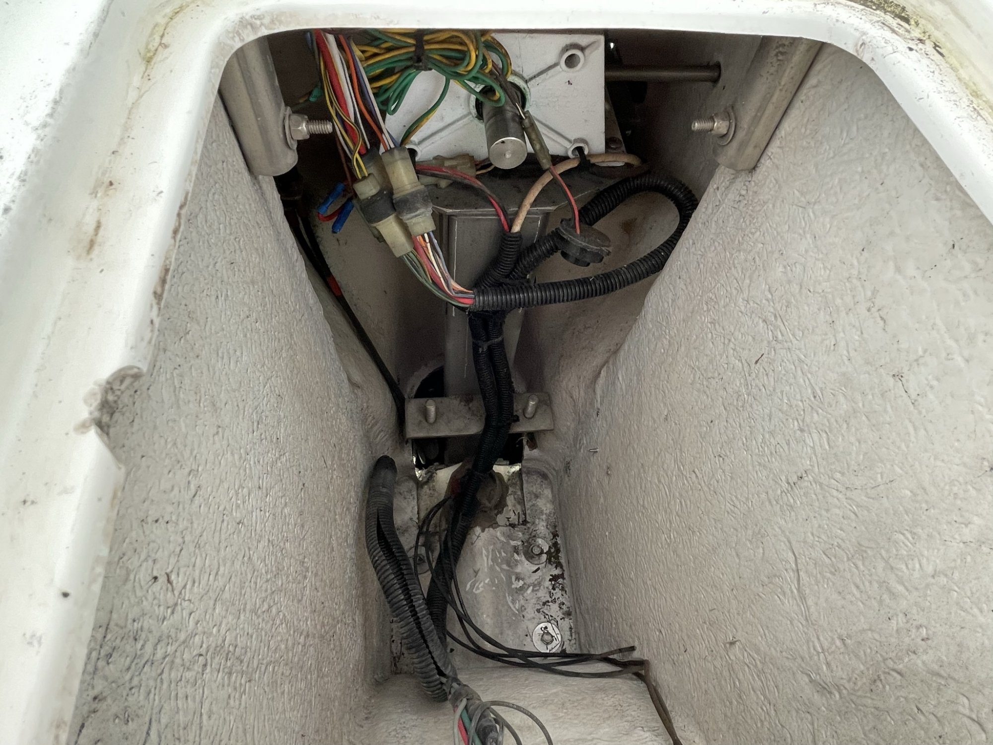

Hi fero,
Here is a picture inside my 40.5 pedestal before I installed the autopilot. The wires go through the deck at this point and are sealed with silicone. Behind this area are the steering sheaves that can be accessed by removing the rear deck that covers the steering quadrant and rudder feedback. Once I resealed this area I did not have any more leaks.
