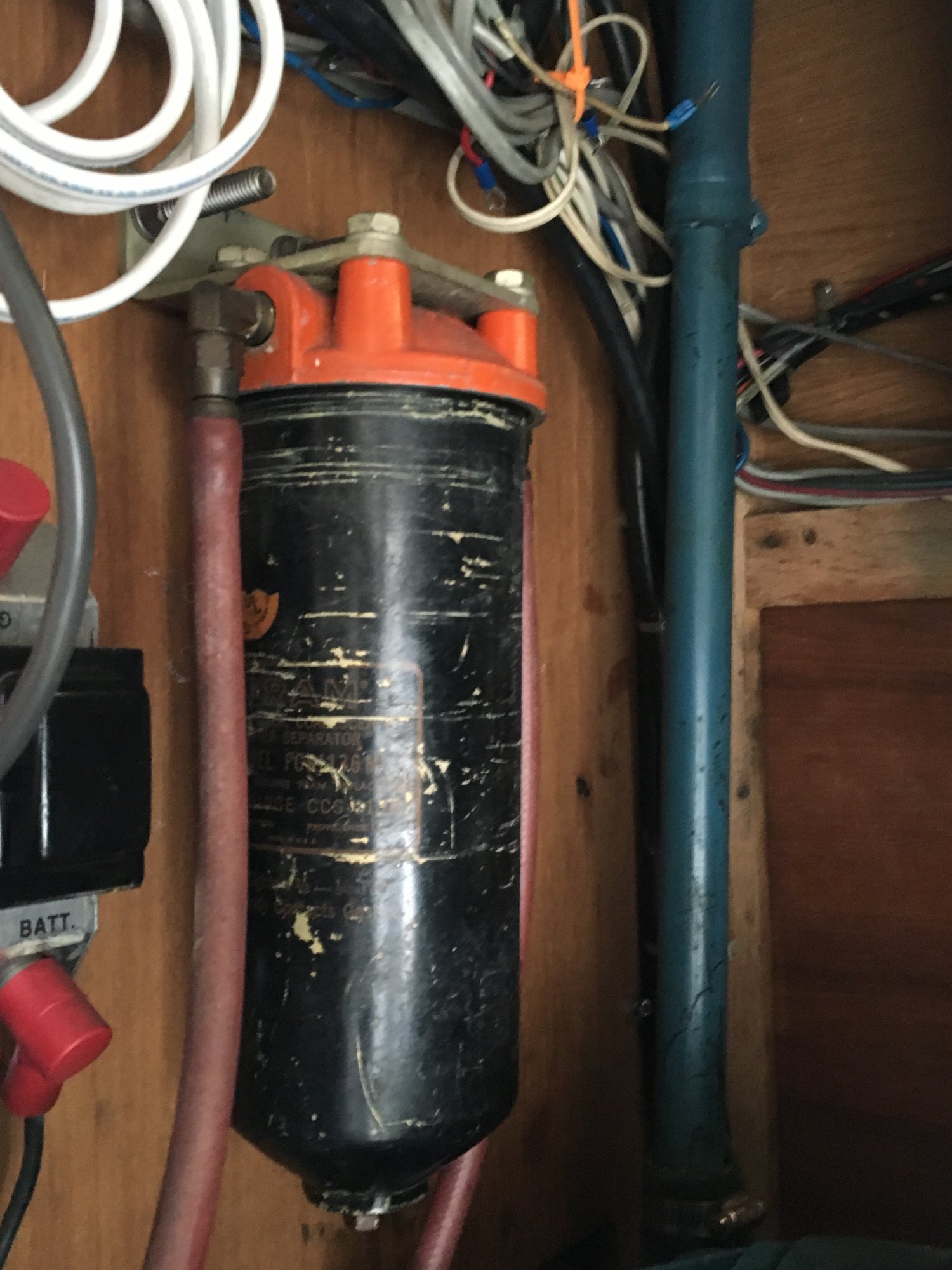

Here is the Secondary I had...

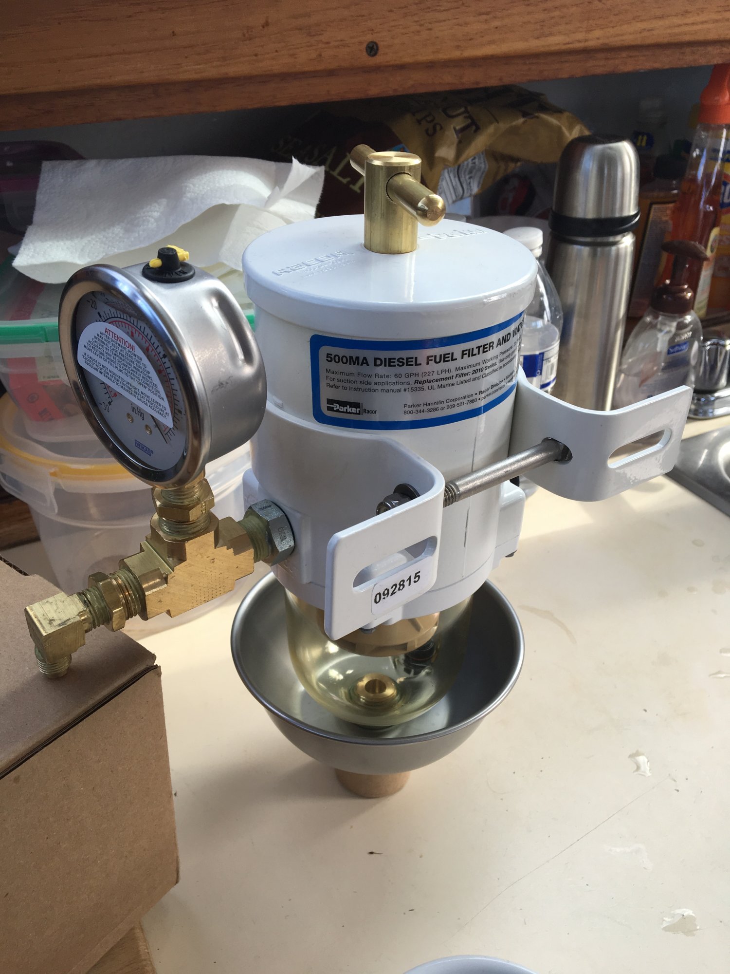

And the replacement I installed in the my engine compartment.
I inspect the Secondary before I start the engine. Log the hours and change the filter when the vacuum gauge indicates the engine fuel pump is pulling too hard to get fuel.

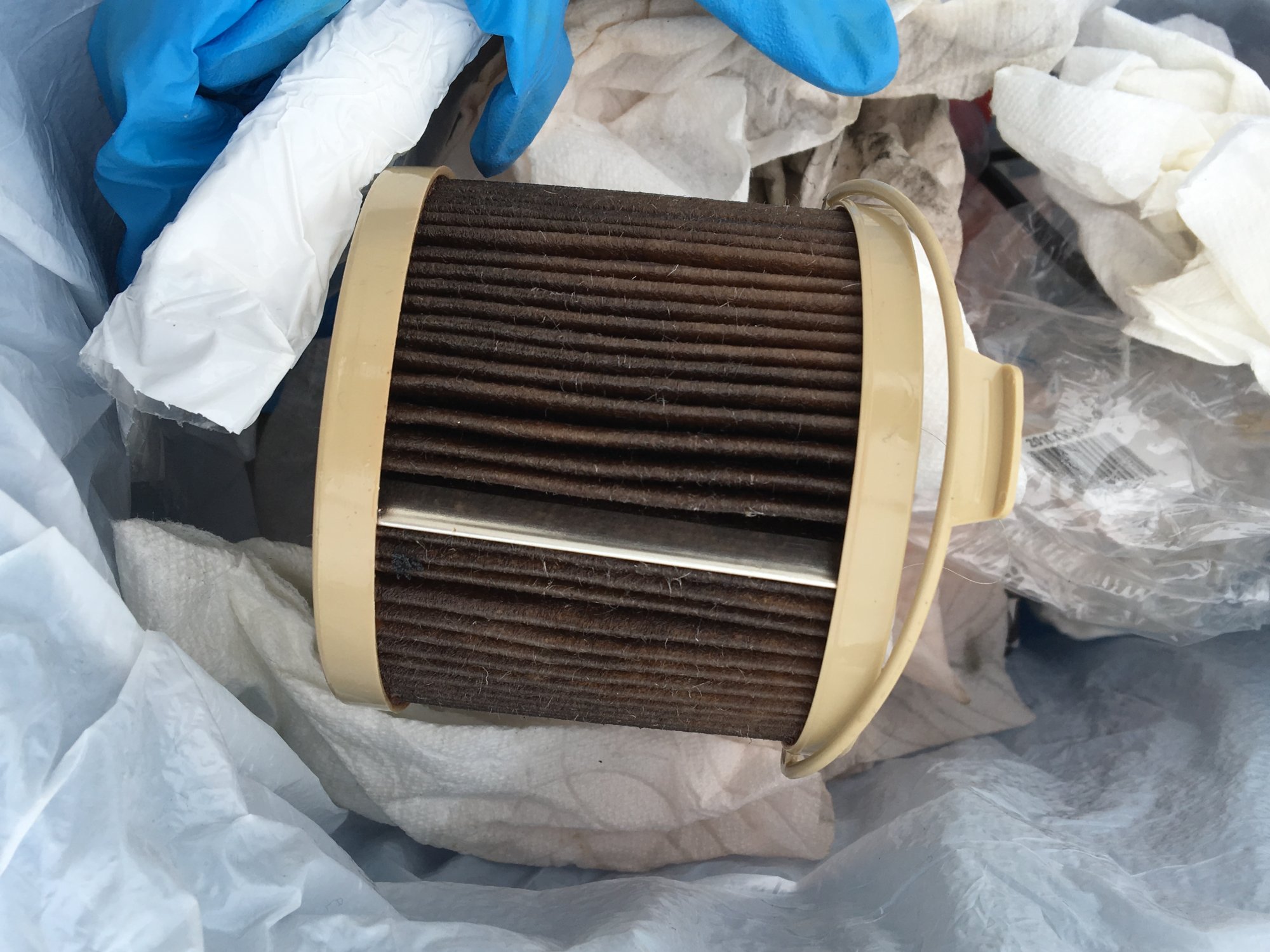

Or you can try the chemical destroy and filter method. That is what I employed. I used the recipe suggested in Practical Sailor magazine to add to the fuel. And I bought a bunch of 30 Micron filters for my Racor500 filter. I filled the tank and went cruising. As soon as signs of fuel starvation began to occur I stopped and changed the filter.
Here is what my clogged filter looked like.
I cleaned up my tank with the additives and now have fuel flowing with no problems.
