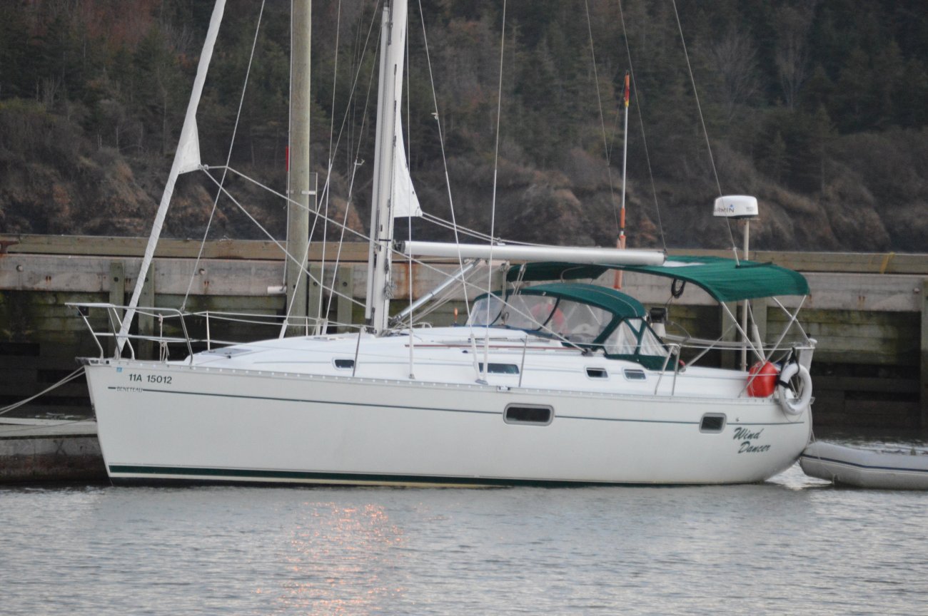

I had a similar problem the day after we purchased our Beneteau, except on the port side. We had filled both water tanks, unbeknown to us, the aft tank leaked, so water filled the aft end of the boat enough to heal us approx. 3-4 degrees, it stayed that way until the fall winterizing. The boat being aft low-in-the-water didn't allow the water to reach the bilge pump, until the boat was hauled on the trailer. I hope your problem is as simple! You can see in the picture how low we are.
