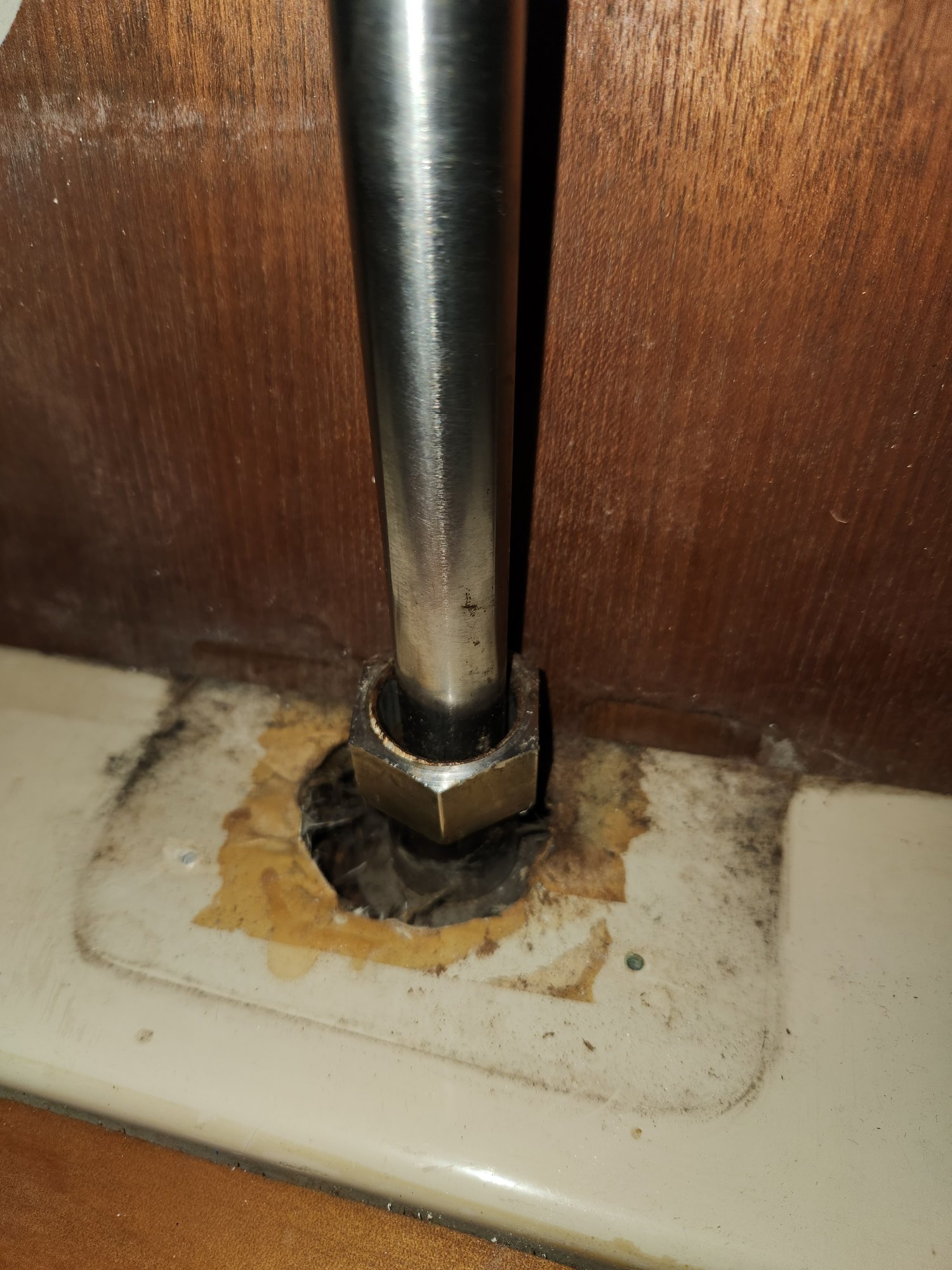

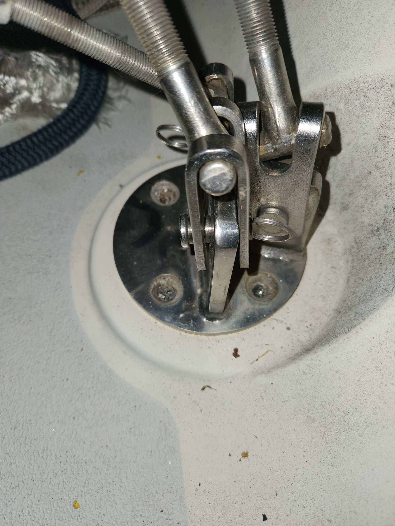

My surveyor said that I must remove and inspect my chainplates and his Idea was to unscrew the deckscrews and pull out the top plate. I unscrewed the screws and removed the sealent, however, the plate on the deck appears to be one piece with the rod beneath. I can't figure out how to remove the rod so as to reseal the plate back onto the deck. I tried turning both the top plate and the nut at the bottom of the rod - both feel like I'll break them if I applySurveyer who asked for this has bo clue. Can anyone help please?

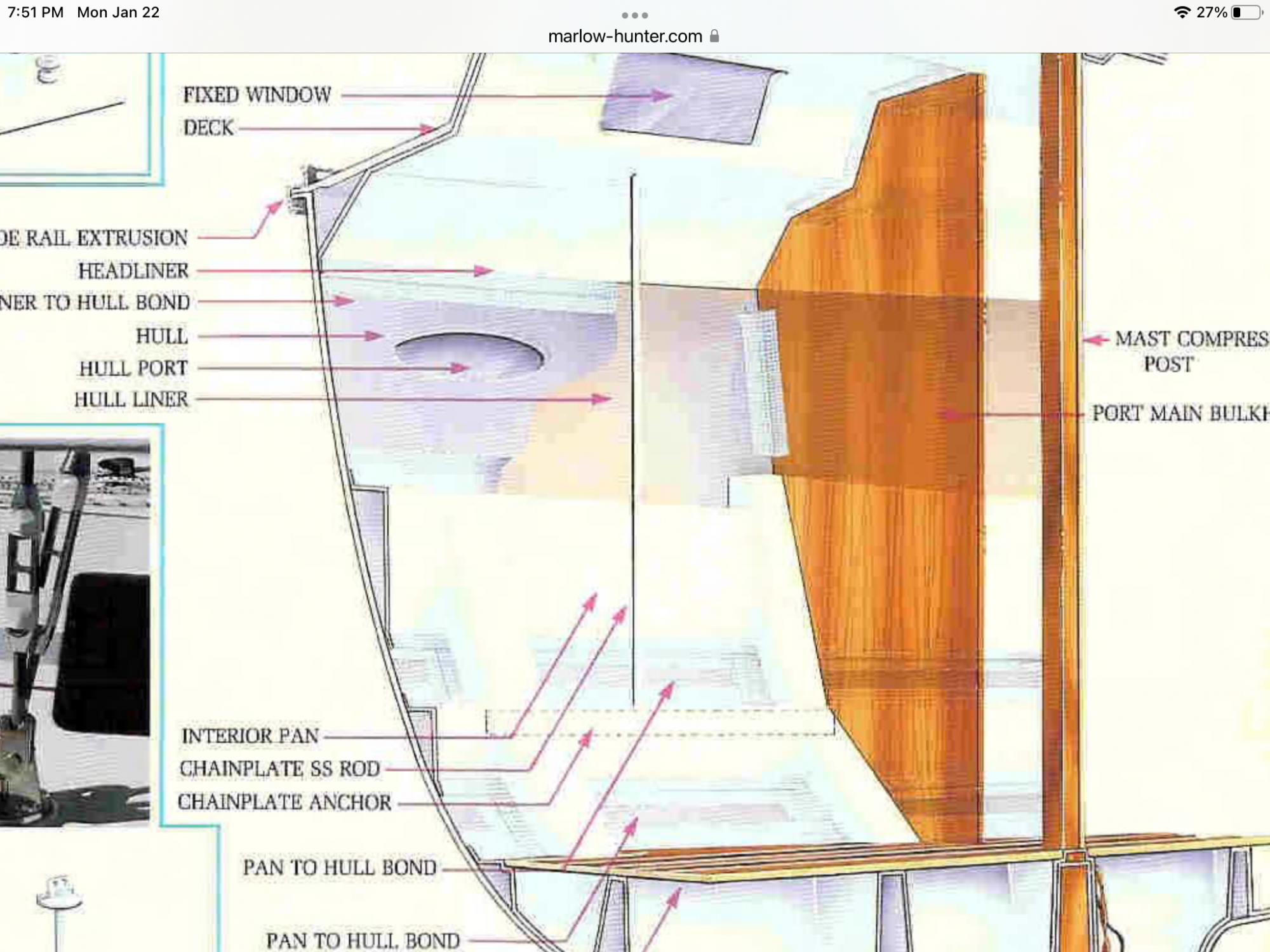

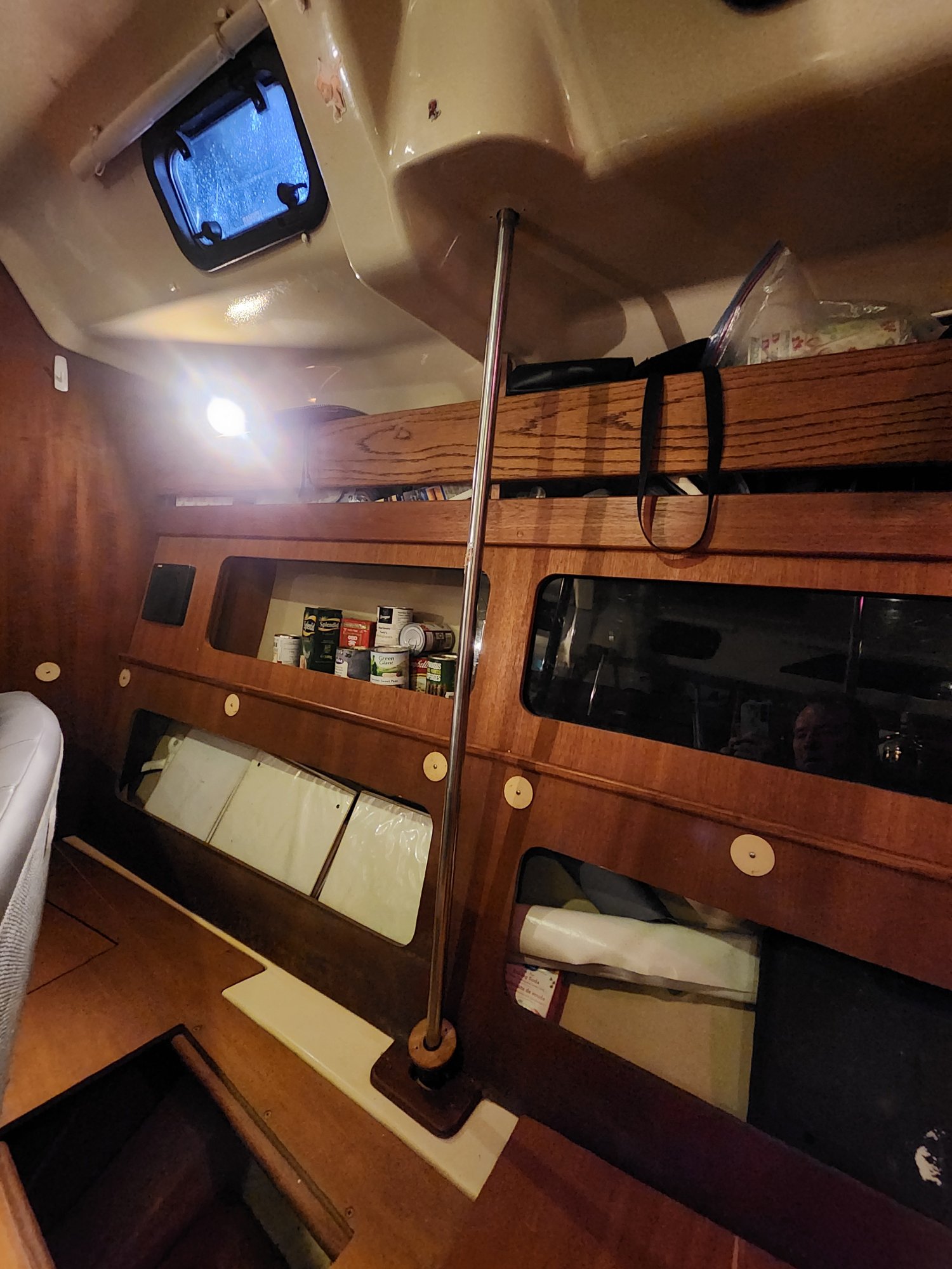

Sounds like your surveyor has no clue about a lot of things. There are no chainplates at the deck fitting. It is a pass-through to the long rod which connects to the plate in the hull stringer at the hull (Bottom photo in your post). Did you already pay this guy?

Disclaimer !!!! I know NOTHING about Hunters, but what "chainplates" is he referring to ? What I see is a tie rod that probably goes to a hull stringer. Technically that deck plate is acting as a chainplate would, I guess.
Who is he and why is he making strange demands of you anyway ? Tell him you "inspected" and they are "just dandy".

To be clear, there is no chainplates in the deck area. If nothing else, the ‘surveyor’ should have the common sense to know that area isn’t strong enough to carry such a load.

Yea, all sounds very extreme to be. On hunters there is a plate set in the deck that the top plate bolts onto. The rod going through can be quite stcuk on the plate making it hard to get out. I have never herd of a survey asking such things and as suggested above I would not pay him or move on. All that said I have had one break on my H49, and what's more on removal it was clear it had been 1/2 broken for some time. see halfway through Port Carmen, Palompon, Calangaman, Malapascua, Jilantangan | Screensaver (wordpress.com) So while I think his request was extreme, could be he has been bitten by an event like this.

Yes the increase was all the way. First I checked that the whole in the deck plate, that is set in the deck would take a bigger size, which it just did. Then in the picture you see this is like a huge upside down "u" section also made of stainless, and in my case extremely thick. My increased size rod did not quite fit, so I inifact had to drilled it our a couple of mill. This U section in my case goes around one of the major ribs/frame of the boat. It basically holds the lower end of the rod, which comes down from the round deck plate that is bolted to the outside of the deck, then through the deck plate that is set in the deck, down through the upside down U and a large nut and lock nut goes on the end, where you can tighten it up. Note to my suprise the shaft that comes down was NOT 316. As I recall it was 308, which I had not seen before. The explanation I was given was to reduce the fracture component of 316, it was by design. Because I could not source 308 in Philippines, I used 304 trying to follow at least the mindset intent of the original material. I replaced both even though the other side was not damaged as far as I could see. I have had 3 fairly Maijor failures all have been at the weld points, one of which was a bad design.
