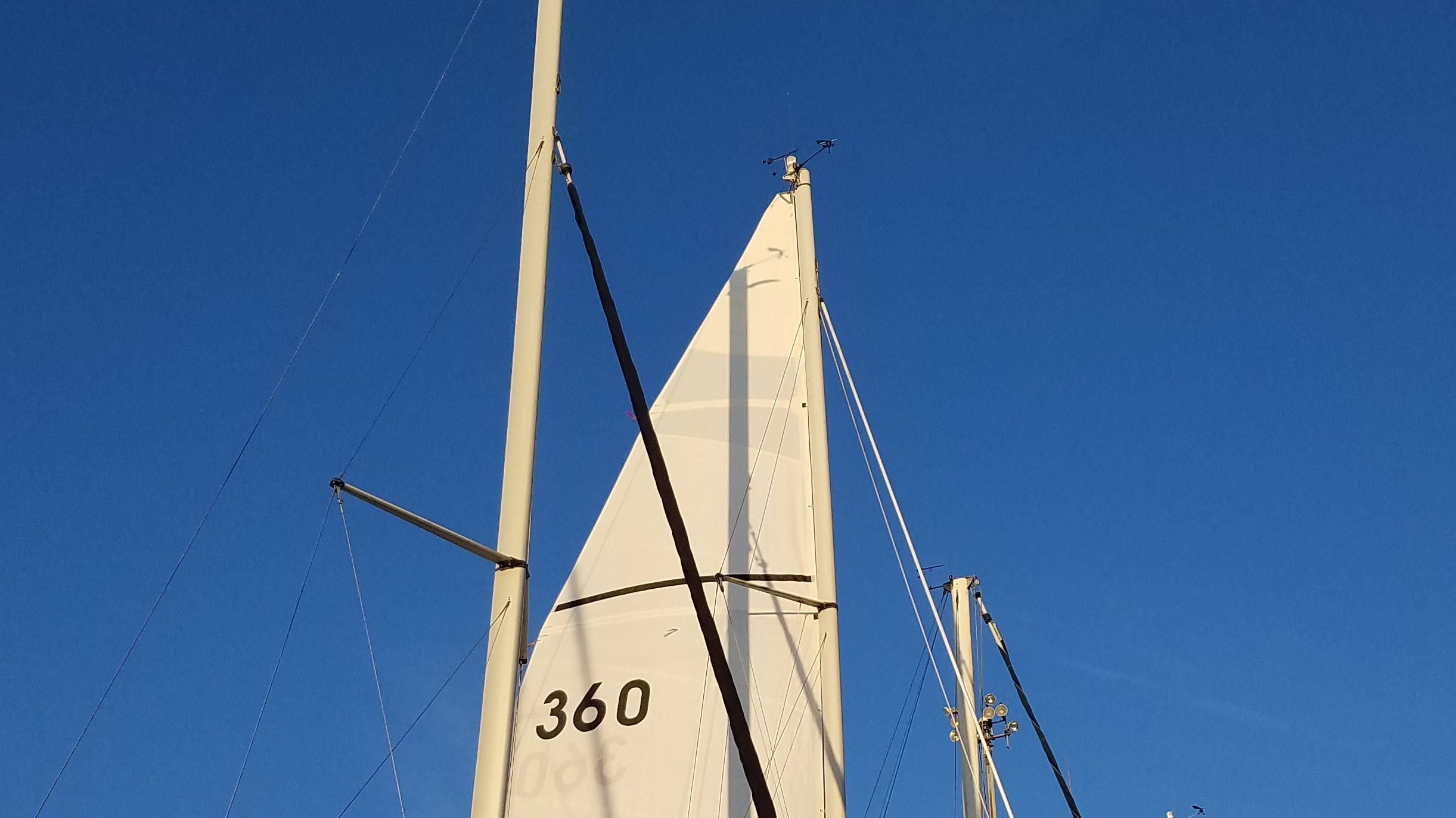

But he did come and remove the mainsail, recut it to get it the right height, bring it back to the boat, and help put it back on. It now seems to be the correct. You can see the new panel in the photo.
Nov 8, 2010
11,386
And I don't need to show this photo to the sailmaker, he took it.
Glad he got you sorted on your main. But wow, I would have thought that any sailmaker would have been embarrassed to see and show this picture. What's wrong with that sail is SO obvious. Dyneema leech line? That's ridiculous. Its the fabric BEHIND the line that is vibrating, because there is too much of it. Tightening the line will not help that.

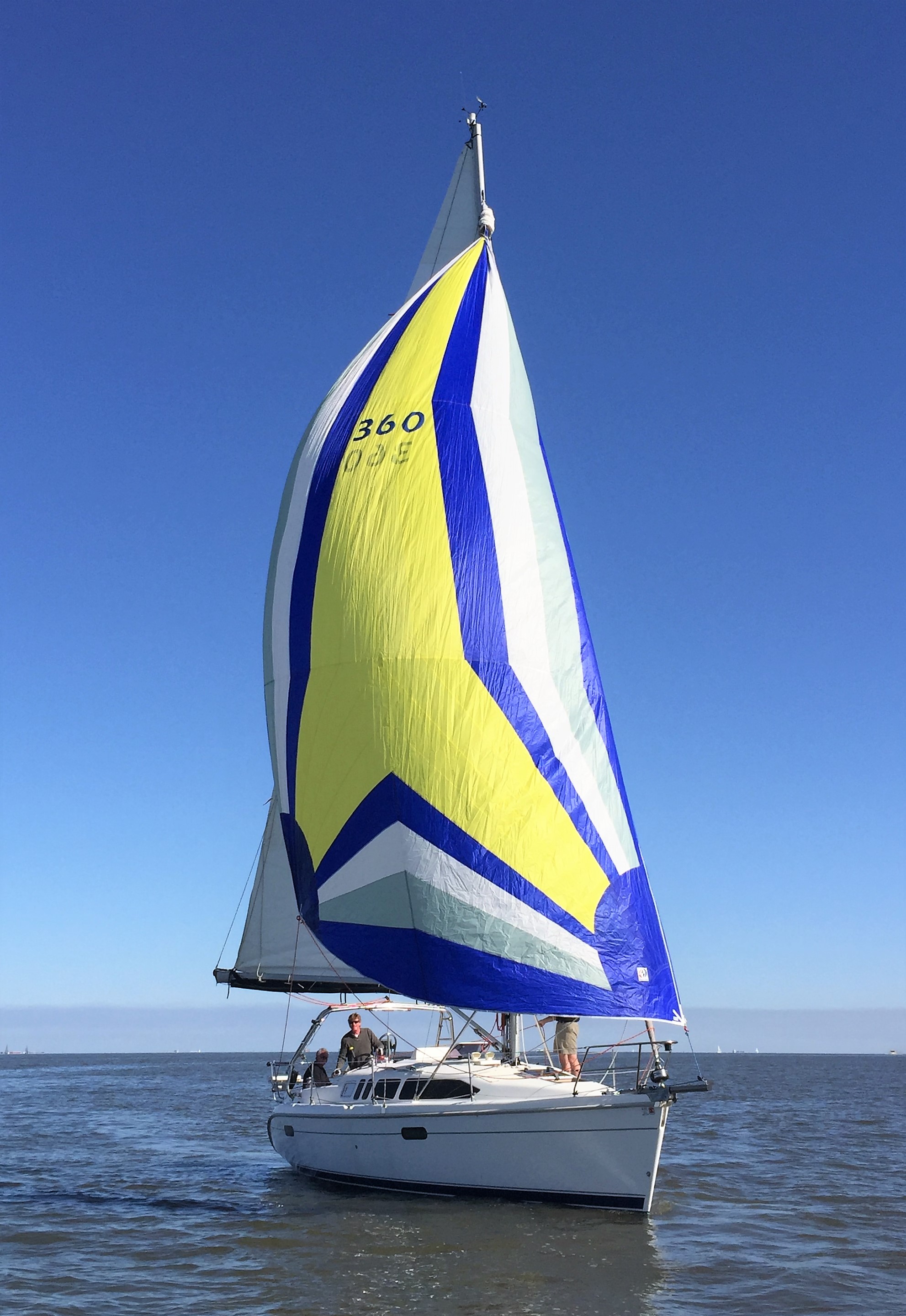

I now have another new sail with issues to work out. There's a few problems with our new code 3. But to be real about it, problems with new sails are not really "real life" problems and are a lot more fun to talk about than legal, marital, money, or health problems.
While out on the bay testing the new A-sail, I found the jib sailmaker had rigged the leech line so it can't be eased unless I cut it, so I'm stuck with the leech hook until I go another round with him about the leech flutter.
Most of the issues with the A-sail from a different loft, ended up being operator error. The sock from my old sail is too small and jams up, so I probably need to bite the bullet and buy the next size up. And the thread about whether a sock is necessary, I say yes, because you will use the sail with a sock way more and not use crew or conditions as an excuse not to fly it.
I'm unsure what to do about the sail cloth manufacturer substituting for a discontinued color cloth to the loft and they didn't catch it and made the sail anyway. It's still a beautiful sail, just the difference between blue and navy blue. But, if you ordered a new navy blue car from a dealership and went to pick it up and it was royal blue, what would you do?
A friendly power boater (is that an oxymoron?) took some photos and texted them to me from our test sail yesterday. In the very light winds, it set from 55 to 155 degrees apparent, but I need to see what it does in 12 to 15 knots.
