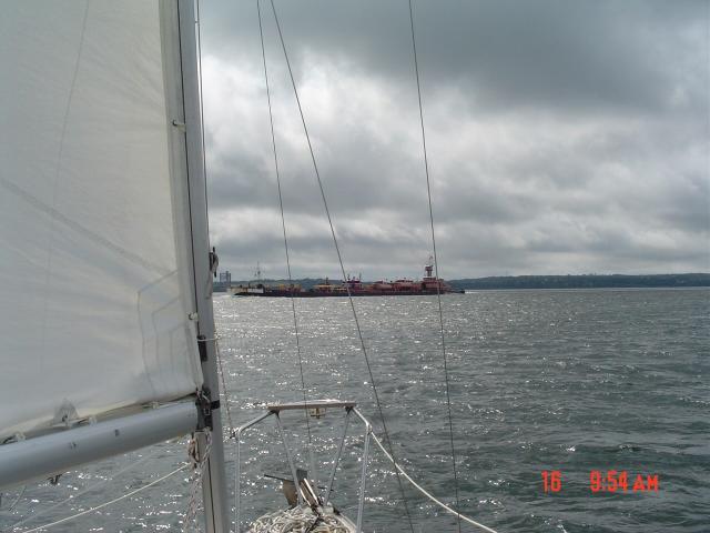

Speaking of Reefing. Does anyone have a picture of the main sail reefed on a 222? I'd like to know how it actually looks like. I am more of a visual rather than literal person in understanding procedures on a boat.

I only have one George.
