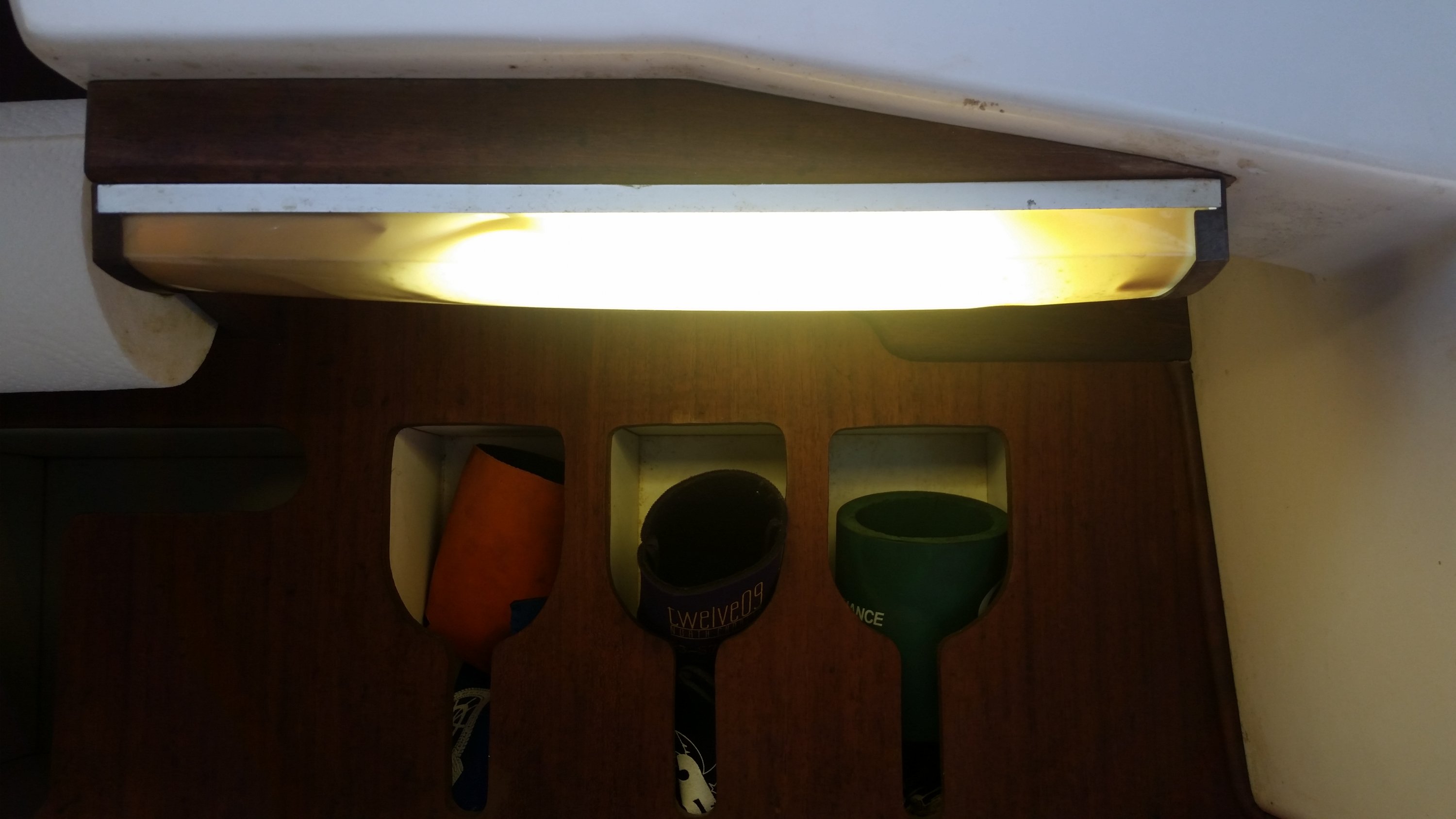

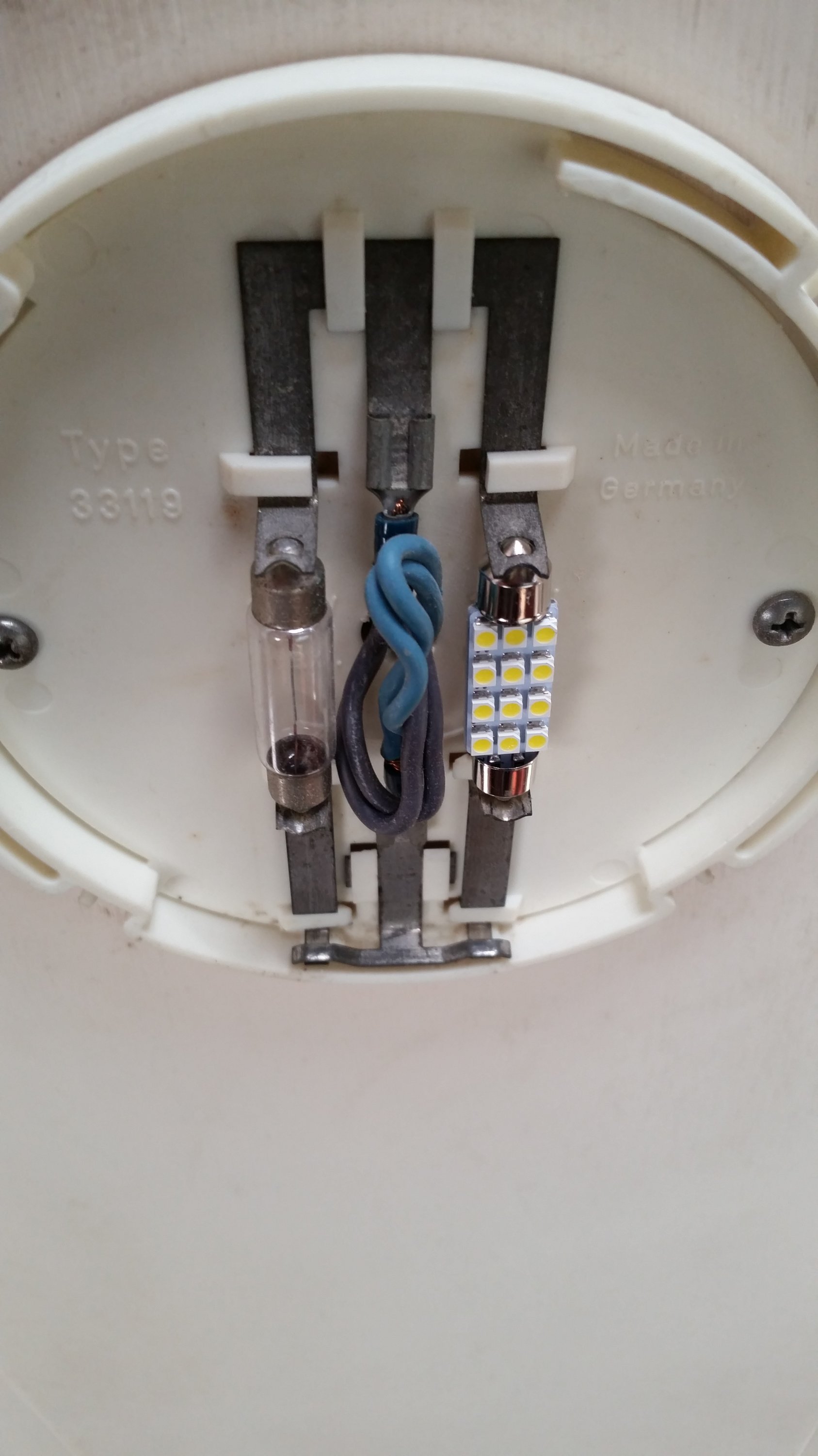

I have been doing this project over time. I have already replaced, the Cabin Dome Lights, and the reading lights over the last several months. This weekend I rebuilt the three fluorescent fixtures on my boat using COB LEDs from E-bay.
Dome Lights

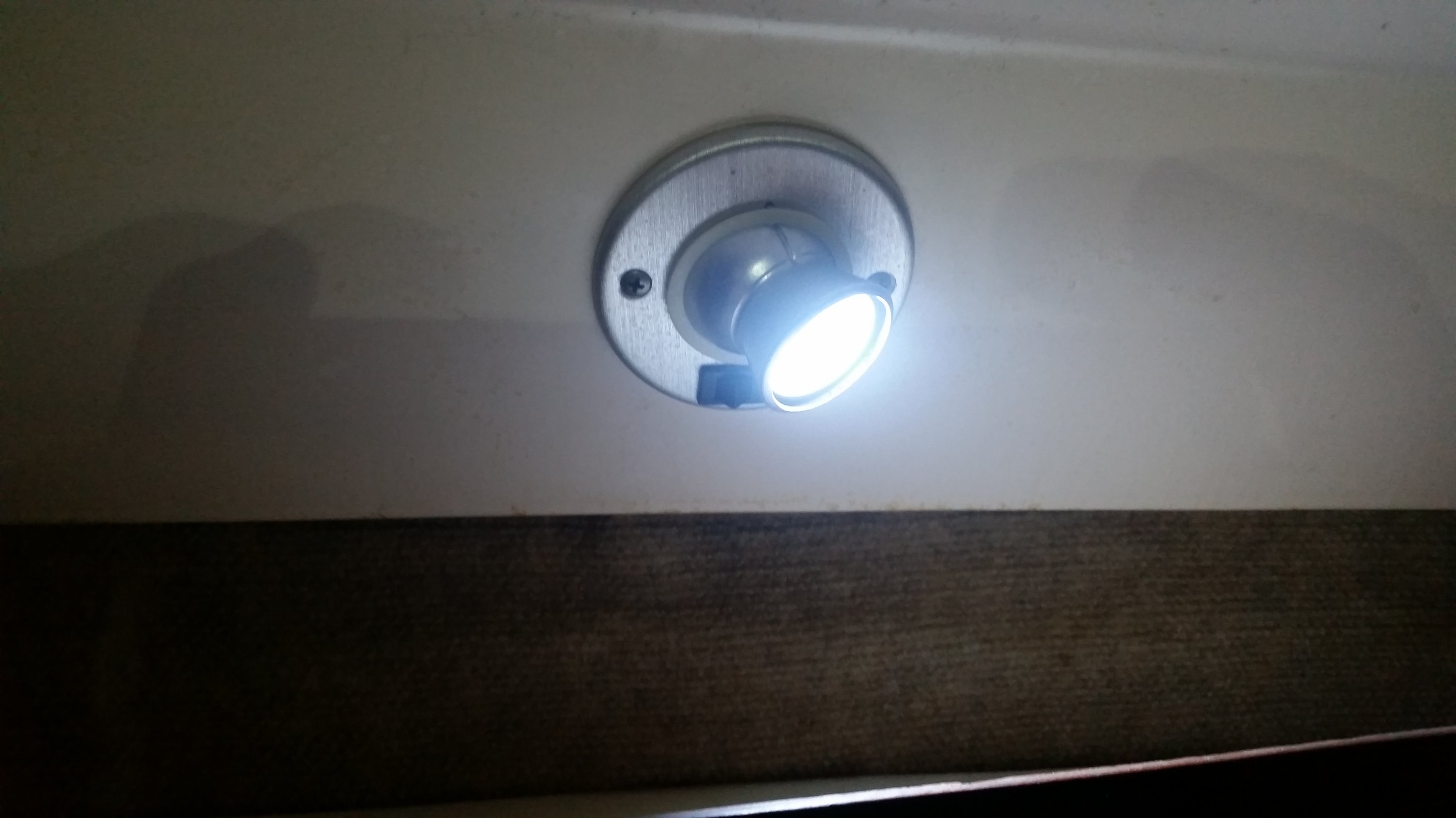

Reading lights

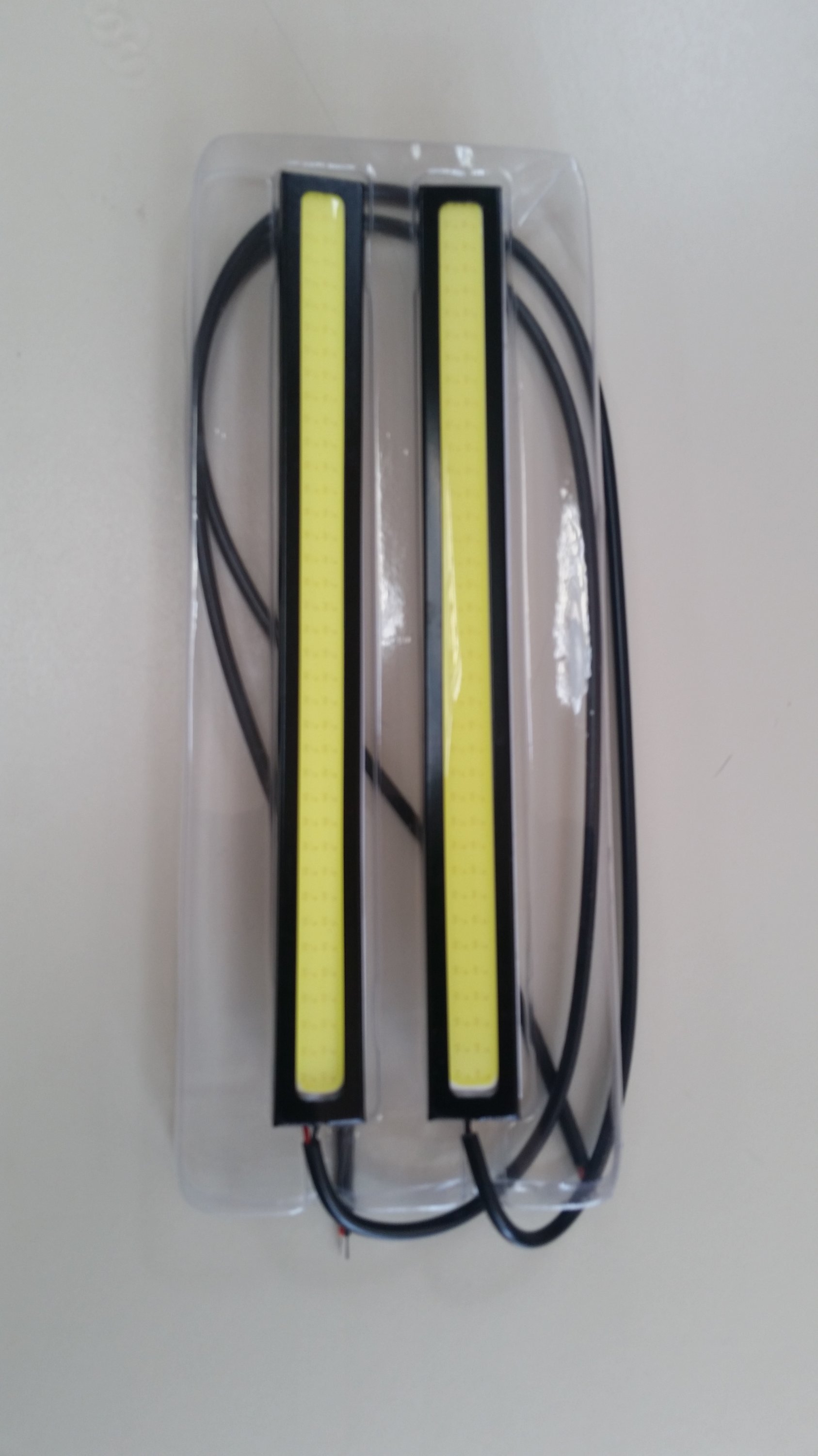

COB LEDs

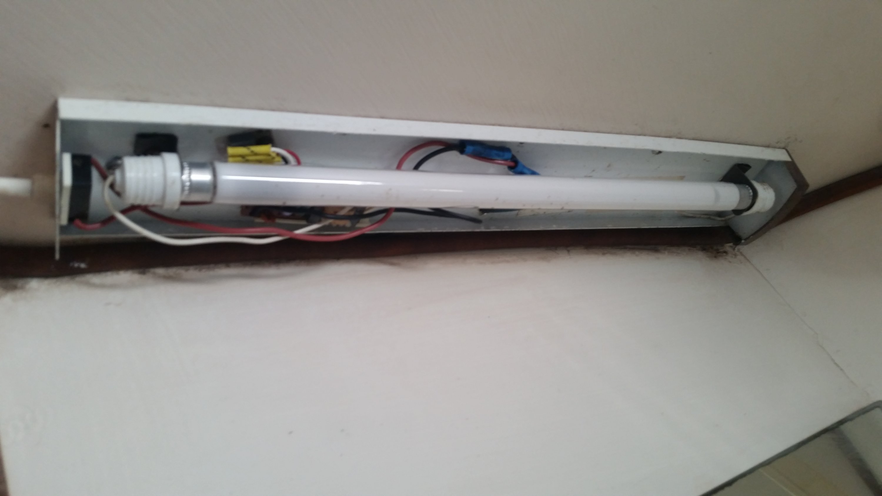

Old Fixture

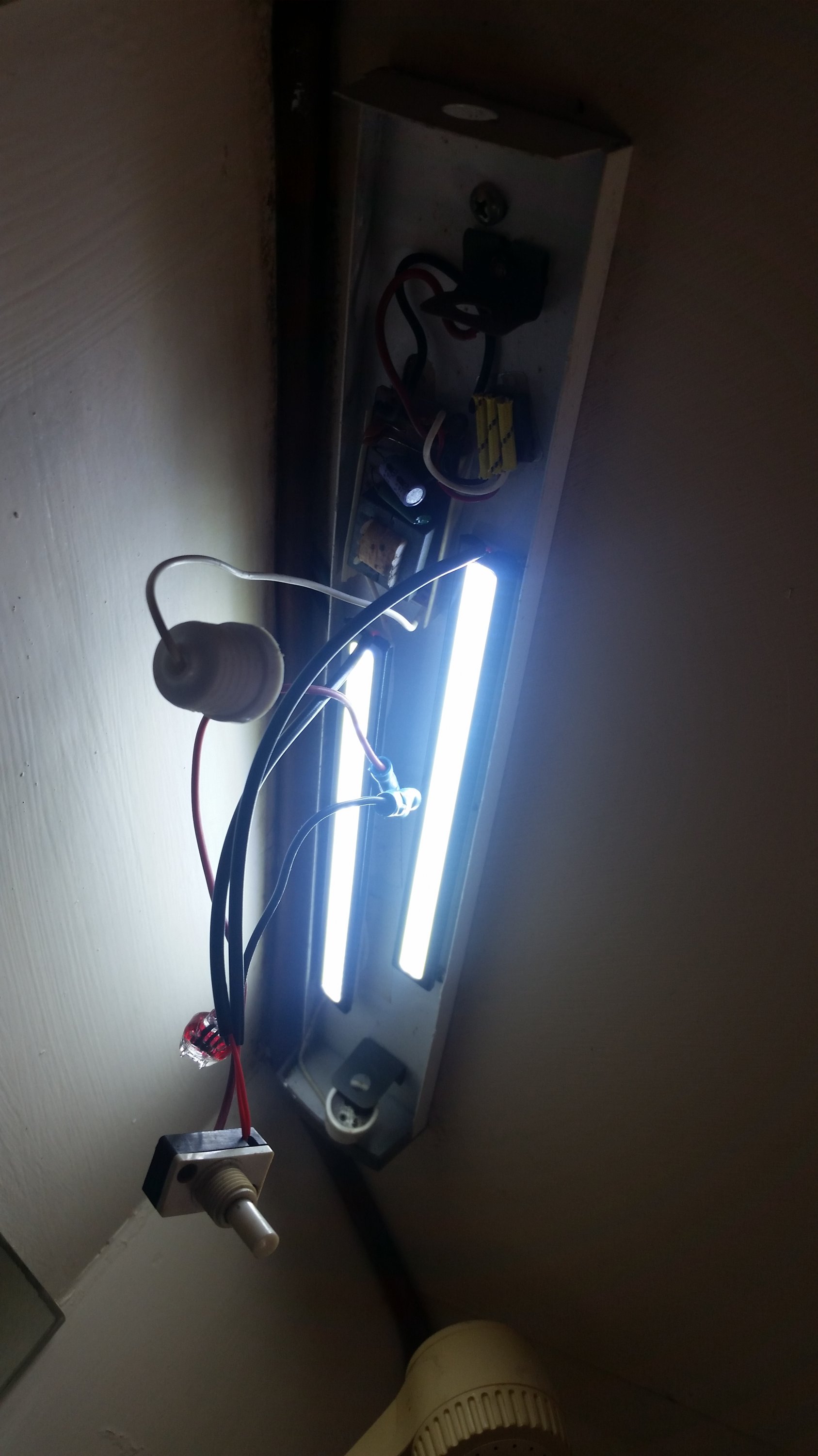

LEDs Installed
Finished LED Conversion.
So Far I am very pleased with the results.
