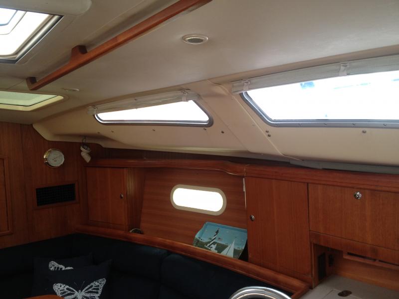

I have replaced my florescent lights with a DOUBLE row of LED strip lighting... the strip lights are slightly longer and of course have a much lower profile, but i kept the mounting width so that it would spred the light better... the leds are a lot brighter than the single tube florescents were with the lens on them... completely happy.

so for anyone who cares to easily make their own nice looking fixtures that they can use the self adhesive strip lights with, as I did, read on....
what i did to make the fixtures (2) that I used in my 34 for installing twin strip lights in place of the tube fixtures, I used a piece of 4' wide mahogany that I cut to length, then finished the edges with a router...
then I drilled 2 recessed screw holes and holes for the light wires, and finished it to a gloss with spar varnish...
the strip lights were self adhesive so they stick very well to the surface of the finished wood... and then mounted a switch in a location that is more conveniently located than on the light itself.
the third light...
under the sidedeck recess above the dinette, I used a 6ft strip light, but I wanted it a bit more subtle lighting from it (they are so bright!)
so I used a strip of mahogany, 1/2"thick x 1.5"wide x 6'2 long...
I drilled holes in it so i could mount the strip under the side deck area, on edge so it hangs down 1.5 inches, like a short valance....
after finishing it, I stuck the 6ft strip light to the back side of it, and mounted it up under the side deck.... and put the switch in a convenient location.
what I have now is recessed lighting over the dinette area...the light behind the small "valance" of wood reflects off the polished cabinetry behind it and makes plenty of light for reading, eating, visiting but its not direct or harsh from any angle.
before doing this, when the florescent light was on (at night) anyone setting across in the opposite settee looking towards the person setting in the dinette settee, had the light forever in their eyes while visiting.... this is much better.

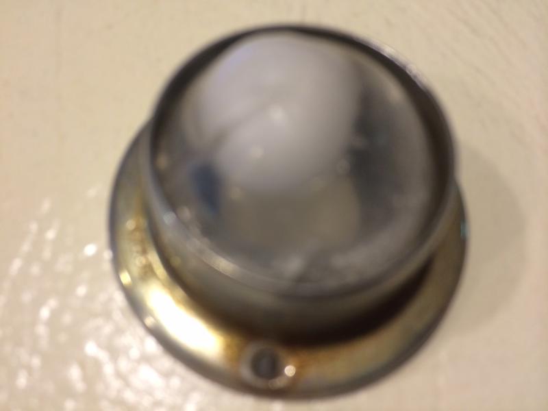

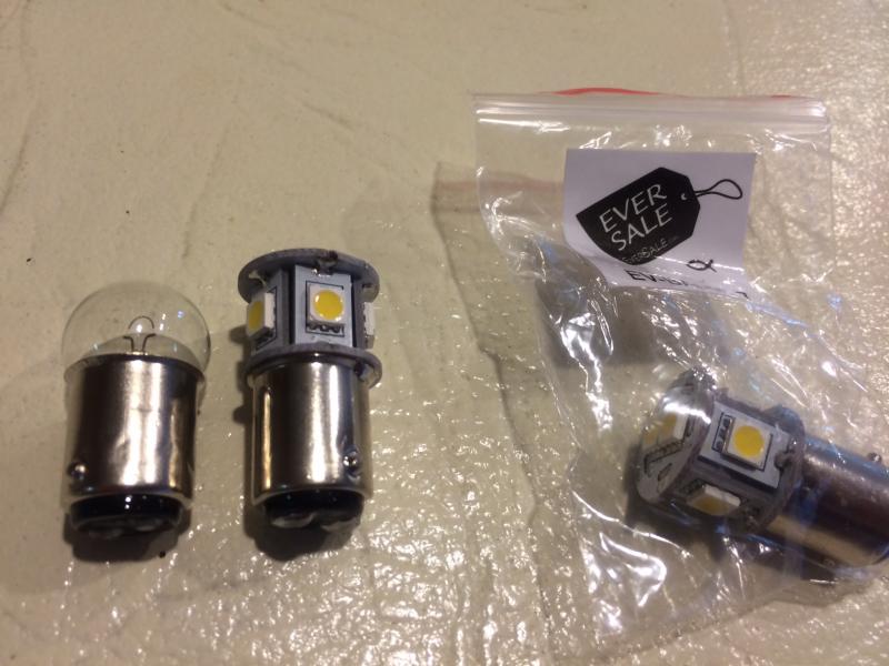

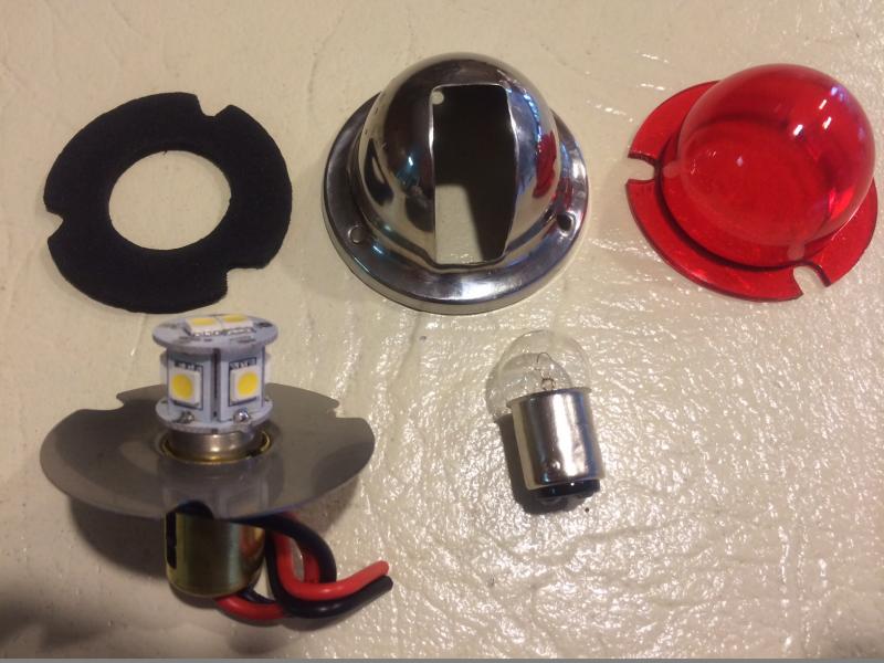

I plan to replace all of the lights in our Yankee Seahorse 24 with LED bulbs. I ordered new navigation lights to replace the melted plastic lens on the original lights. The replacements came with the standard incandescent bulbs, but I order LED bulbs to replace those. The reduction in DC current is substantial and the lights are bright. We have not installed them yet, but we have tested them.
I have attached photos that show the old navigation lights verses new replacement lights. There are two big benefits to converting to LED Bulbs.
One, the life of the LED bulbs are tens of thousands of hours, meaning I don't have to take the Mast down to replace a bulb every year. Secondly, my battery can run all of the LED lights on the boat for weeks without having to recharge it. Third, the LED bulbs run much cooler and do not melt the plastic lens. We also ordered LED replacement bulbs for the interior cabin lights so can keep the original fixtures. The interior bulbs are larger than the navigation bulbs shown in the photo.

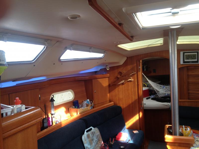

Conversion to LED strip lighting
This last week, I replace all of my fluorescent lights to led strip lights 12v. Kept the fixtures and inserted the strip and hooked up to the switch. Almost better than sliced bread...

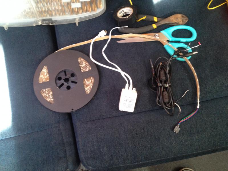

Received in the mail today:
SUPERNIGHT (TM) 16.4ft 5M Waterproof Flexible 300leds Color Changing RGB SMD5050 LED Light Strip Kit RGB 5M +24Key Remote+12V Power Supply
http://www.amazon.com/dp/B00ASHP1CM
I plan to place these up on the shelf in the main saloon area to provide lighting in the main cabin, mostly red for night time sailing. Saw this on fellow sailors boat and Admiral said get them installed.... so I am...

After replacing the fluorescent lights with LED strips. I went just little over the edge...
I purchased off Amazon. LED RGB dimmable remote controlled strip lights. I installed them along the saloon shelf. Was able to get 12v power from the reading lights. Biggest thing is the only use 1A each on full light, didn't check what happens as you dim them down.
Plan to use the RED for night sailing. This is going to be fun.. Disco on Java...

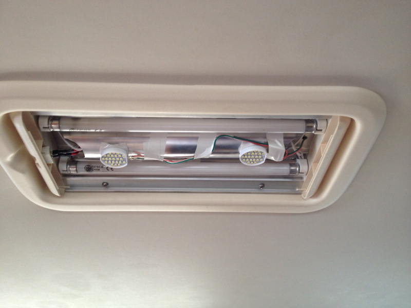

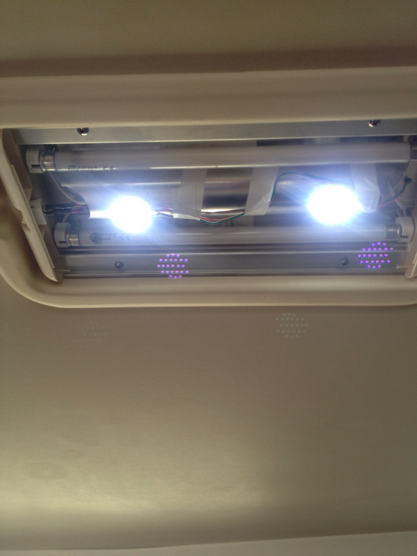

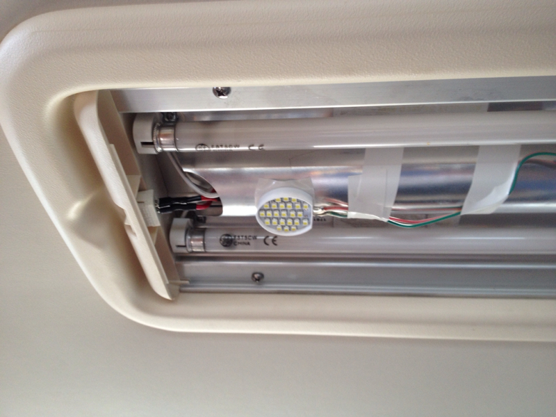

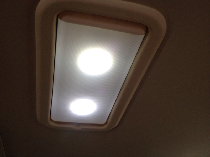

My lights are connected to the switch so you can either have the LED lights on or the flu-row lights
