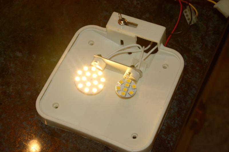

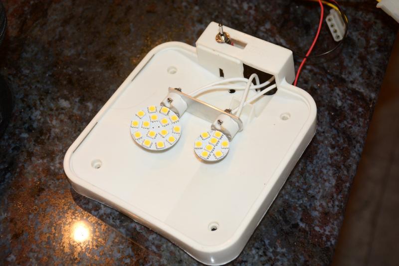

I have been wanting to upgrade to all LED lights in my 25 but still maintain the look of the old 6-inch square lights. They are funky, but I like them.
What I did was gut the old fixtures out, which were getting corroded anyway- all the slide switches were frozen and the bases were OLD....

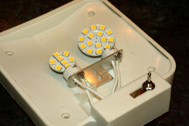

Got some 1/2 x 3/4 aluminium angle from the hardware store, cut it 2.5" long, and trimmed the angle on the bottom to about 3/4" where it would pop rivet to the plastic shell. Not doing so would keep the base plate off the plastic.

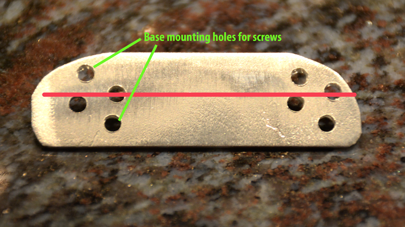

Drilled 1/8th " mounting holes and wire pass-throughs in the vertical plate -- (those all had to be a a slight angle to make the LED parallel to the base - don't know why they made the base socket that way....SEE PHOTO) and another in the base for the pop rivet to the shell.
Ordered a 2.5 watt and 1.5 watt LED for $11 total , got a SPDT switch from an electronics house (Radio Shack has them too) .
Used one SS #4 machine screw (fits the socket base holes) to fasten it to the angle, and test wired it to an old computer power supply (the CD burner MOLEX plugs are 12 volts on one end , 5 on the other : +12-grnd-grnd-+5) and there I have low and high beams , for about $13.00.
Am making 6, two for the V-berth, 2 for the salon, one for the Galley area with one spare for wherever I want it!
