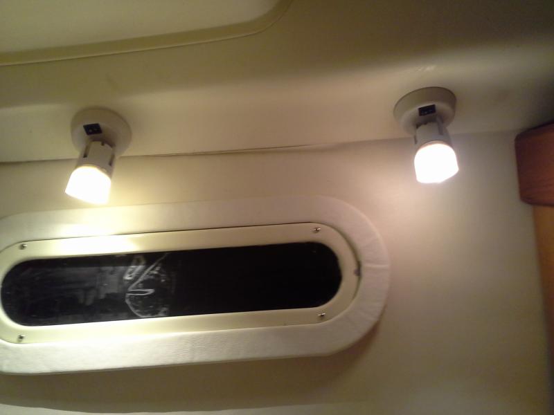

I'm also going to post a couple photos in the photo forum of the LED side-by-side with a Halogen. The LED is actually brighter...

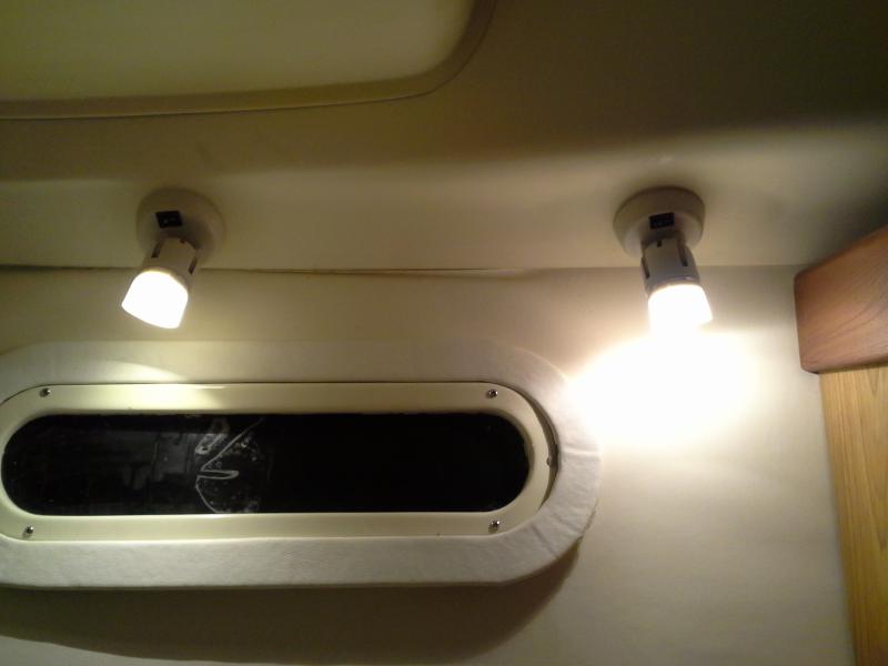

Wow, It's been a while since I posted photos! I'd forgotten that it can be done in-line with posts now... #FeelingOld
The photos were taken with a phone, so they're not great quality... but should give some idea of how they look.
First photo is the LED (left) compared to the Halogen bulb (right).
Second is the LED without the diffuser (Left), and with the diffuser installed (Right).
