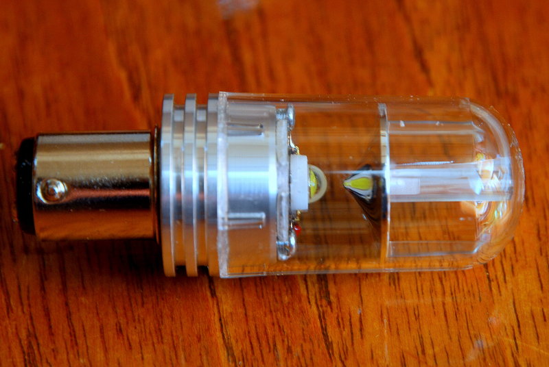

I recently discovered that Dr. LED changed the design so I bought one and the new one looks like this and now only has one LED.
New Style Polar Star 40:
Dr. LED is currently the only company to have any of its aftermarket LED bulbs certified for use in another manufacturers fixture. Unfortunately this USCG certification is limited to the Polar Star 40 but only when used in an Aqua Signal Series 40 all round/anchor light fixture.

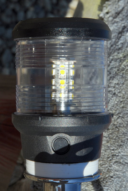

This is an Aqua Signal Series 40 "all round":
On our boat we have two anchor lights, one at the mast head and one on the stern mounted radar pole. Both lights are Aqua Signal Series 40. The reason for two was simply because incandescent bulbs tended to die a fast life at the top of a spar so having one lower, and easier to change when solo, was a no brainer.

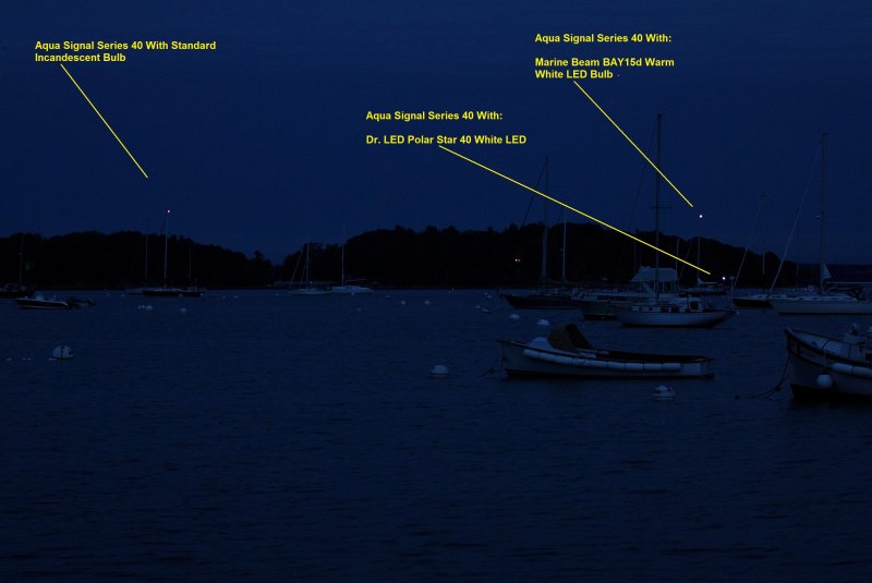

So here are the results taken live with the camera mounted on a tripod from approximately 1/2 mile away. The Marine Beam and Dr. LED are nearly identical in color and brightness. I really did not like my previous Polar Star 40 and instead was choosing to use my Marine Beam because of the color. I will now be using the Dr. LED because it is supposedly certified.
I say supposedly because the certification process is for the bulb and fixture submitted. I don't know if Dr. LED chose to re-submit the new & re-designed Polar Star 40 or if they are simply riding on the fact that it is still called the Polar Star 40 and the "Polar Star 40", in name, has a USCG certification. Either way I feel more comfortable using a bulb that is at least quasi certified.
Dr. LED has been quite misleading in the past about certifications and I really do still have a bad taste in my mouth over their misleading marketing tactics. That being said the new style Polar Star 40 is a very, very nice bulb.
Live Shot:
As you can see both the Marine Beam & Dr. LED bulbs show up brighter than the incandescent does and are darn close in color representation.
