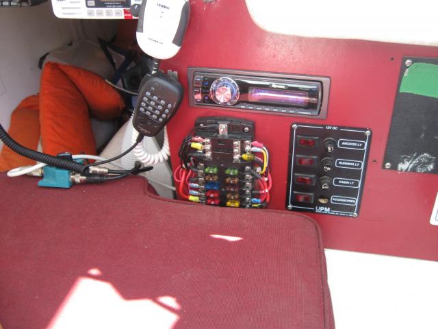

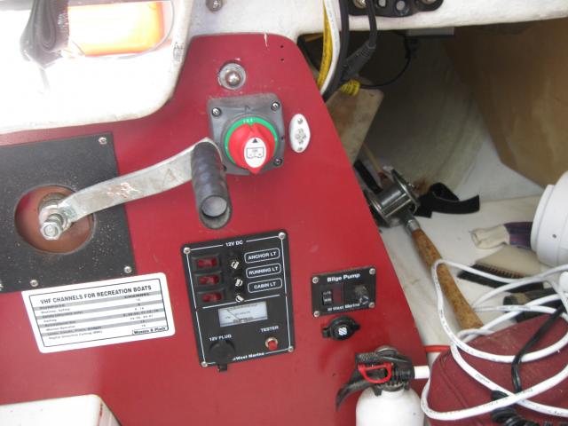

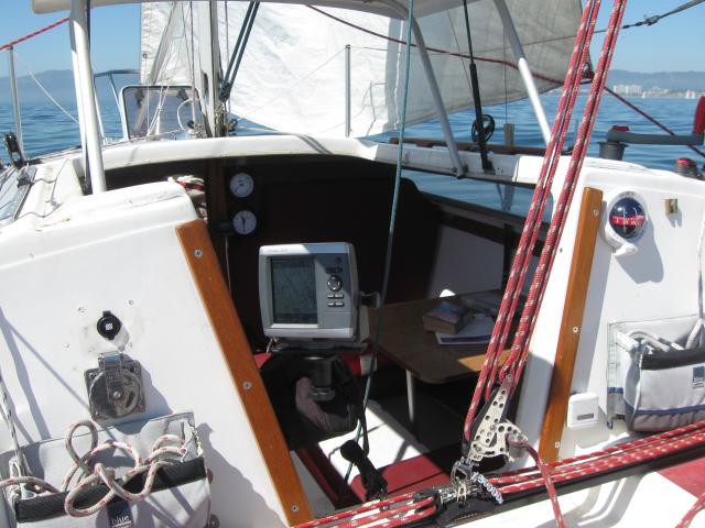

Tried to do an owners modification article with the pics, but it vanished. Here are some of mine. Originally had the fuseblock behind the bulkhead, but it was no fun looking for a blown fuse at anchor one night. VHF and 2m radios, on the same antenna with a switch. Ran new marine wire to everything instead of the oem lamp cord, still wiring cabin lights. 2 batteries on either side of the keel well, added an alternator to the 6hp Tohatsu. Used a Ram arm to mount the chartplotter, I know a guy who does good work on cushions if you are interested, Robin.

Timo, WOW! that's very nice, well sorted. Can I hire you to do my electricals (jk)? I can't believe that the brown lamp cord is OEM. I thought the last person that owned the boat put that in.
I have my winter project cut out for me.
