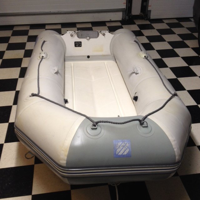

Here is a shot of my Zodiac310 PVC dink as she lays ready for season 12 Reports of her early demise are greatly exaggerated :D

TSBB2 Your right, this has been covered before and it seems that you still havn't realized that ol' bull about PVC boats is STILL NOT TRUE! Chief
Tell that to my dock neighbor- his came apart in three years. And another friend who had the floor come loose from the tubes in 4 years.
They are really good boats- for the price. Just don't expect the life span from them that a Hypalon dink will give.

Yeah, Gunny and I's PVC dingys are probably just exceptions to that longevity stuff. The other 6 I have had were probably just exceptional dingys too. Chief
You think perhaps the sun and heat here on the south Texas coast had something to do with it? You're up the California coast above San Francisco and he's in Annapolis, Md..
